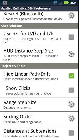

So the 4500AB won't Bluetooth to a phone running AB
It will interface with the Kestrel because there is an interface. Just saying that any LRF won't interface with any ballistic software. You have to do your homework. FFS only has interfaces for Vectronix Vector and PLRF, Laser Technologies TruPulse, and Newcon. If you go spend $5K on some new whiz bang LRF, it won't work with FFS until the developer writes an interface.
Just because two devices have Bluetooth doesn't mean they can talk to each other. A PLRF-25C can output it's data via BT, but unless the BT-enabled AB software has an interface written to receive and manipulate the data, they won't work together. Just like two people can talk, but if one is talking in Chinese and the other in English, they're talking but they're not communicating.
