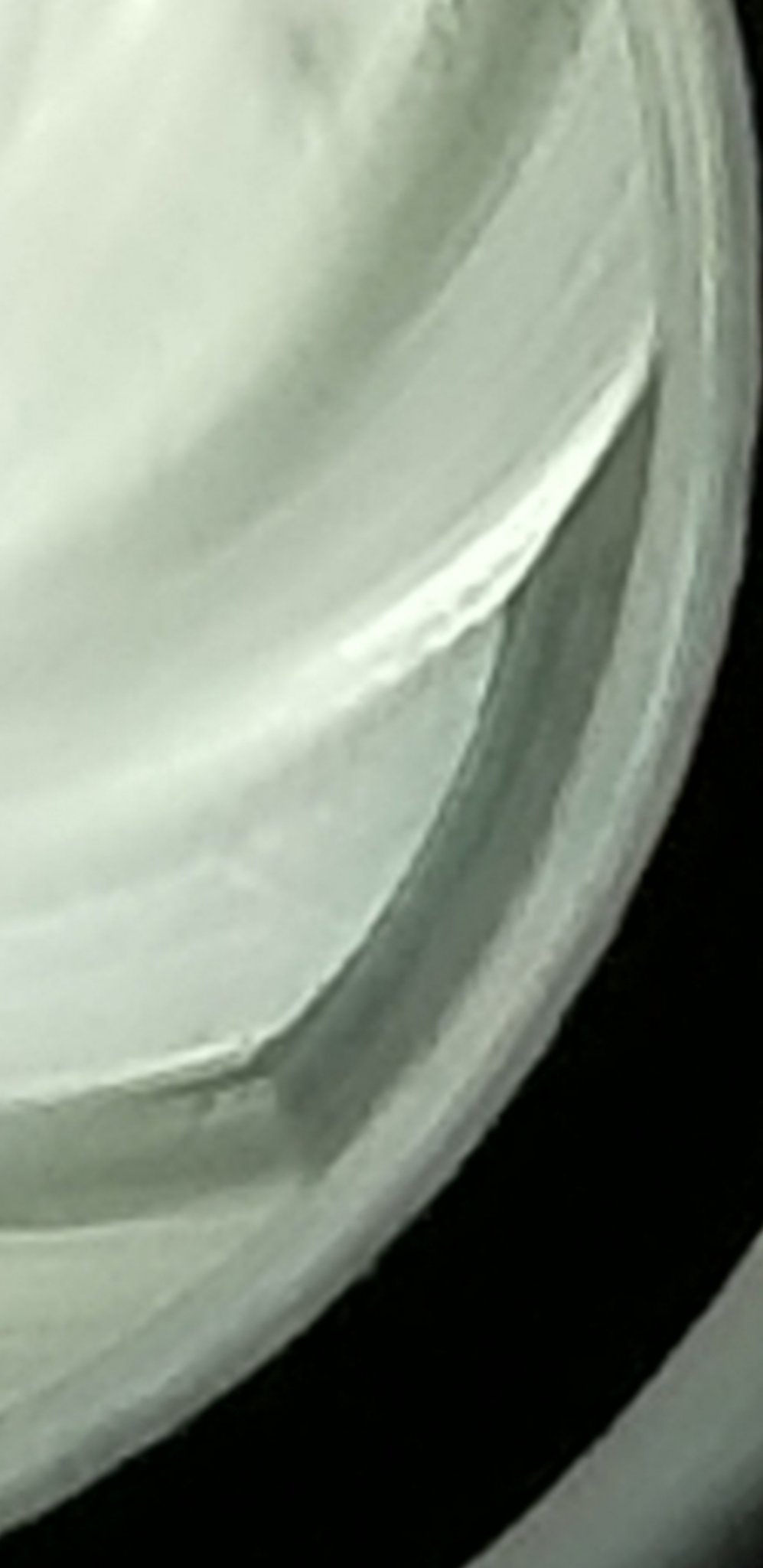

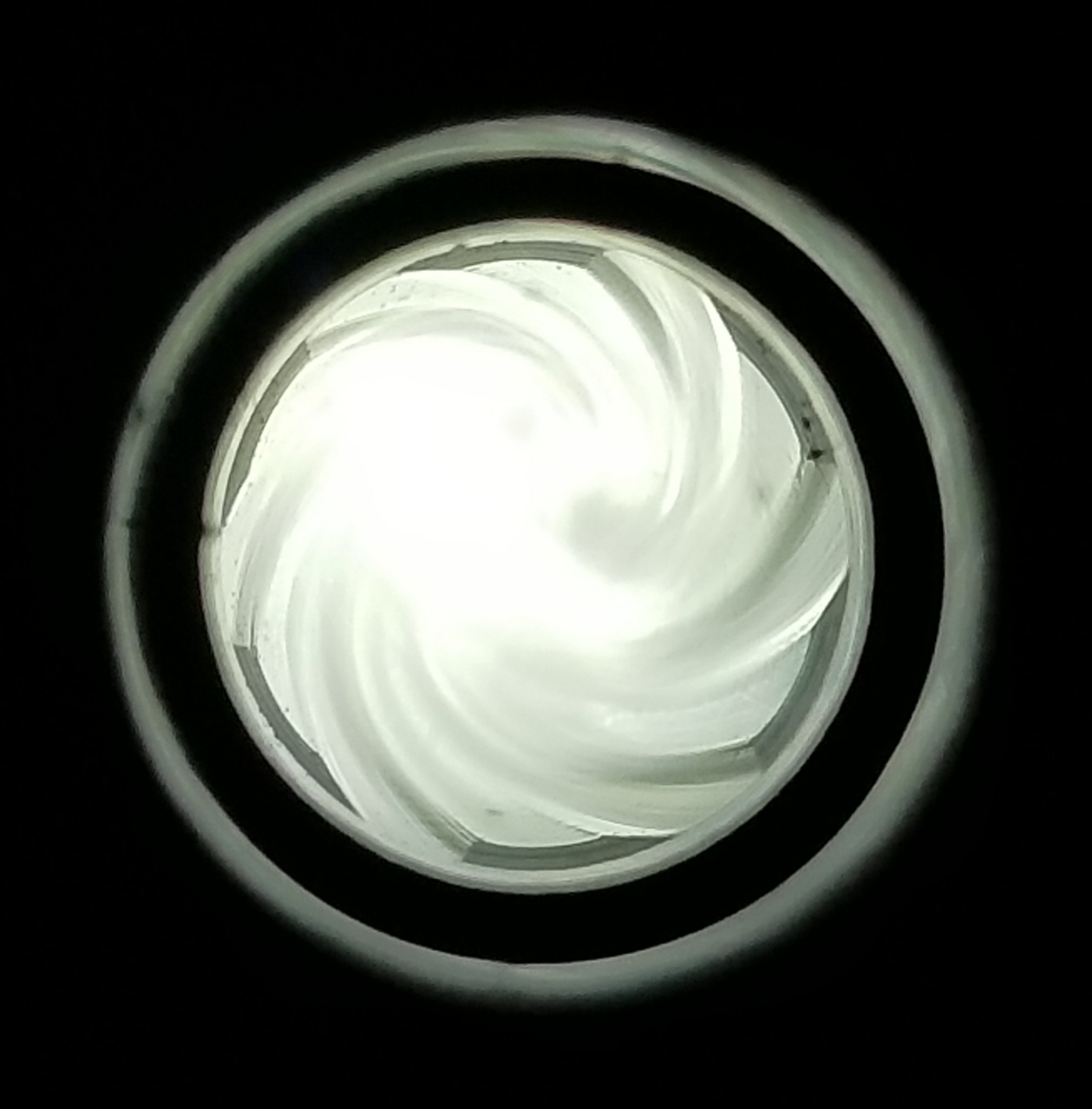

This is a pic of my 6.5 SLR Pac Nor poly barrel. I haven't shot it yet, so she still looks really nice. This barrel is one of their pre-Sunnen honed barrels, so I would imagine that those barrels might be even smoother yet. I wish the back of the land was as angled as the front.
