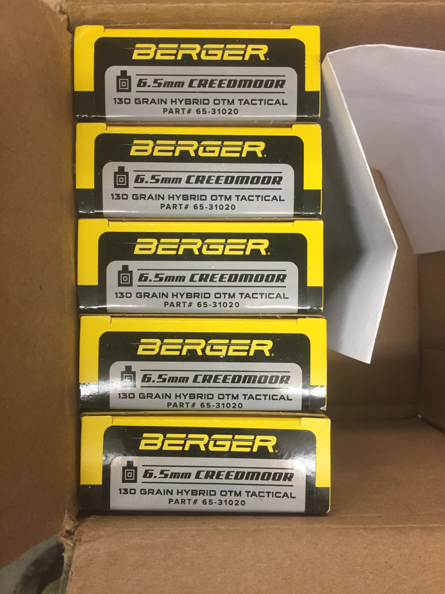

    Buy some factory and add it to your rotation. Buy enough of each to at least get a real idea of it. Buy quality, there’s a lot of good match ammo for decent prices. Go and shoot.
    The decision will make itself. Either you find that factory is good enough/great or you find that you want to stick with loading (but maybe faster). You’ll know.
    And you’ll be shooting.
