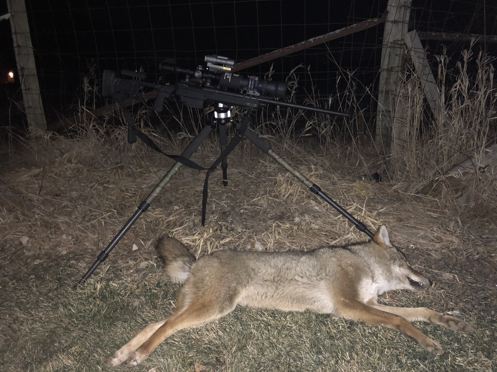

    Hey guys, I think I’ve made up my mind for my coyote setup but need to talk it through a bit. I’ve been running a 30 in front of a NF ATACR 4-16 with a Luna for illumination. Radius on top for ranging and it’s been a good rig. Heavy as shit with a 26” varmint barrel but whatever.
    I use a Pulsar Axion for scanning and have gotten good at IDing coyotes, deer, skunks, etc with thermal. In other words, I’m comfortable with making the shot without the more positive ID of NV.
    Routinely I’m locating potential targets with my scanner and then taking longer than I should to find it through my scope. Last night we had 3 coyotes just peeking out of a corn field and I couldn’t get a decent shot. I literally had the Pulsar in one hand on top of the scope hoping to guide me. It was almost a full moon and had a little snow on the ground. About the best NV scenario.
    I like running my day scope because there’s no question that it holds zero and I’ve shot plenty of coyotes with the pvs30. I just feel I’m leaving some on the table. I know guys like Killswitch have killed 100s with a similar setup. He actually inspired me to run this rig.
    Prior to this rig, I ran a Pulsar XP38 Trail for a season. I had decent luck but handicapped myself by shooting a 6.8. My range estimation wasn’t the best and the 6.8 isn’t exactly flat.
    In summary, I think I’m at a point where I could shed some weight going full thermal and keeping the Radius for range help.

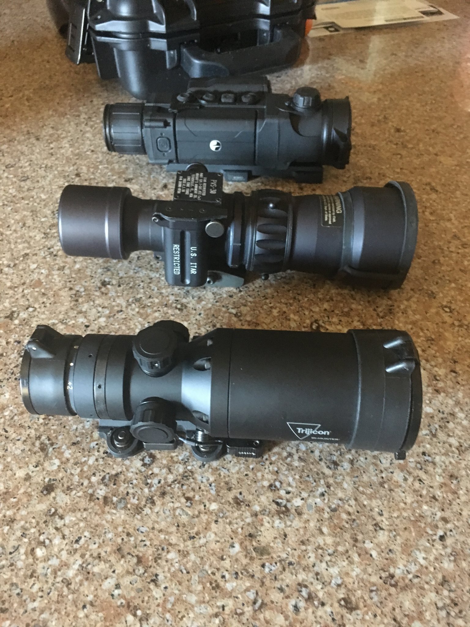

    I sold both of my PVS-30s and replaced them with PVS-9s ... the two PVS-9s cost less and one PVS-30 ... and have a clearer image ... and are easier to use, since the focus knob is on the rear of the units.
    But two plusses for the 30s over the SIMRADs to think about.
    01 - The SIMRADs need to be adjusted when moving from rifle to rifle.
    02 - We witnessed CBDRs recent experience of having his 30 power switch break, but between NVD and KAC, they were able to repair it for a cost. So not a "warranty repair" ... but a repair non-the-less. The SPI US based entity for the SIMRADs, seems to no longer exist. So any serious SIMRAD issue could be fatal. So could a 30 issue, but not necessarily and we saw an example of such.
    Are are those differences worth $3k - ish ?? The buyer must determine !!
    ive had no less than 10 simrads. they are excellent piece of kit but unsupported and if they go tits up youre screwed. I have seen some go down and I have repaired probably 5-6 failed battery housings on the simrad which are the weak point on them.
    to say the simrad has a better image then a 30. I don't know that I think it does. is it on par, yes. ive had plenty of them side by side.
    the caveat of the simrad is obviously the form factor and mounting solution. are they a excellent unit especially for the cost. hell yes
