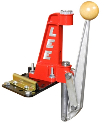

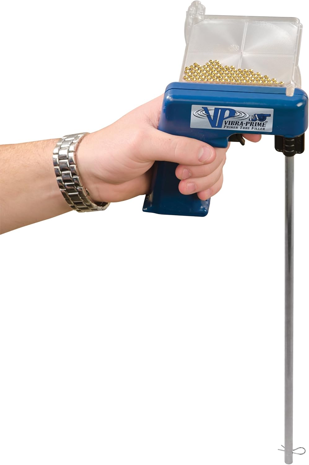

you could get one of these things . then get a cheepo LEE press for it to stay on. and a primer tube filler
BTW yes it is fun spending your money
