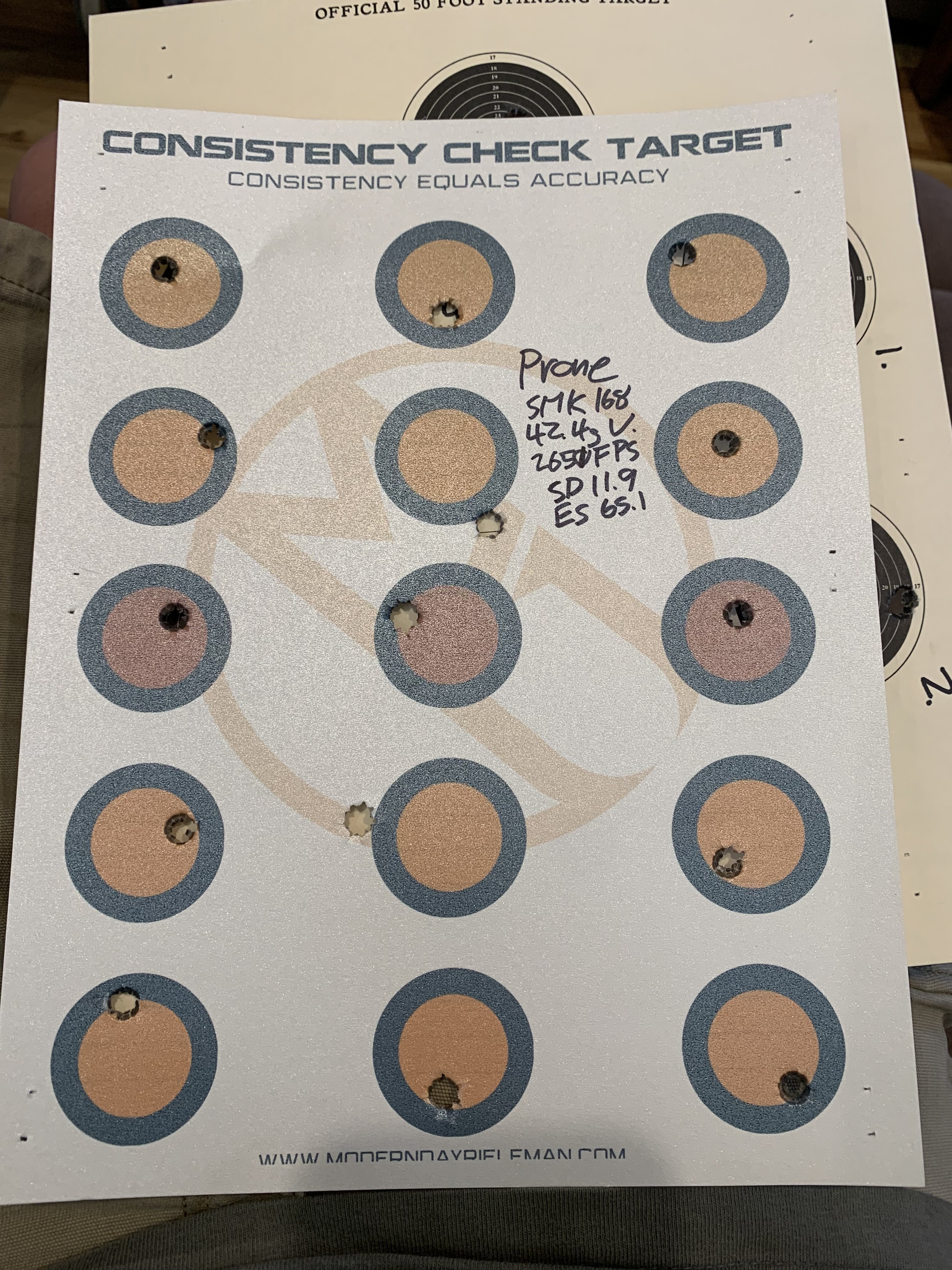

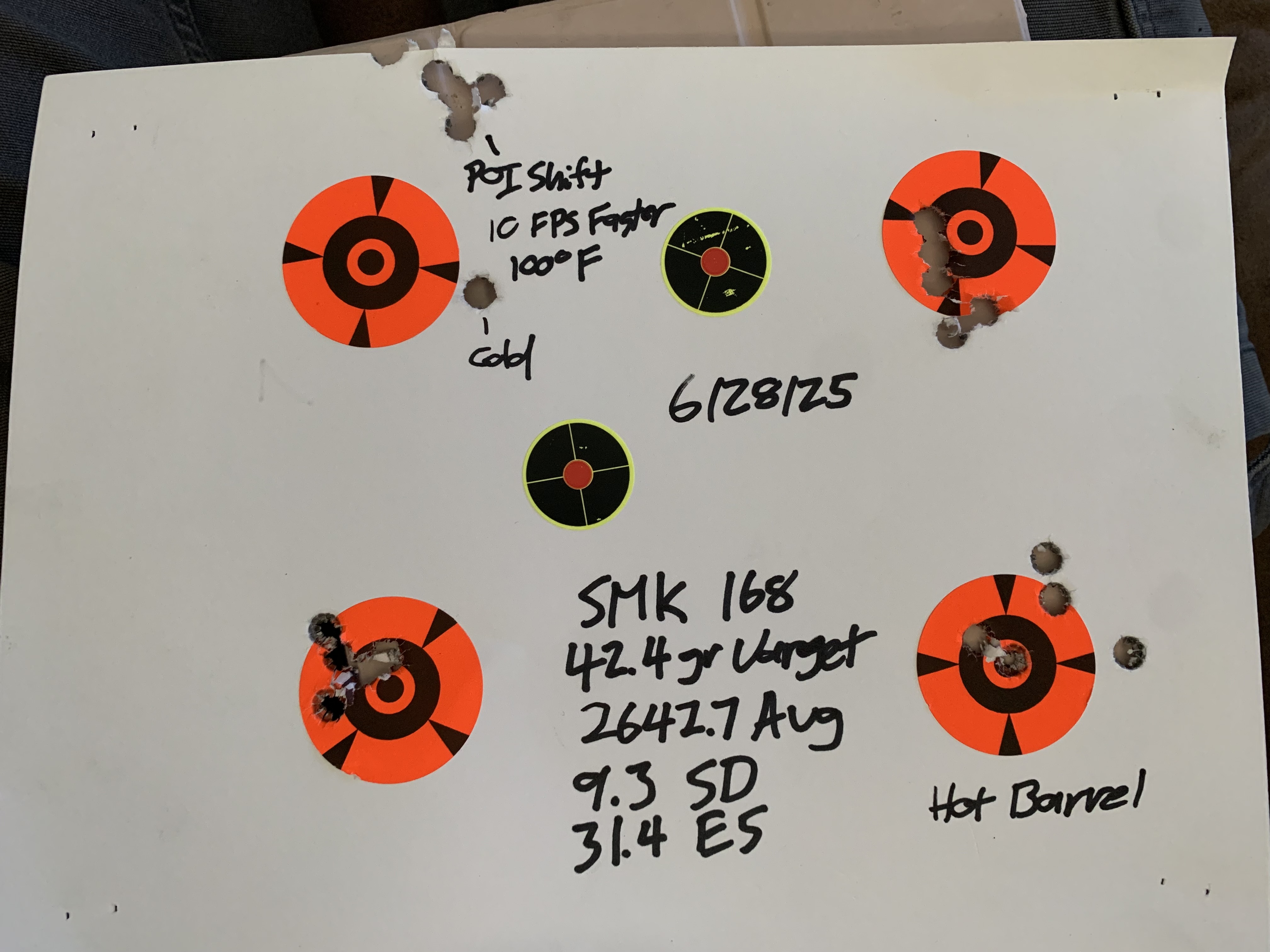

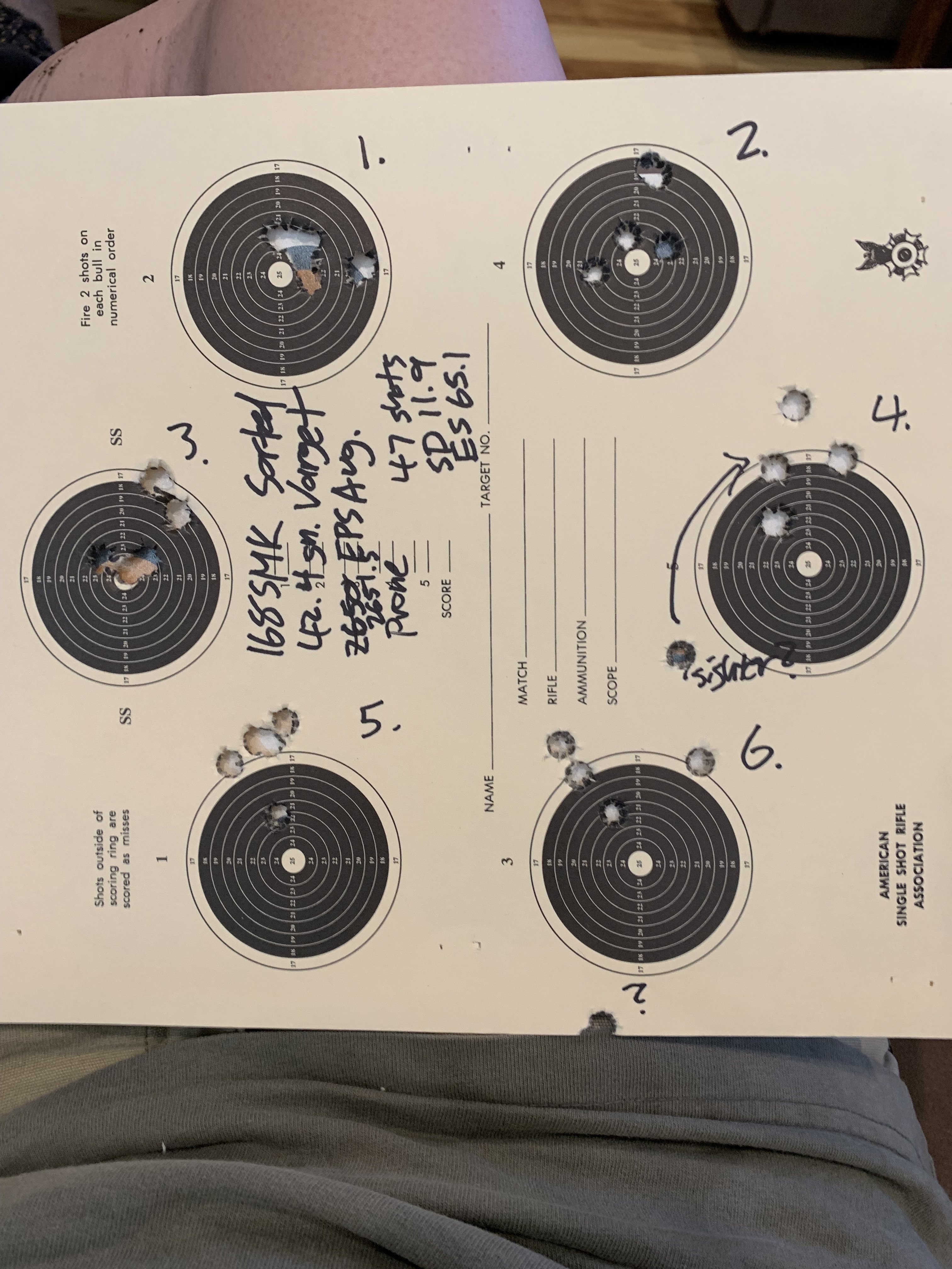

Been reloading .308 for a year, upgrading rifle and reloading components one piece at a time, pursuing consistent 1 MOA accuracy. Have achieved good to great results on occasion, but the only thing consistent is that my loads consistently turn to shit the next day.

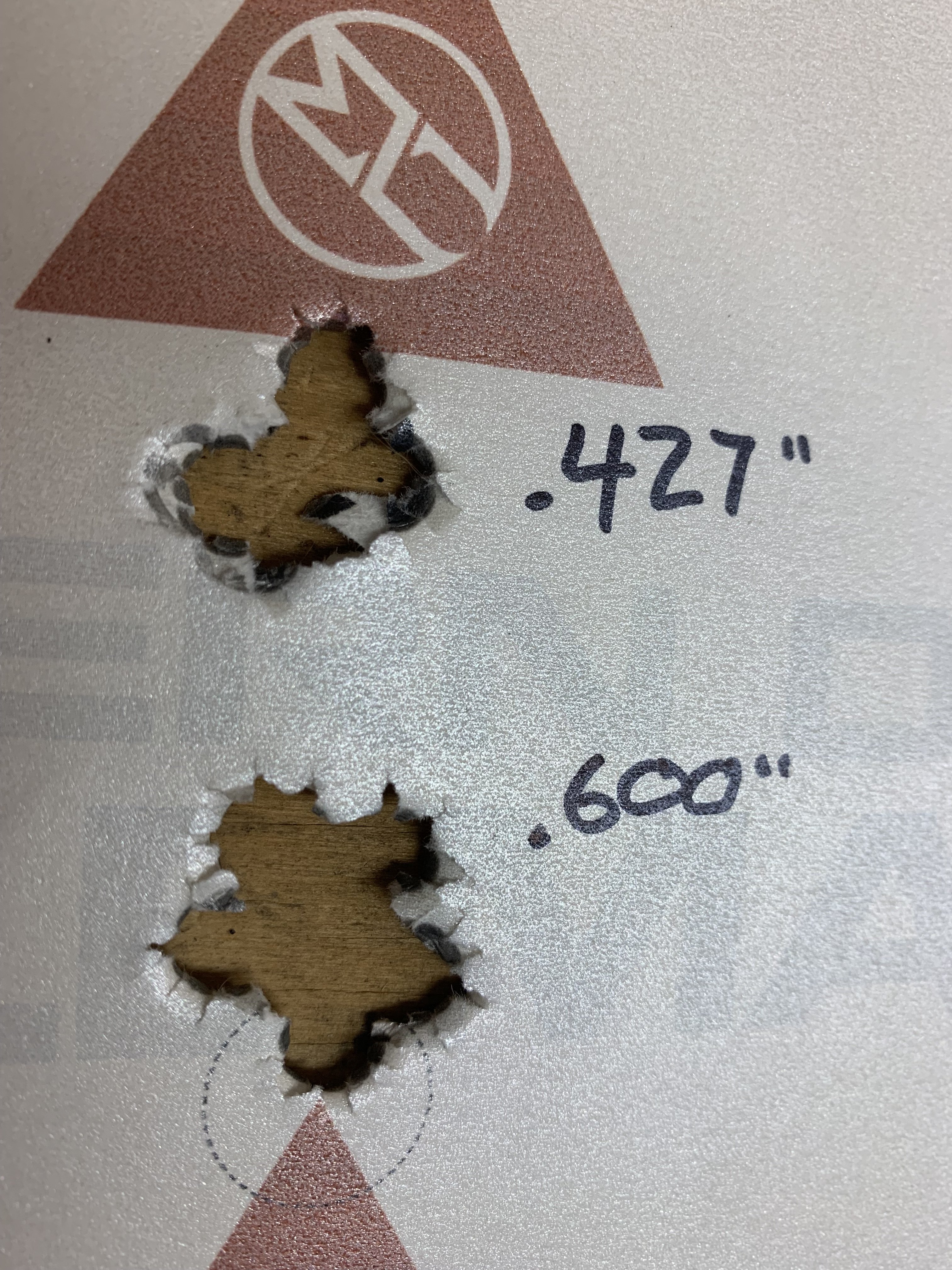

Shot these two groups recently, thinking I had it. Ive thought that before. There were 20 shots total, the other two groups a little larger but still under 1”. SD 8. ES 12. 20 shots. Avg velocity velocity 2640.
That was the last of the Varget jug. New lot runs about 40fps faster. Tried that, then went down from 42.8 to 42.2gn. Velocity was all over the place. Avg was close to targeted 2740fps. Groups were shit.
Well, I have 100 Lapua cases and maybe 400 Federal cases. Federal isn’t all the same lot and hasn’t been sorted by volume or weight. Maybe the universe won’t let me get away with that and wants me to get more Lapua.
Today, it was Lapua brass, 42.2gn Varget, SMK 168, CCI 210, and a pile of shit. ES 50. SD 18. WTF?
Compared that to what I thought was a good load from a few months ago with Berger 168’s, left over from a match. It wasn’t good. Big groups and big numbers.
Rifle is Remington 700 action, Criterion 24” light varmint, MDT Oryx, Nightforce NX8 4-32.
Reloading equipment is old RCBS rockchucker, charge master light, Redding full length sizing die set to bump shoulder .002”, Forster ultra micrometer seating die, and a 21st century expander mandrel. I trim every time with a Lee deluxe trimmer, if for nothing else, to chamfer the inner neck. On Federal brass it leaves a weird flange around the mouth of the case, which was suspect, and couldn’t be cleaned up with a hand deburring tool. On Lapua brass, no noticeable flange or weirdness around the mouth.
Recently started trying to anneal by hand, rotating case necks under flame until too hot for my fingers. It’s probably inconsistent and may be doing more harm than good. Neck tension and seating force feel much more consistent since using mandrel, Forster seater and annealing.
I suspect the Rockchucker is inadequate, but can’t imagine it’s the main problem. Haven’t checked concentricity. Why buy a gauge only to tell me my process is fucked? I dunno. Had faith the new Chargemaster was accurate, but will need to check that, too. My other scale is a super old Rcbs digital, so not sure how much that will tell me, if anything.
Gonna get a few hundred more Lapua brass to eliminate that variable. Haven’t tried all the bullets or all the powders. Haven’t tried all the expander mandrels. .3065 worked better than .306”.
If there’s anything obvious I could be doing better, feel free to point it out. I’m thinking a few imperfections are adding up to a big imperfection. Then there’s the human factor. I’m not a perfect shot but want my rifle to shoot better than me, and it doesn’t.

Yeah, typo on the velocity.
Regarding bullets, Ive had good results with bergers and sierras. Sierra seems to group a bit better but also liked to go faster, close to 2650, and I started getting pressure signs, so switched back to bergers which liked 2610FPS. When they were gone, tried SMK again and shot the attached groups, after some seating depth testing. Bought 500 more SMKs and am having trouble getting them to shoot again.

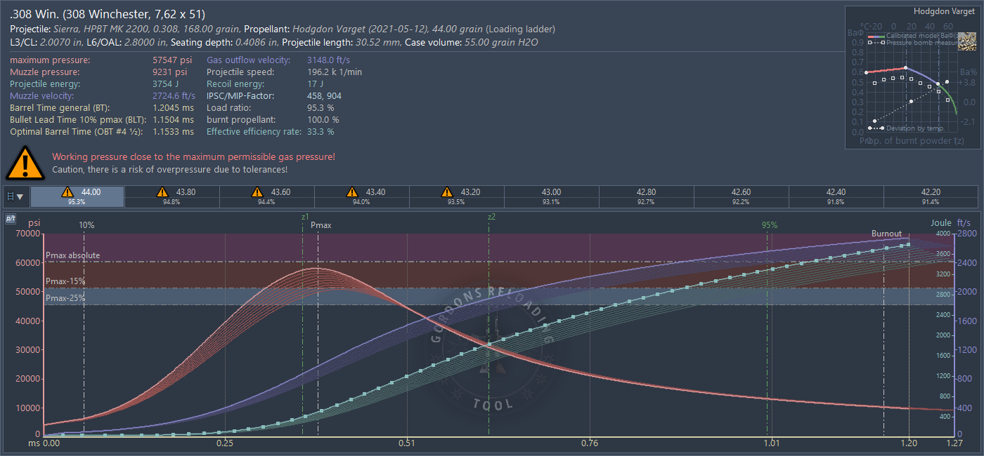

I haven't used Varget in a long time since I switched to AR-Comp, but looking back at my data, 42.2 grs of Varget didn't do particularly well for me pushing 168 SMK's with a COAL of 2.846" (decent SD's and ES's, but poor groups out of a Krieger 24" barrel). 43.0 grains worked really well for me with the same COAL giving me 2670 fps with sub .5 MOA's and low SD's and ES's (like 4.7 SD, 22 ES); ambient temperatures these were fired in was at 75°F and with no pressure signs. I wouldn't expect your new lot of powder to produce the same results my old powder, as it probably has a very different burn rate 🤷‍♂️ and my barrel was a heavy varmint.
I'm thinking, since you changed from Federal brass (which, BTW, is what I used to use too) to Lapua, you might need to test some different neck tensions??? I've found little difference between my Federal brass and Lapua brass case volumes, but Federal is a little softer brass than Lapua that can affect that interference.

If those 2 groups are 10 shots each, your load is fine, go shoot.

Cool. The plan is to load 300 consistent rounds and head to a 1000 yard range 5 hours away. My range only goes to 200. Was gonna take what was left after the last match, but they turned out to be less consistent the more of them I chronographed. Wanna take consistent ammo to validate long range data.
My arca rail was, in fact, loose, so thanks for the reminder. :)
Scales checked. Neck tension measured .002”. CBTO 2.231” and very consistent.
Brass was already prepped. Brushed inside the necks. Bumped powder charge up .2 to 42.4.
13 out of 20 shots hit the 3/4” ring , presuming 4 shots from the first bull hit. Last bull, rifle and I were both getting hot. Pulled one high. Wide shot at 3 was mirage.

Interesting results today. Had 50 brass prepped, same as last time. Sorted 47 SMK’s by weight. 50% were 168gn. Others varied by up to .5gn. Loaded em up and went shooting.
Started off pretty, then maybe pulled one right. Second group started trending high. Maybe too much cheek pressure. Relax. Same thing on #3. 4-6, all high. Sight adjustment was off. Came down .5 and hit low. Back to 0. Still high. Took short breaks between strings. Barrel was pretty hot.
Took a break, came down .3 and did this. Not horrible.
numbers weren’t great. Sd first 25 9.3, es 30. 47 shots, sd 12, es 65. Only 7 shots ruined otherwise ok numbers. One was +35fps.
Avg velocity +10 fps, ambient temp 91, -10 deg.

Not to sound like a dick, but out of genuine curiosity and possibly a better diagnosis, those groups are kind of all over the place and sort of makes me want to hear more about the gun..?
Your first group, where most are touching or went through the same hole is more what we’re looking for and more like what I’m used to seeing (and I’m not that good, but run a bunny-fart soft 22lb 6GT/6CM with an ~8oz trigger lol).
It makes me wonder if your load is fine, and if maybe there’s something else as far as gunfit or weight or whatever that’s not letting you meet your expectations?
I mean, depending on your rig, a lighter .308 can be a bit of a bear, you could throw a heavy sand-filled Gamechanger over the top of the scope to turn your rig into a boat anchor just to proof out what you’ve really got…

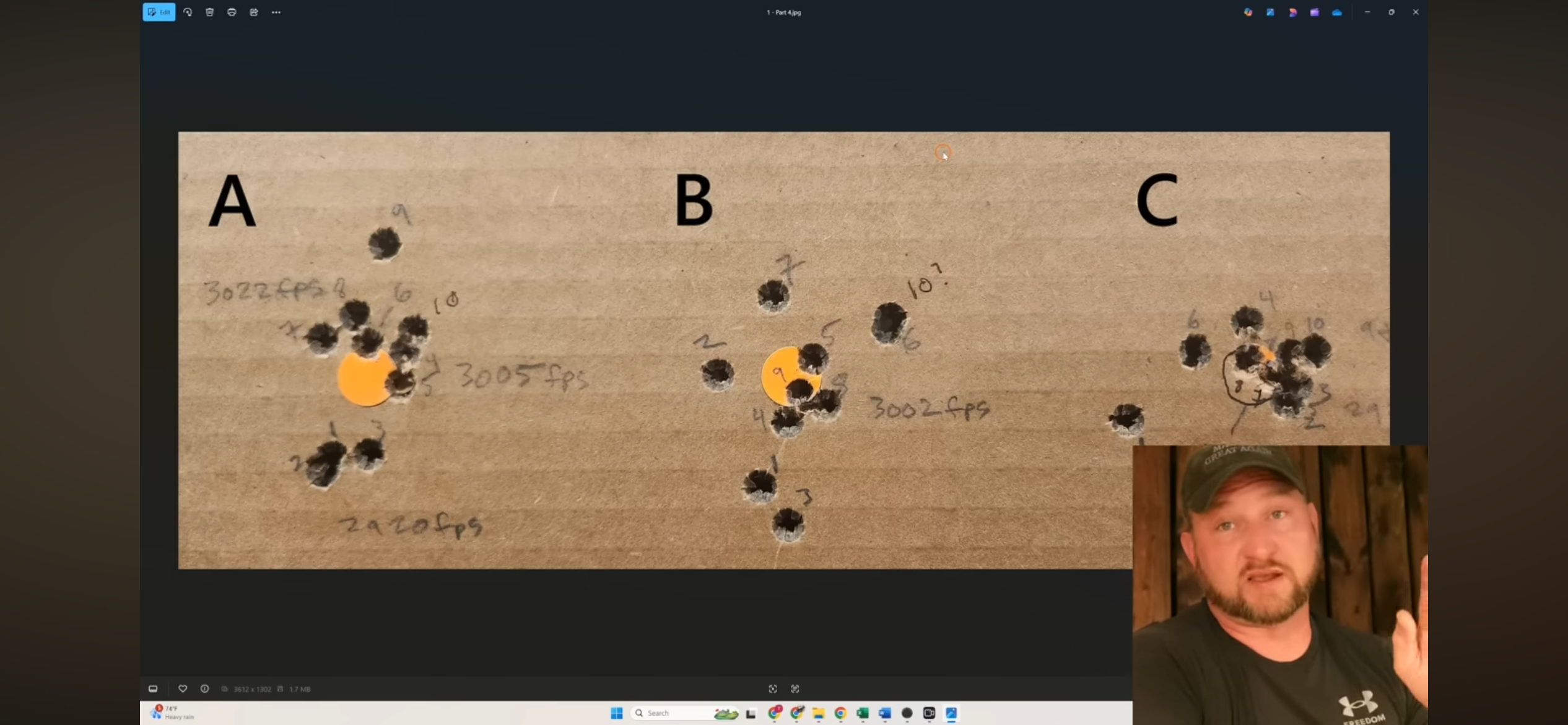

You might have a fussy powder/bullet combo. I would highly recommend you check out the reloading series on YouTube done by little crow gun works. Once you pick your bullet for your use case and have a batch of brass you can use gordons reloading tool (free software) to figure out charge weights for 2-3 powders that range from 50k to 62k psi. Then (if testing 3 powders) you set up your target with 3 points of aim (see below target).
Here’s a link to the series by little crow gunworks on precision handloading for 308 (Start your ladder test from 50,000 psi up to your max of 62-65K for 308. Look for high % case fill (90% - 105%) and high % powder burn (99% -100%)).
If using an extruded powder and you have an extreme spread in the speed of more than 30 it’s likely because not all of the powder is being burned and it’s causing wildly inconsistent speeds. To tell if the selected powder is too fast you will be at max charge but case fill will only be at something like 91% instead of closer to 100%. Pick a brand of brass, primer, and specific bullet and stick with that combo while you try different powders, once you find a good powder try different charge weights and COAL’s with ladder tests.

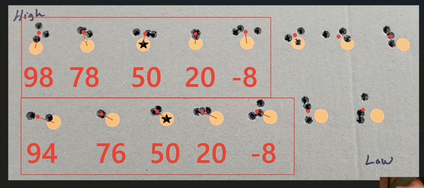

Once you have Gordon’s tool trued up, do a 10 shot ladder test (starting at 50K and working up to 62ish) to explore a powder and figure out if the gun is happy with that combo. For increments try to use the smallest possible for your pressure range. Start at 62K psi based on the temp for the day then work your way down to 50K. To find increment size take your max charge weight based on the temp for the day and multiply it by .0045 and also by .006. This gives you the starting and ending points for the increment size. Example for max charge of 43.6 → 43.6 *.0045 = .1962…43.6 *.006 = .2616 (your increment size should be between .196 and .261 grains for best resolution). For 308 he used 0.2gr increments. 1 round of each for 15 charge weights (spanning the 50K to 62K pressure range) for each of his 3 powders. If you test 5 powders it would take 75 shots. For the first powder you would fire all 15 shots at the same point of aim/target then repeat for the other 4, so you would need 5 targets on your piece of paper/cardboard. Make sure to cool off the barrel in between each batch. Shoot the shots for powder A then let the chamber cooler run for 1-2 mins. Shoot the powders in a round robin format (see 28 min mark of part 12) until all shots are done.
In below example powder C is the best/least fussy bullet/powder combo (consistent point of impact with various pressures is more important than group size (can handle changes in temp better, etc.). Once you figure out which powder is best for that bullet, test the powder more thoroughly by loading up 3-5 shots at each charge weight and each charge gets its own target.
Part 13: do a 10-15 shot group of all the powders (50-62K pressure range in 0.2gr increments) then look for groups less than 2” and for those powders do a ladder test with same increments but 3 shots for each on instead of 1. Then find avg point of impact (API) that is consistent among 4-5 targets and the mid point should be your charge (see stars in below screenshot (ladder test for powder C)) this will keep the API, consistent regardless of changes and temperature, etc.)
For seating depth pick the longest one in the accuracy window that way as the throat wears accuracy will stay the same.

Groups today grew progressively worse. Heat was a factor. Poi started to rise. Groups opened up. The first group, all the centers in the next two groups, and hitting the dot consistently makes me think I’m shooting ok. I did have to learn to shoot prone all over again. Shot old school bladed position for smallbore. It’s been an adjustment. Today it felt good. Could still benefit from some live coaching.

I didn't read through the whole thread so please forgive me if this has been done. Have you tried some Federal Gold Metal ammo with the 168 gr SMK and with the 175 gr SMK? The three 308 Win I've had over the years would shoot one of those good.
You're dot target looks pretty good. I don't know why the other target seems more scattered.
As was mentioned, some of the difficulty could be your technique/fundamentals. Personally, I sure had to work at it. I'm a lot better now but still not great.

Wish I’d seen this a year ago. Setting up GRT now, measuring case volume, see what it says.
Same here! I just discovered it myself thanks to this video series. Pretty awesome its still available for free.
In addition to fired case volume id also make sure to input your avg length for your bullets and input your avg brass length measurement
Reactions: Josh Umsted
If this output is correct, and I think it is, 42.4 gn Varget only burned 95% of the powder. 44gn, as pictured, would burn 100% and remain well below max pressure. Predicted MV is 2725, right where I was working on the higher node and ran into pressure signs. Gonna try working the charge upward starting a bit below 44gn and see what happens, then start over with new components when they arrive.
