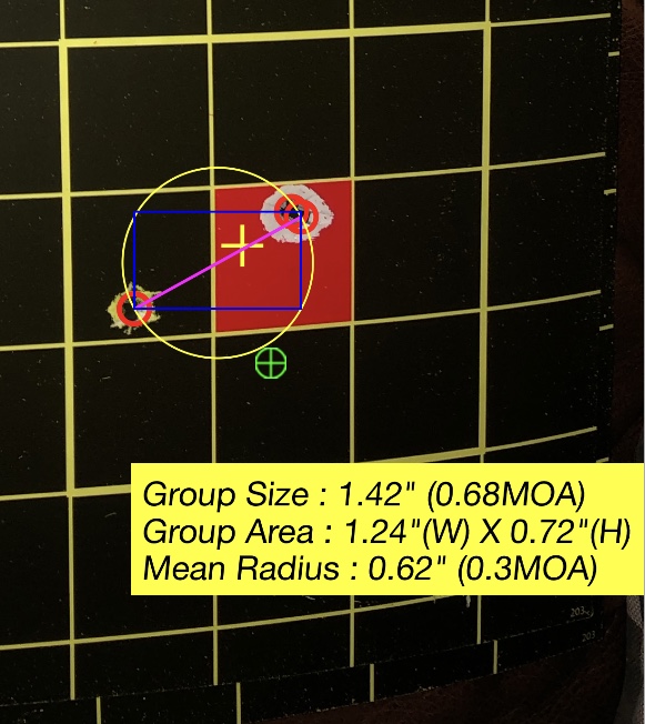

How everyone,
Today I was trying out some match grade hornady 68 grain loads out of my tikka t3x. I would shoot three times per weight change. Practically every time I would shoot through the same hole twice, and would have one flier. The flier was usually the second shot.
Is it me or is it something I’m doing wrong with my handloads?
It’s pretty consistent on the second shot. I’ll reload some and try 5 shot groups.
Consistent how?
It's always the second shot but the location on target is random?
It's always the second shot and the location on target is always the same?
You need to be much more specific if you hope to get any useful feedback.

I'm not going to get full soap-box on you here, but 3 shots is only good for a very brief sanity check, not for qualifying anything.
Short soap box:
Shoot 10 at a minimum, 20-30 if you're serious. I know that sounds absurd but it only sounds absurd because this community has been chasing it's tail in white noise for probably 70 years now in an attempt to get the "most data for the fewest shots fired", and unwittingly gone way too lean. If you were watching any production line anywhere, and pulled 3 or 5 random samples off the line of hundreds or thousands to inspect and said "Yup, they're all good!", you might not have a job for very long.

Agree. If you are developing a load for your rifle that you will use for the life of your barrel, and you do that based off even 5 round groups, that's a big decision based on a sample size of about 0.0016%. More holes mean more data.
Short answer, it’s you.
Happens to all of us more times we like to admit. It's a positional error. Your body gets into a slightly different position. To quote:
"The dispersion of a group is primarily driven by two factors:
  1. Mechanical precision of the weapon system (i.e. barrel, optics, ammunition, and other parts, combined with how all those things attach and interact under recoil)
  2. Aiming error of the shooter (i.e. the trigger was pulled when the sights weren’t perfectly centered on target or perhaps your body position or rest wasn’t consistent shot-to-shot causing the weapon to move differently under recoil in a way that skews the bullet’s trajectory)"
