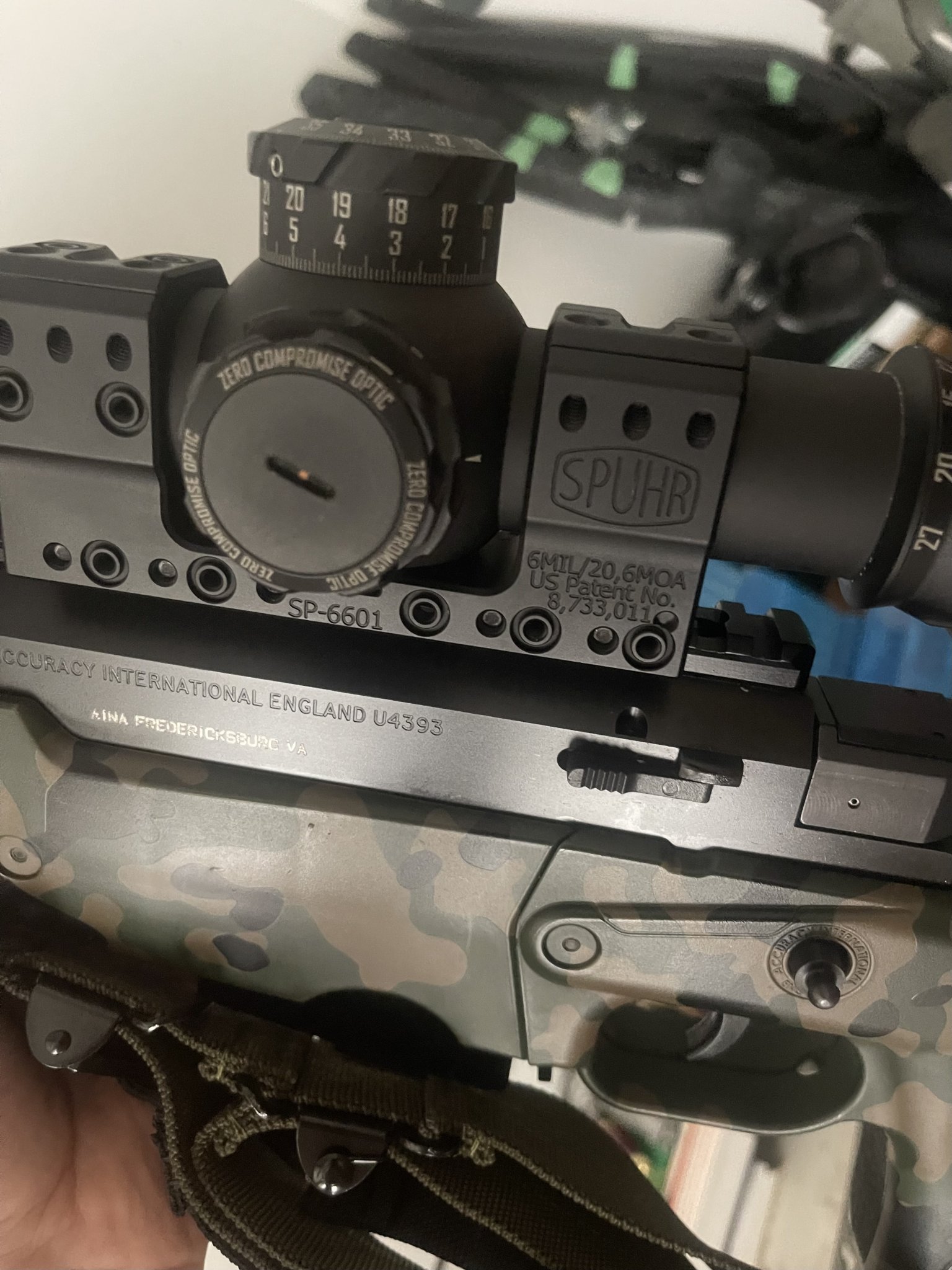

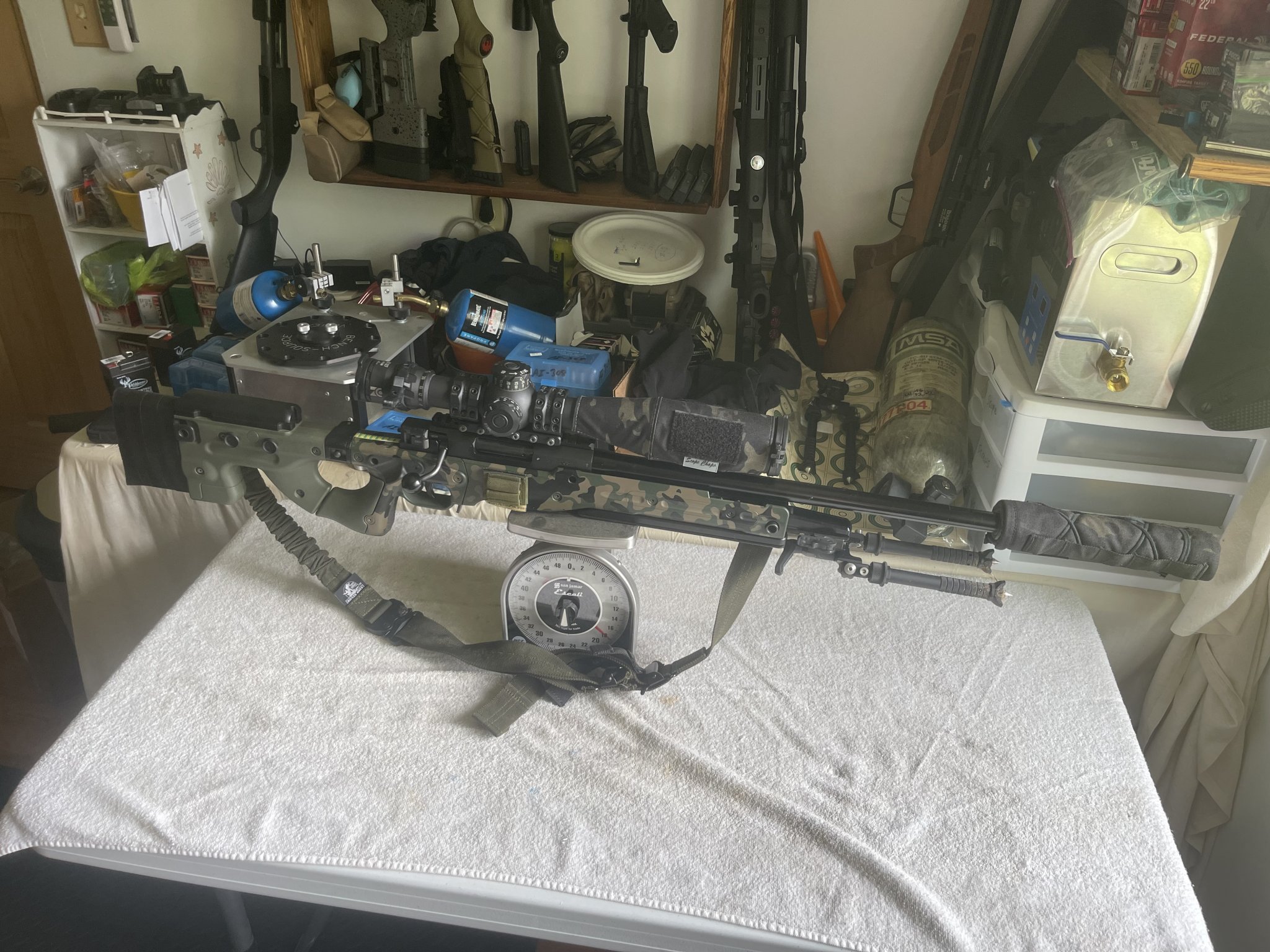

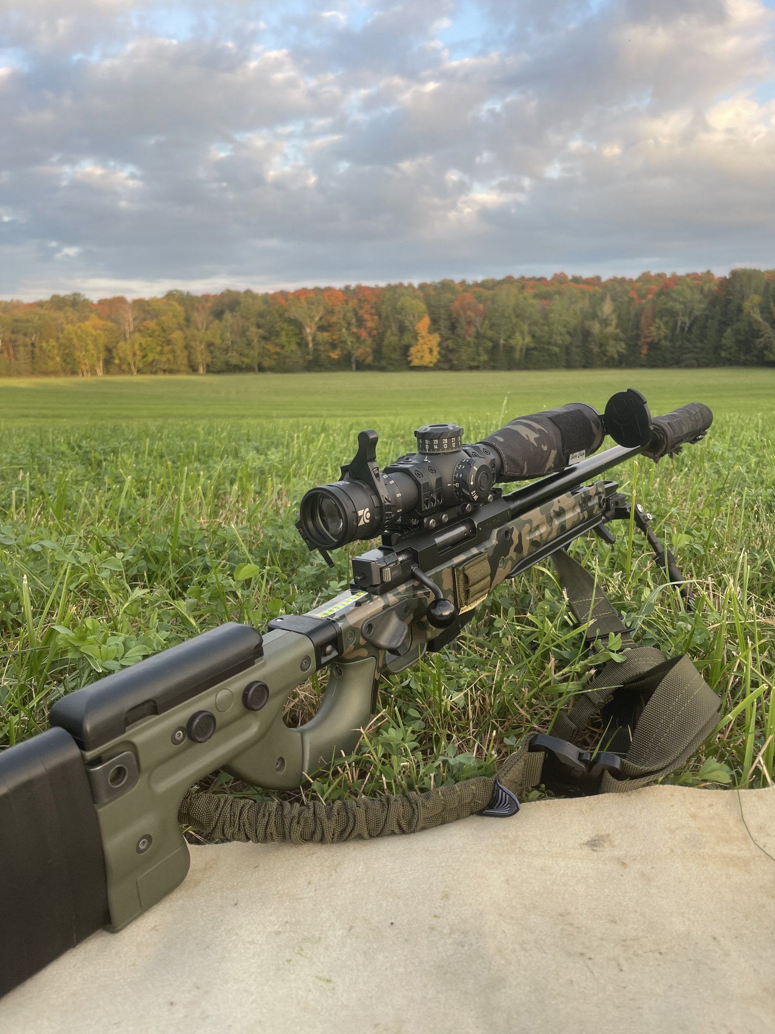

This rifle I use a ton for crop damage hunting. AT with 20” 308/ZCO 527/TBAC Ultra 9/Atlas CAL Weight is 18 lbs
View attachment 8242806View attachment 8242807
Jesus, that is slick.

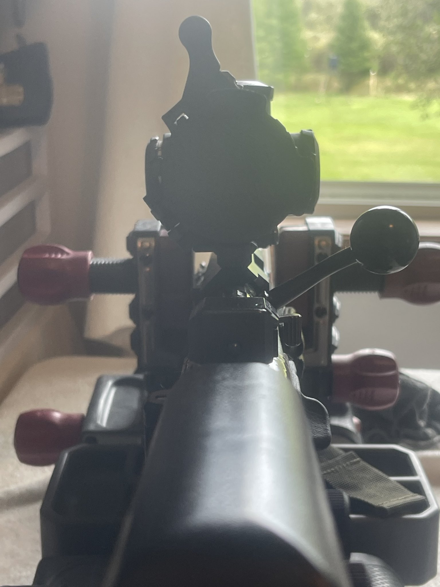

What Spuhr model is that? How's the bolt throw clearance?
The AT-X factory 24" barrel extends about 6-13/16" past the forend. That is about 17-3/16" of barrel flush with the end of the stock. A 16" barrel is going to be a mess. Maybe, if they put out a short upper, like they have with the AT-X AICS ...
