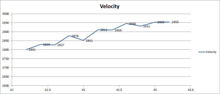

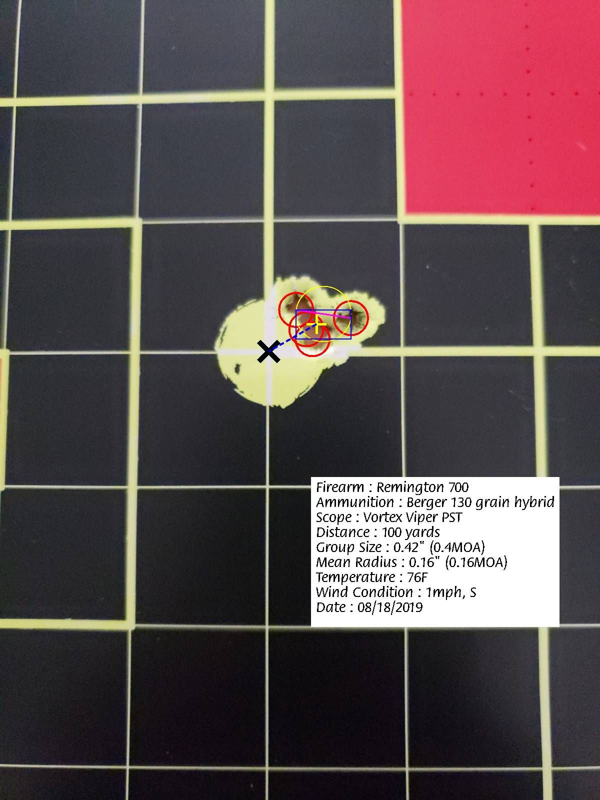

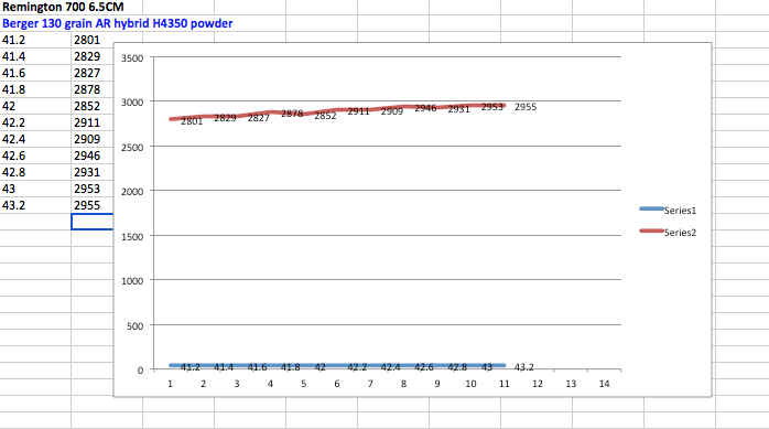

I just got my rifle back from the gunsmith: Remington 700 6.5 CM new Bartlein 5R stainless barrel, blueprinted action. I put together a mild load to break in the barrel and zero the scope, and this "test" load is shooting great. I also put together a 10 round OCW test but this test load @42 grains of H4350, Hornady LR primer brass, with 130 grain Berger hybrids seated to standard 2.8 COAL / Base to Ogive is 2.1790 is sub 1/2 MOA. From the OCW test I wouldn't have picked this load for further testing.
Questions is do I need to continue testing other loads? I just target shoot no competitions.

I guess I am confused. You created a break-in load with the intent of doing additional load testing. You are happy with the performance down range.
Do you need to do additional testing? The obvious answer is no as you did not need to do anything other than load and shoot to begin with.
If what you really meant to ask is something along the lines of can you get more out of the rifle if you keep searching, the answer is yes. However, if you are only shooting 100 yards the improvements are going to be minimal at the target. If you are going longer distances you will almost definitely want to spend more time.

load up a few of 42.3g and see how that goes. i bet it'll tighten up those velocity spreads.
but don't forget - once that barrel breaks in and speeds up - you might have to back off that charge a bit to get back into that velocity node.
My final load with 140 ELDM, same brass, 42.0 grains H4350, was my lowest SD along with 41.9 grains. That 130 Berger has more case capacity but shoots well at 42.0 for me too. You can get lower SD with more powder with the 130. My SD with 41.9 and 42.0 was 7 and 9 for 10 shots. Straight swap to 130 put me at 16.
Your sample size is way too small to establish an SD or an ES, but if the ES is already too wide in a small sample, it almost never gets better with a bigger sample.
