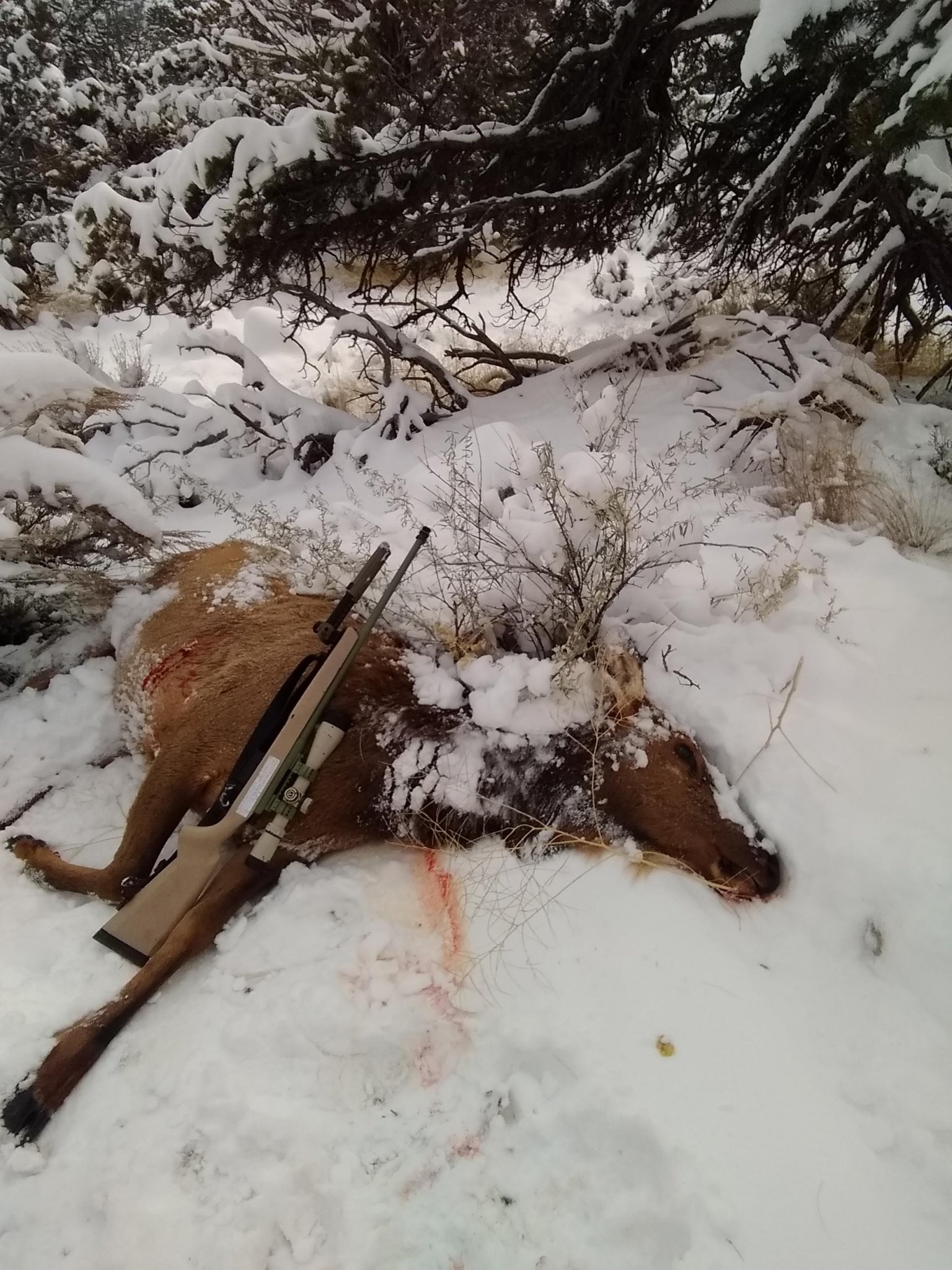

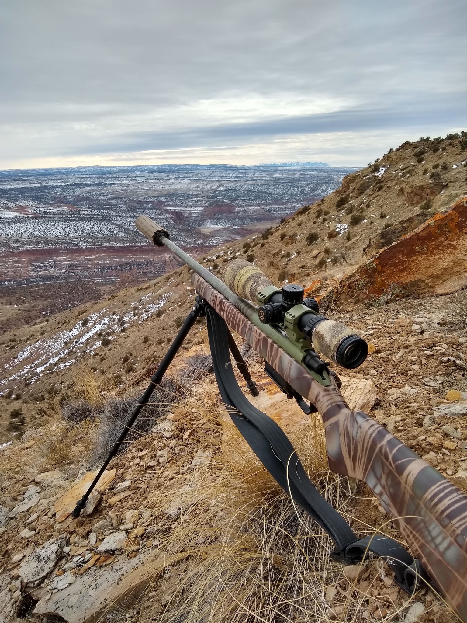

    The brake on the photo with the elk is a Griffin for my silencer. Obviously it is doesn't match the contour of the barrel so if that's super important then you'll need a carbon barrel. The nss barrels from criterion are very accurate. Often a bunch of 1 hole group development so I just choose a velocity that I like.

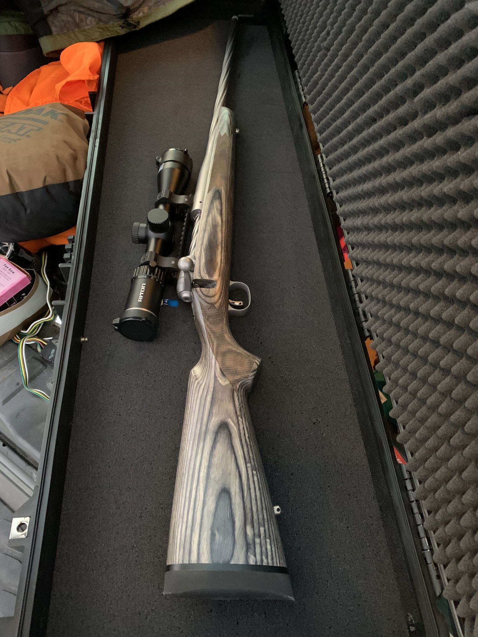

    Almost two years ago now I ended up building a 28 Nosler on a heavy Sporter barrel. Really wanted it as an elk gun so I had the same weight questions in mind. I used an ER Shaw Precision barrel, spiral fluted, it’s threaded and has only ever had a can on it, I never minded the recoil. Gun with scope and stock sits right at 7lbs and shoots very well. Last summer I had it out too 1,200 yards and it did so with easy. Since this one I’ve built a few more, both heavier and lighter and it seems as if heavy Sporter is the sweet spot.

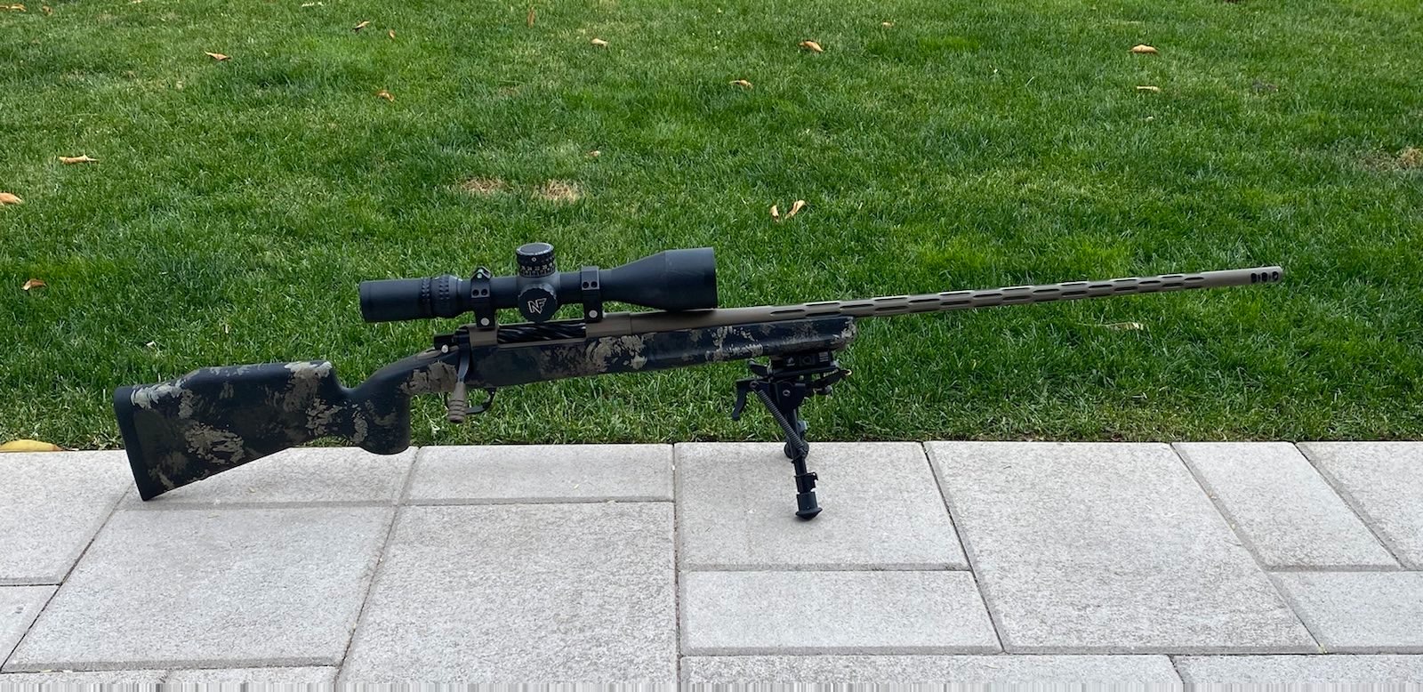

    I ordered a few heavy Sporter barrels from NSS and had their local gunsmith cut one shorter and thread it. The heavy sporter has the right diameter for threading 5/8-24”. If you want to go lighter you’ll need to go down to 9/16”.

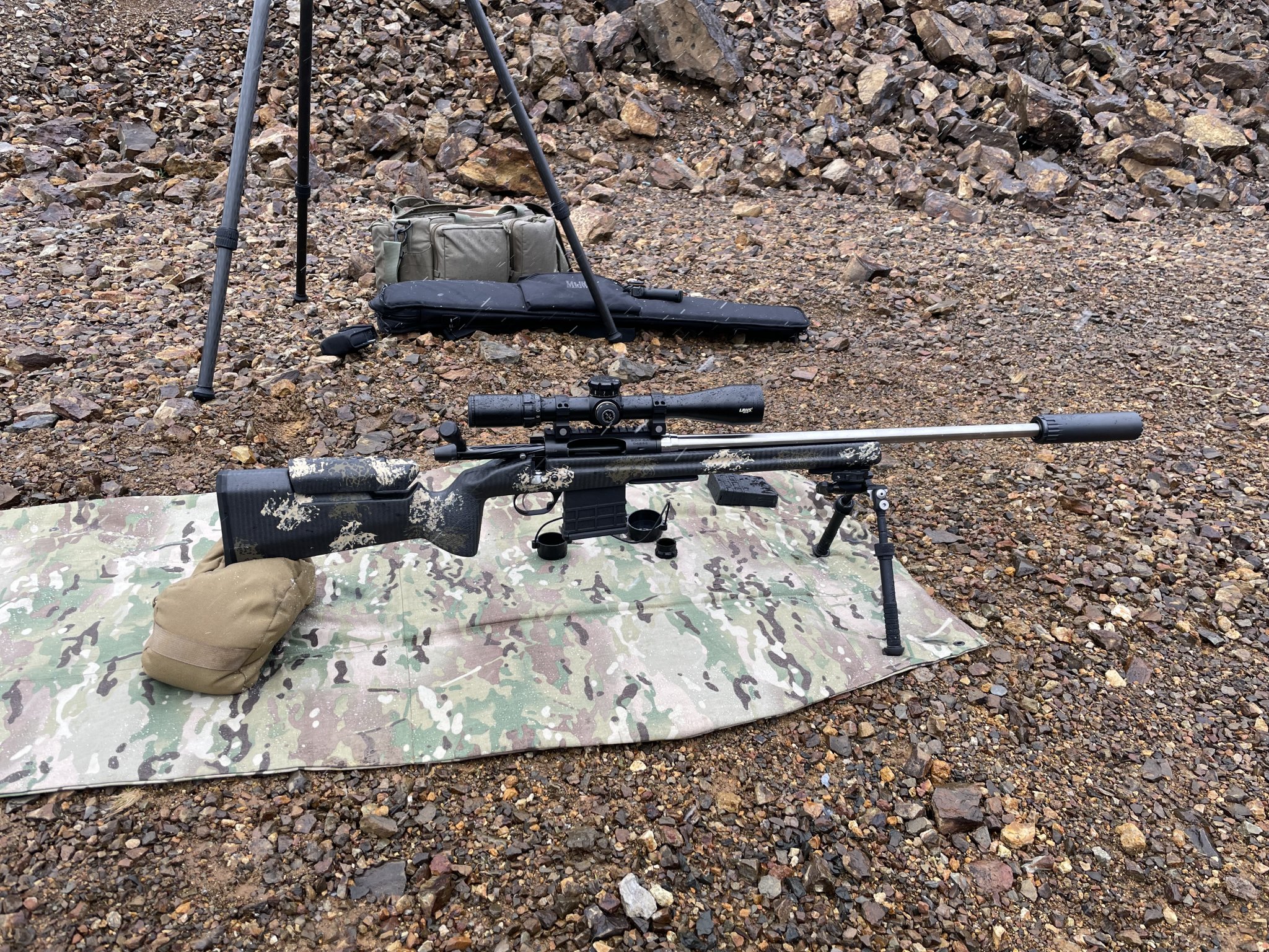

    I have a 26" Bartlein 3B contour on my 28 Nosler. The rifle without a scope isn't bad weight wise but then I threw a ATACR on it and tips the scales at 10lbs 12oz. Shoots great but will heat up quickly.
