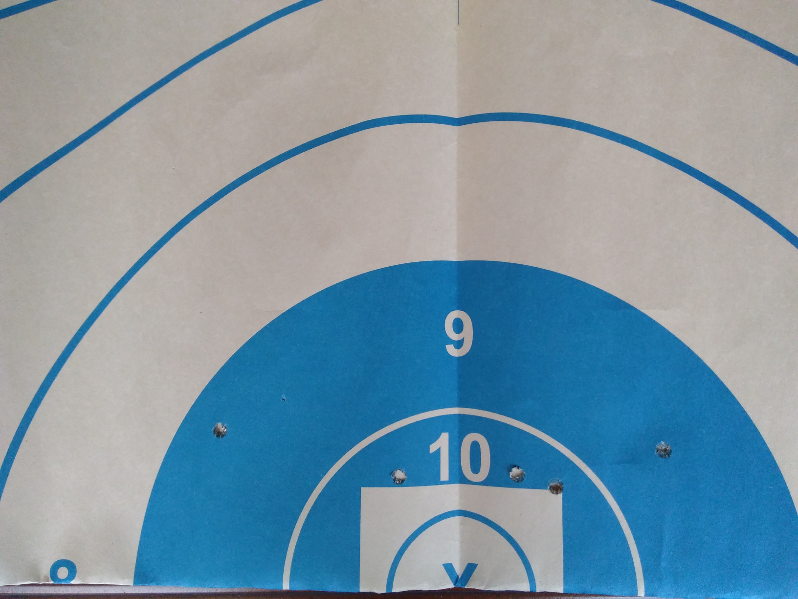

    I want to point out this fact.....this converted brass isn't to 'Just get by in hard times'....it is a very viable and can be a very successful brass to use even in the toughest competitions.
    The following was NOT a winning target...but it was a 2nd place finish in a shoot off in 1000yd Bench Rest in some strong winds that were both switchy and variable speeds....so the wind reading was ALL my fault...the verticals on these shots is just insane.... Vertical was 0.715"
