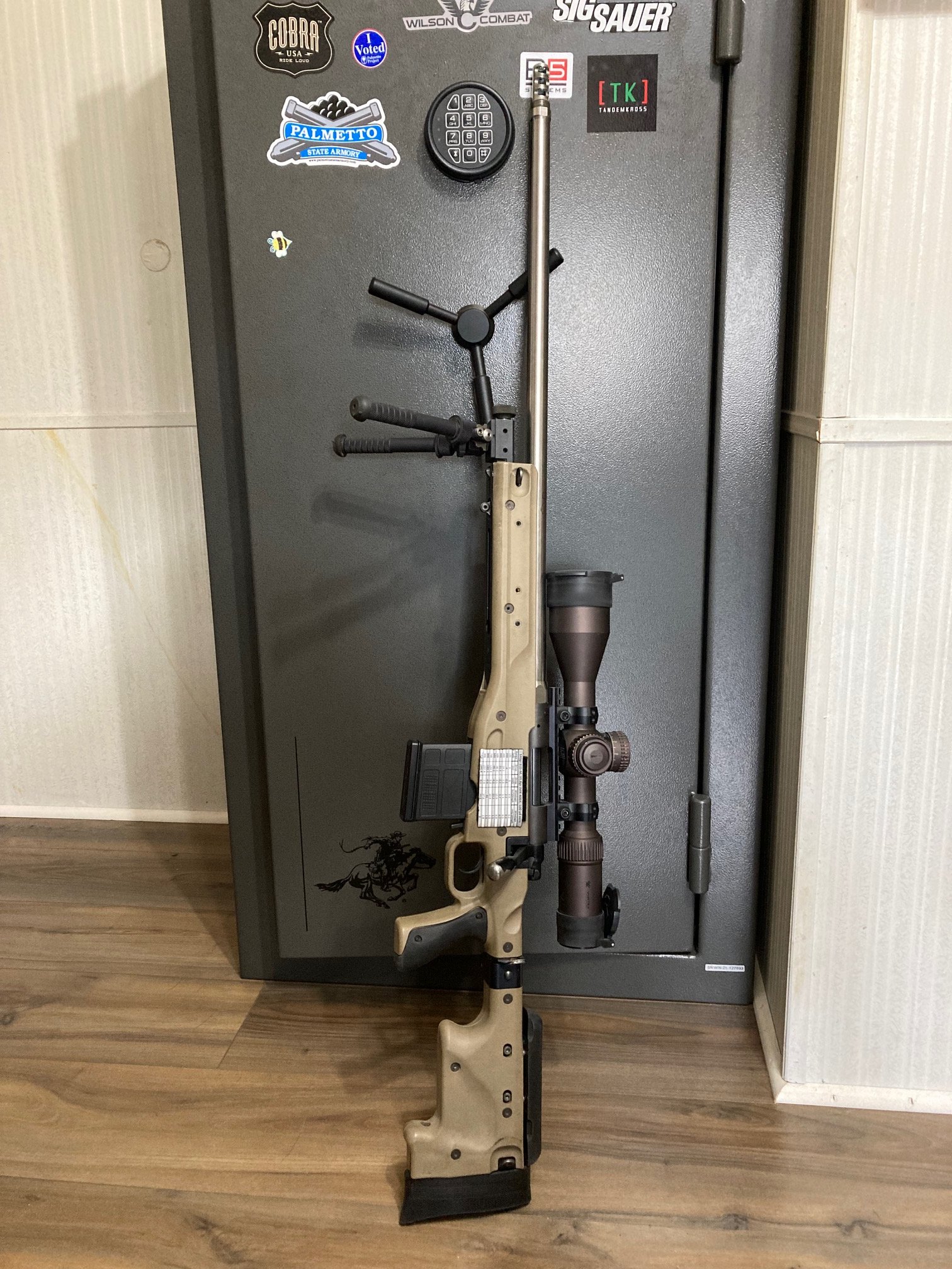

This rifle started out life as a Rem 700 SPS (lefty) in .308. Since you've already got the chassis/AICS magwell, etc, you're only looking at a barrel swap. If you have the tools, it's an easy option--I went with a Benchmark X-Caliber 'Remage' 6.5 barrel. You'll need a barrel vise, action wrench, and GO/NO GO gauges. Torque wrench is a good idea, and go with the barrel manufacturer's recommendation. While I had my receiver stripped bare, I stuck it in the lathe and squared it up. (Mine only needed about .005") I'll go with a traditional Rem 700 barrel next time, just for the aesthetics. I have right at 2800 rounds through it now. It's sped up about 50 fps but accuracy hasn't dropped off yet so I'll leave it alone.
I made the change to 6.5 because the old factory Rem barrel was a sewer pipe--1.5" was the best I could hope for at 100 yards with any ammo. At the time, 6.5C was the hot new thing that everyone was talking about so I decided to give it a try--I'm glad I did, no matter what the Cool Kids are saying about it now. 600 yards is no longer the challenge it used to be. 1000 isn't difficult and I've made hits at 1 mile. (it took a few shots to walk it in, but I connected on #3)
I'm using an oddball recipe for my handloads: 35.8gr IMR 4064 under a 140 ELD-M gets me about 2650 FPS. I could go with 41.5gr of H4350 like everyone else for another 100 FPS but I don't need the extra speed to do what I'm using it for. I'm just a long range plinker, not a competitor. I like the softer recoil and when I stocked up, it was easier to find 6.5 components than .308.
