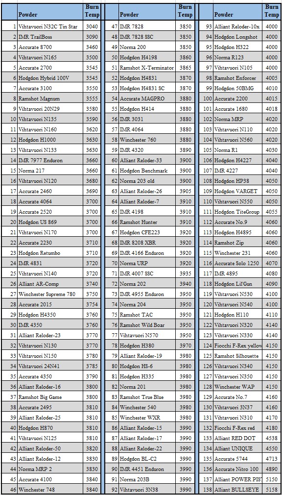

Haven't been able to find a thing about this.
Were can I find some info, actual data on, which powders burn "cooler" than others?
Per grain of heat out put.
Have a 22 creed barrel coming in and I have a couple powders I'd like to try
and if it comes down to it, I'd like to run the one that will extend my barrel life if all else is equal.

Thank you. Wish it had all and was more updated.
But their are some powders on there that I plan on testing.
Their is no rhyme or reason to it.
You would think the IMR4831 would be close to the H4831
The RL's are spread out and the VV double based all run hotter than the single based.
Again. Not what is being discussed.

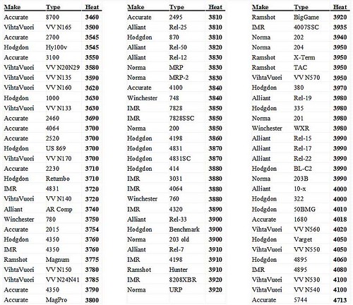

That chart was created from a table in quickload I believe.
I did not see that till now. I wonder if that chart includes pressure across the board for all temps. Wish we could find the creator of it.
I don’t think temperatures have a direct correlation to pressure.
Burn rate would correlate to pressures but the temperature that burn rate occurs at is irrelevant to a point I believe. Burn creates the propellant, how hot that propellant is doesn’t factor into that equation.
