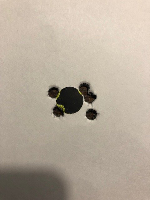

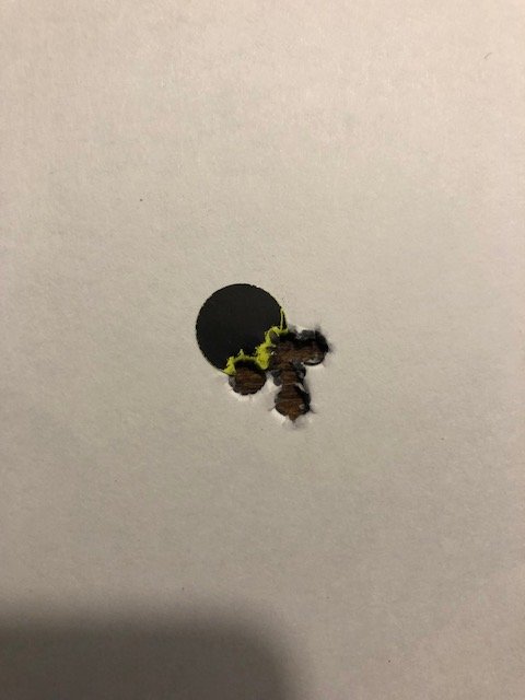

To answer one question, all were shot unsuppressed. This will be an ongoing experiment. From here out I will avoid cleaning until a definite repeatable degradation in accuracy occurs. To help eliminate shooter error (eye fatigue, etc) I will limit my range sessions to no more than thirty-five rounds each. Since I go at least once a week we'll know something soon. Thanks for all the advice! Will give updates as I go. Starting with a freshly cleaned to bare metal bore BTW.

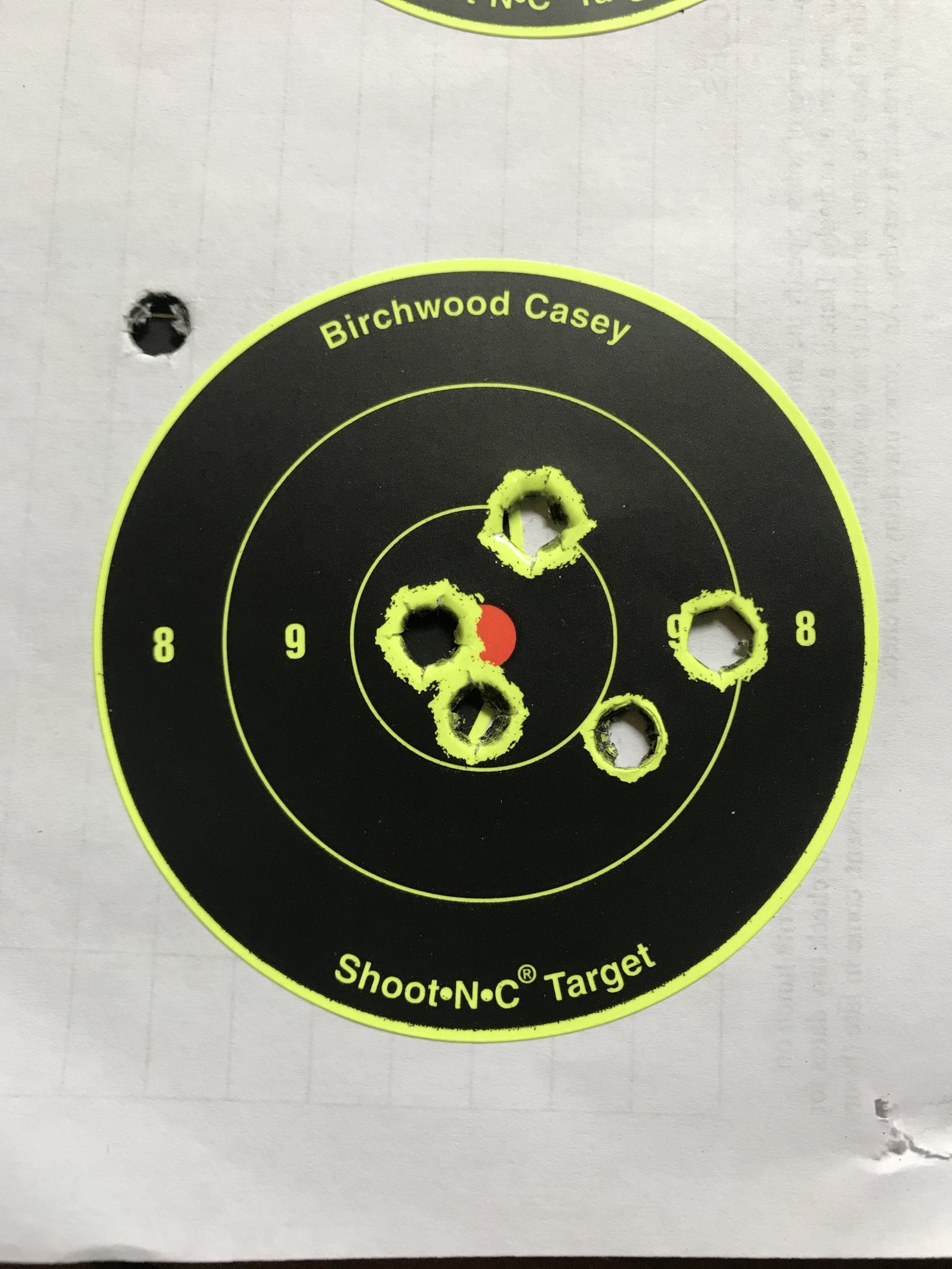

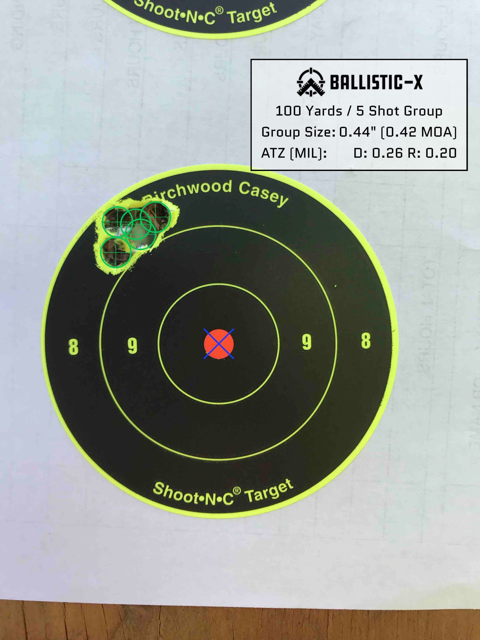

Thanks to those that said to give it a rest and go back another day. Turns out it was me after all. Guess I was getting a little tired and got sloppy with my technique. Went back Sunday without doing any sort of cleaning and it grouped like it should again. I can deal with a bit of copper fouling as long as it groups decently. I did, however, run a patch with Hoppes and a nylon brush to knock down the carbon a bit. I figure I should be able to go about 150 rounds or so before doing any real copper removal. BTW I have found the Gunslick foam to be very good. I had a can sitting on my shelf for years but for some reason I never used it.
Happens to all of us. We usually blame the equipment prior to blaming ourselves. Ask me how I know. ? Glad your all squared away. Within 10 shots of each other after spotting half the day for my buddy. Its rare for the rifle to go over 3/4”. Packed it up after the big group.
