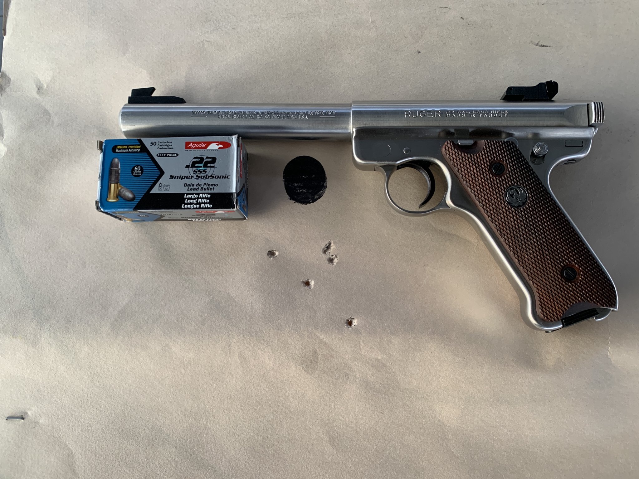

I have done a bit of testing in a Ruger Mk two pistol recently. It is the Gov't Model 6 5/8" barrel. The pistol was new in box with test target and is stunningly accurate with any good ammo I have shot. From what I read the standard Mk II is twisted at 14". The Gov't model is at 15" and one other target model is at 1/16 but I cannot recall which. Also I will not state for certain that the other twist are correct. Just what I see on the 'net.
Pics to follow.
6 shots at 100 yards with the 60 grain ammo. All holes appear round. This Ruger is reported to have a 1/15” twist barrel. At any rate, it’s working well.

Shot the Ruger yesterday. It’s now set up with integrally suppressed barrel. A friend was spotting for me. My interest was if bullets were stabilized. After 3 shots he said “stop, you need to see this.”
First 3 shots at 100 yards. Iron sights. So, the 15 twist is stabilizing the SSS ammo.
Going to test a Bartlien 14 twist in KIDD as soon as it returns from LRI.
Will shoot and report on both more extensively when time permits.

Bear in mind that the above posted groups are the only ones I have shot with the Ruger so far. They are not selected. I think this combo has promise. I do not expect the results to be as good as initial testing but I do think 6" 100 yard groups are likely and will serve my purpose.
Thanks, me as well. Also if a guy shoots 10 and selects one it’s not representative of overall groups.
We were pressed for time. I will shoot 5 10 shot groups and post them up once I get time. The important thing to me was bullets stabilized.
