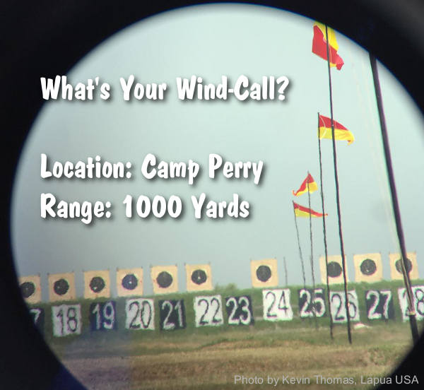

Aside from the OP's ridiculous example, flags, mirage, and practice coupled with note-taking will help with getting more experience.
