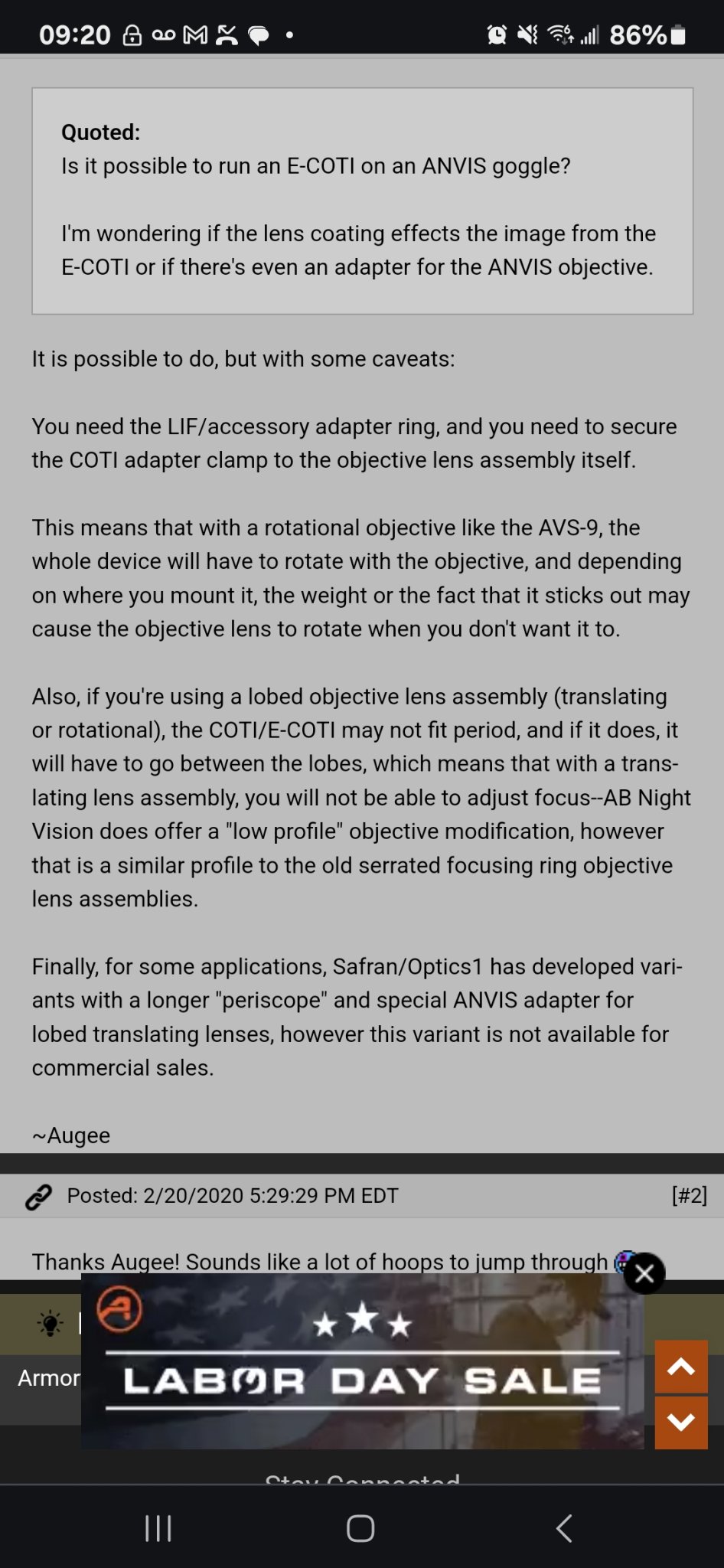

    Anyone run a COTI style unit on the ANVIS housing? Have seen a few older threads mention it may be possible but rotating objectives could cause issues. I don't usually refocus after I set focus to infinity so I don't think that would be an issue for me.
    Just curious if you guys think it would be possible?

    Thanks, I saw that and was hoping for better news!
    Having never handled an ANVIS or COTI type device, what were the issues you ran into? Why couldn't you run a spacer or piece of tape around the ANIS objective to give the COTI bracket something to hold on to?
    Too many hoops to jump through with finding that actual parts needed. Anvis are generally older housing designs not made with the idea future add-ons like ecoti.
    I'd save money and go for PVS-31's since they specifically have ecoti mounts available for those.
