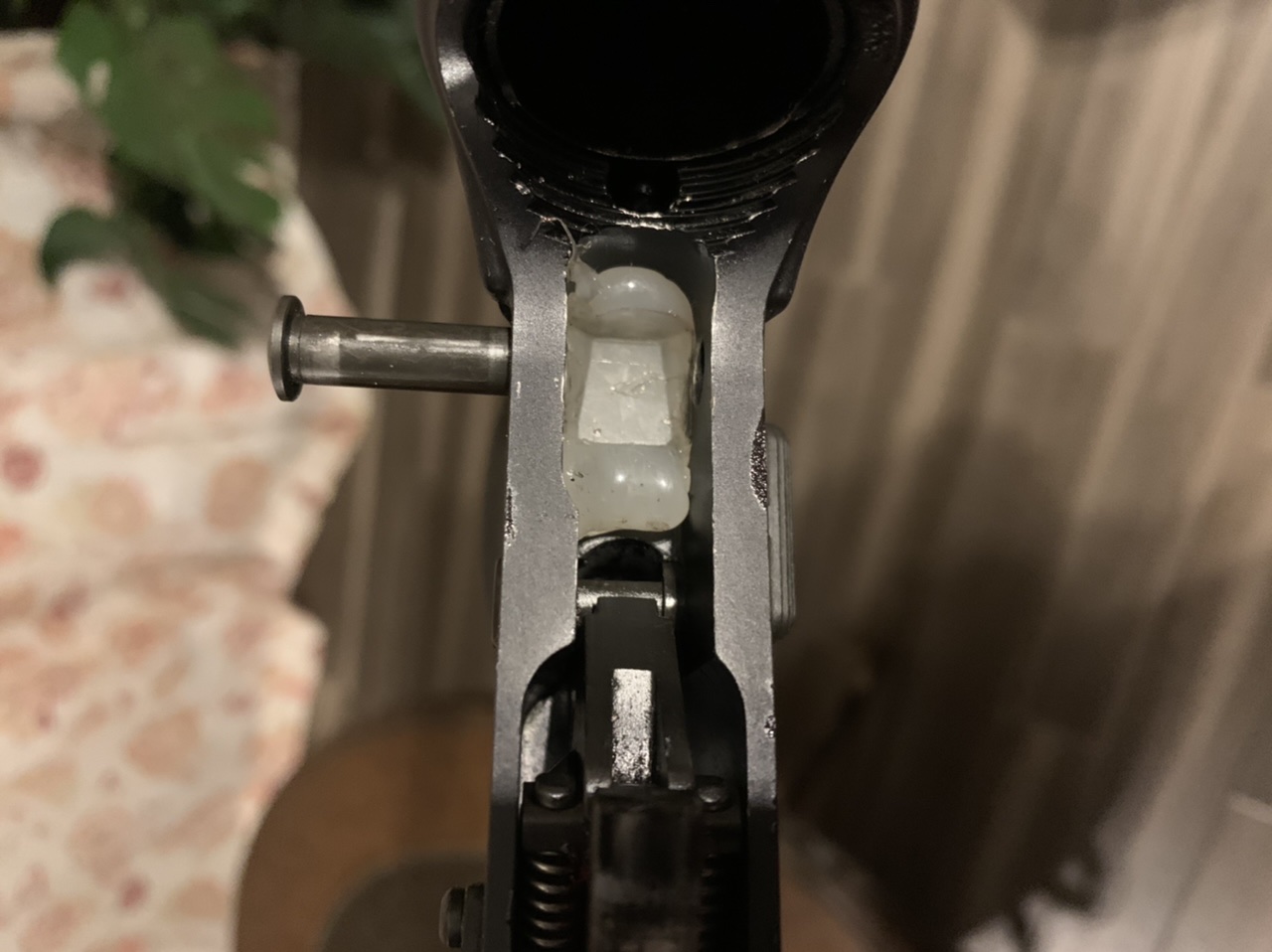

Something I have started doing, and it seems to help, is squirting hot glue into the lower at the rear take down pin. Squeeze the upper and lower together and push the pin in. Cures most, of not all, of the receiver slop. Definitely makes the gun feel a lot better.
Reactions: sinister
