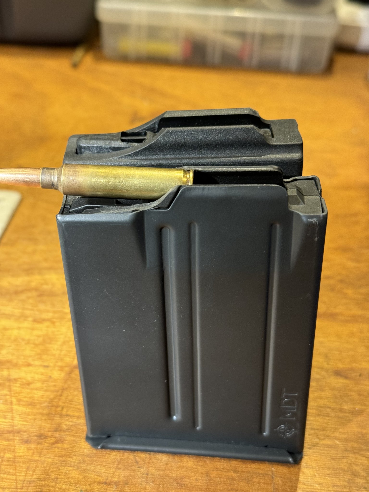

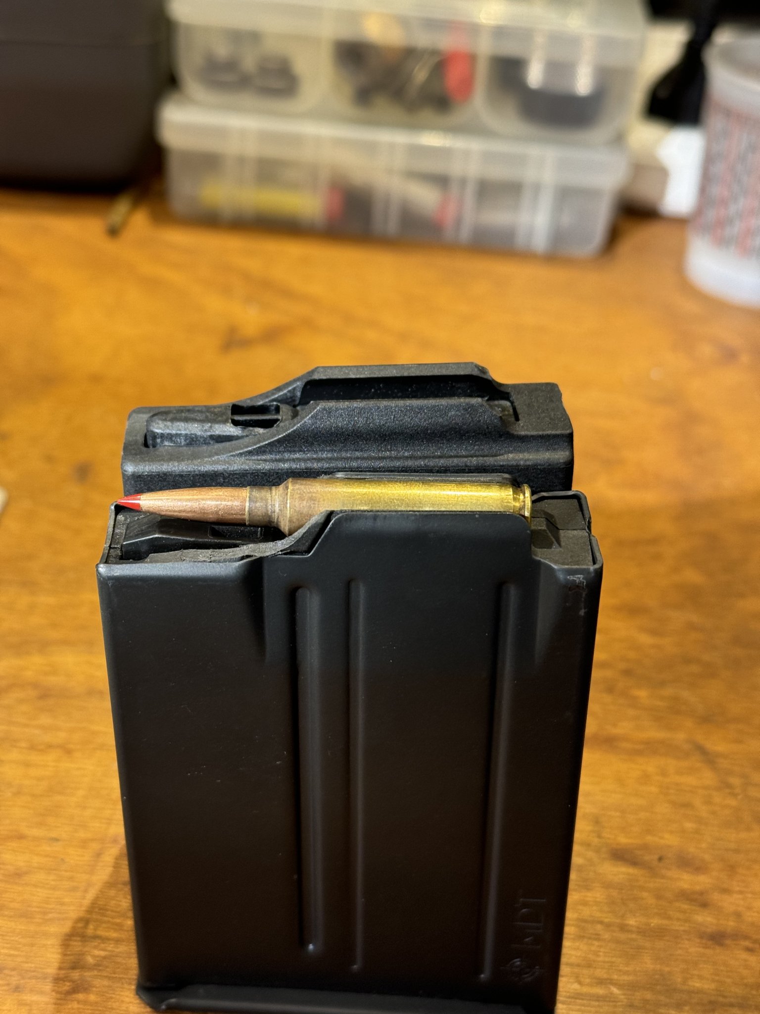

I have a 223AI CDG, currently in a KRG Bravo. I’m using the MDT magazines: https://mdttac.com/223/ both the metal one with the plastic insert, and the plastic one. In my experience, the key is tuning magazines to the action.
If you compare the plastic insert feed lips on the metal magazine extend further toward the front of the mag compared to the plastic mag. This causes the metal mag to hold on to the cartridge longer in the mag before allowing the cartridge to slide up the bolt face and align into the chamber. This is why the plastic mag is rated to feed 223AI and the metal/plastic mag is not (according to the notes on KRG’s website). I trimmed the metal/plastic mag’s feedlips back until they match the size/shape of the feedlips on the all plastic mag. I also trimmed the back edge of the magazine slightly to allow the magazine to seat deep enough into the bottom of the action to present the loaded rounds properly and engage the mag catch.
Both mags feed 223 and 223AI just fine now. 223 AI loaded with 88ELDMs seated out to 2.50” OAL.

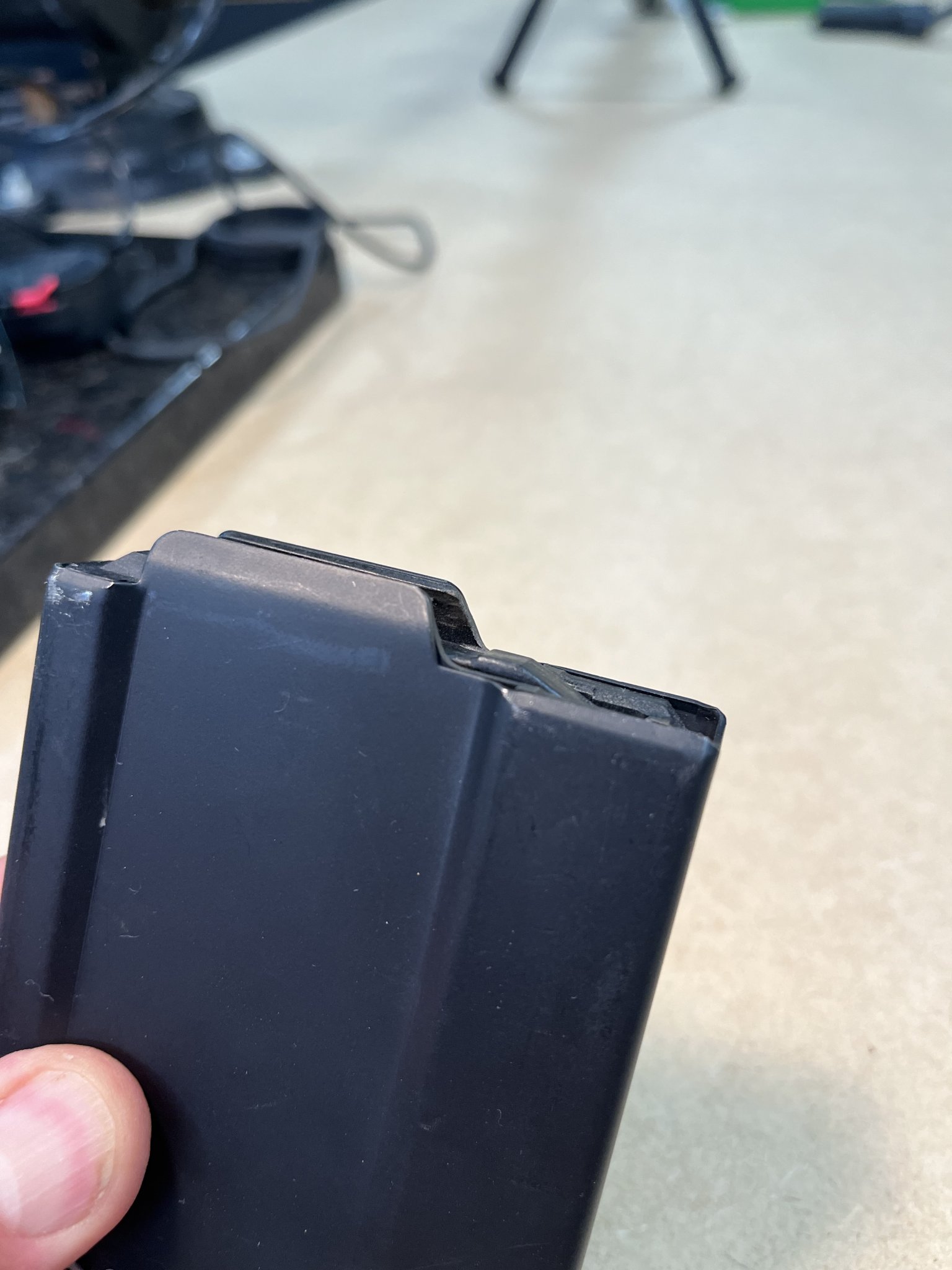

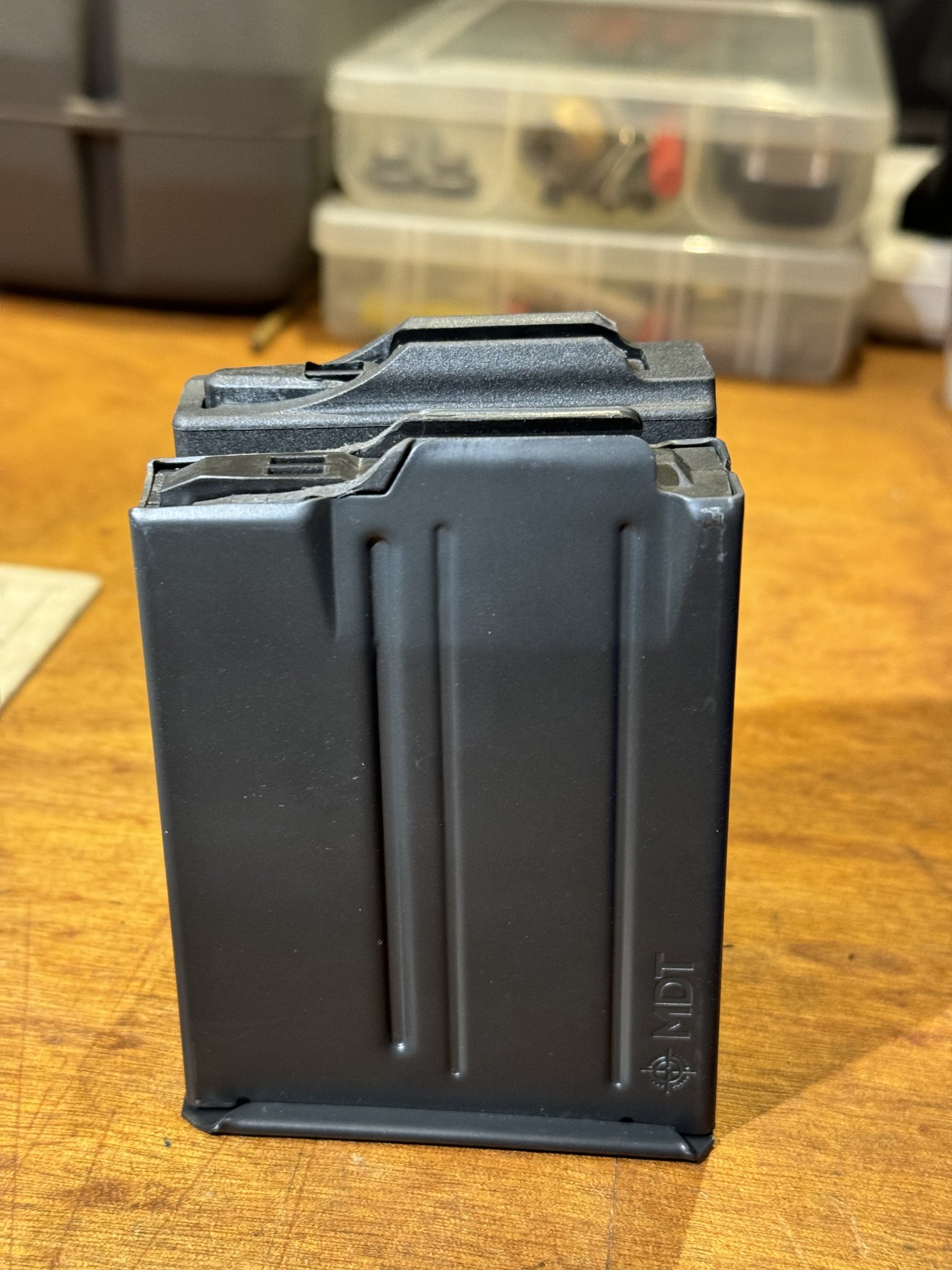

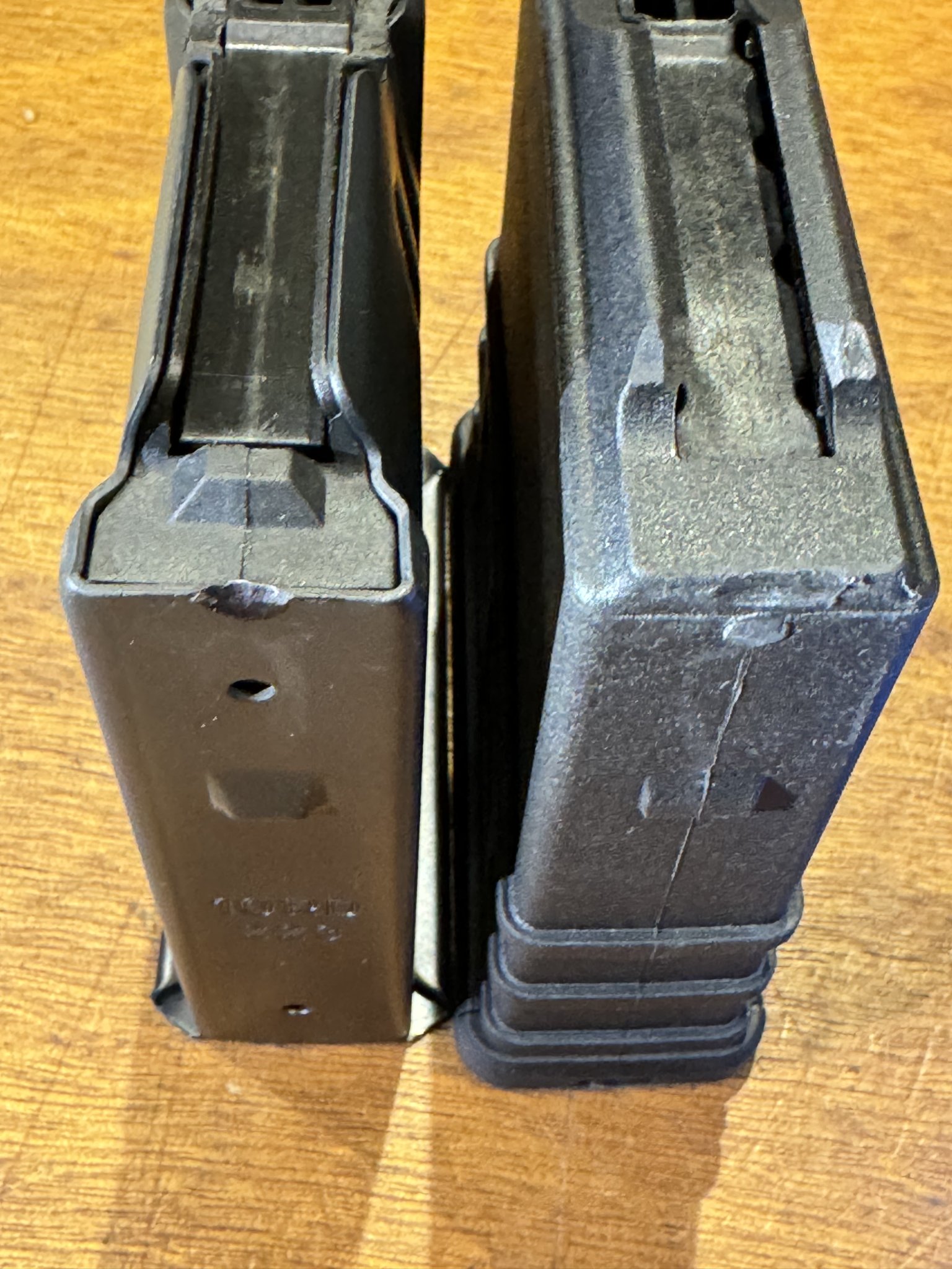

This is what I changed to the mags to allow them to function reliably in my ARC CDG.
Does this allow the round to come out and align more with the bore earlier?
Mine is coming in the chamber at a sharp and and dragging in the bullet.
Yes, by moving the front edge of the feed lips on the metal mag to the rear (by cutting them), the metal mag releases the round at the same time as the composite mag in the photo.
In the original configuration, the metal mag was holding onto the back end of the round too long, forcing the steep chamber entry angle to develop.
Reactions: Kadams1563
The plastic composite mag is rated for 223AI, the metal one was not. By modifying the mag lips as shown, the metal mag feeds 223AI just fine.

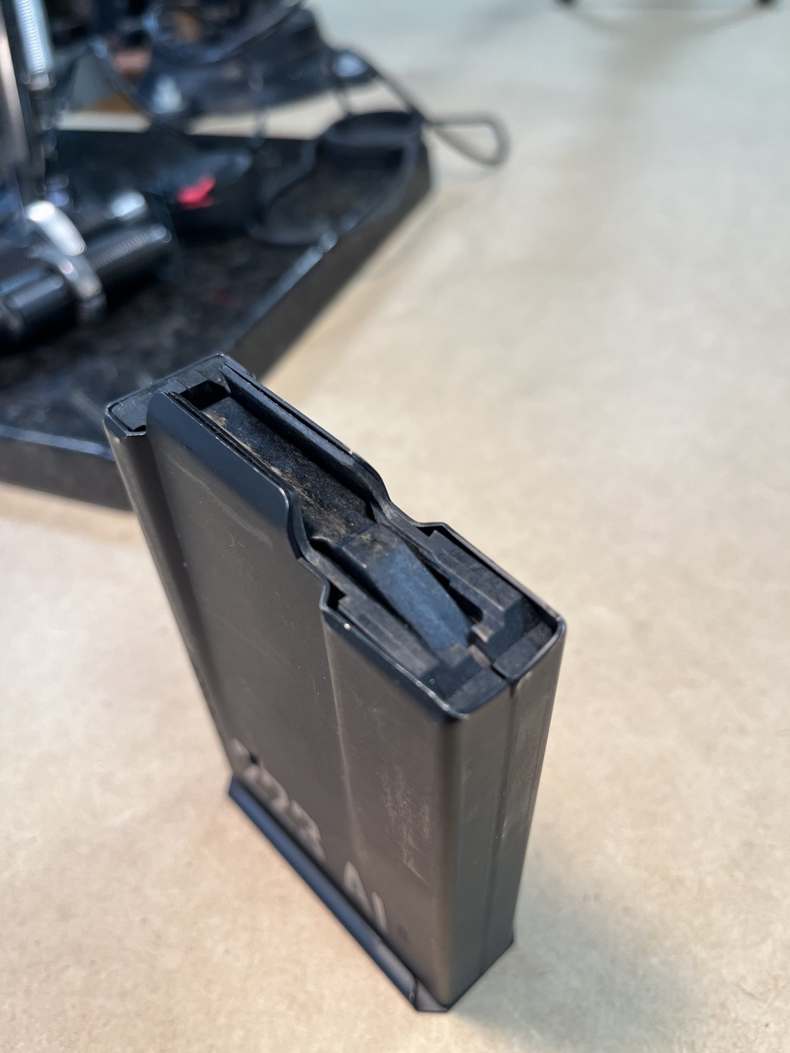

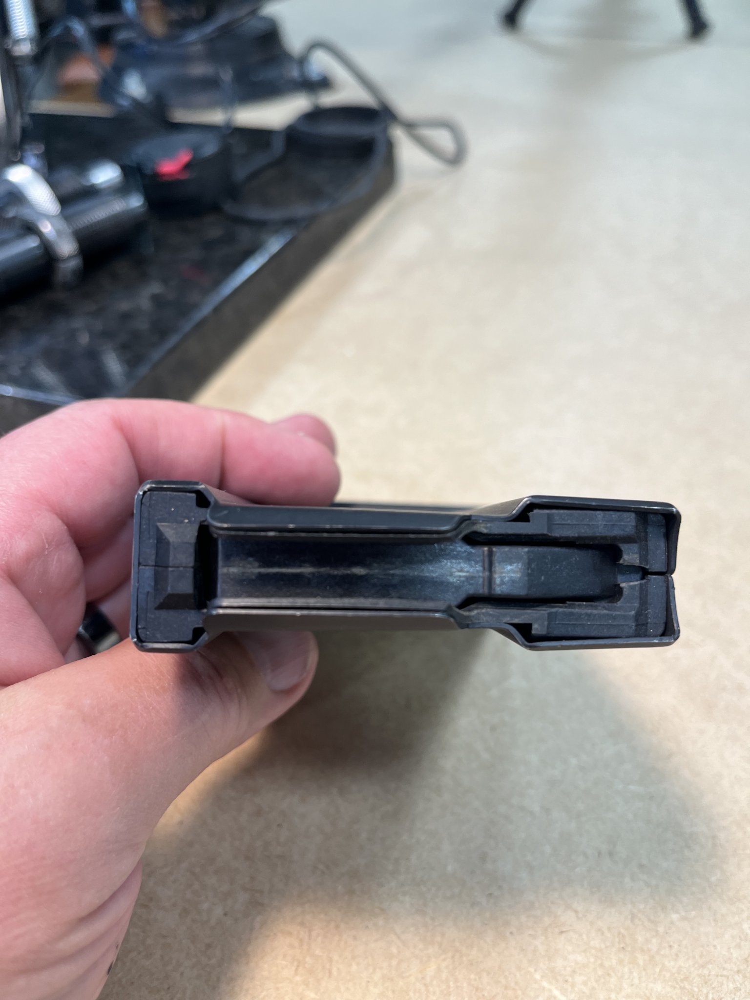

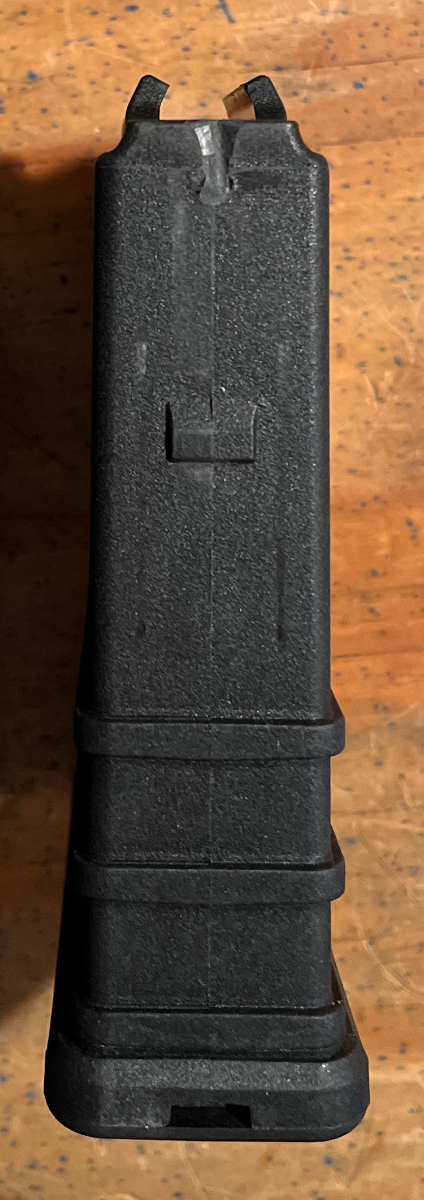

I had to modify the rear edge of the composite mag feed lips as shown in the photos. The rear edge was square, and the bolt body was snagging on the rear edge of the mag lips. By breaking that angle to a 45, the bolt rides over the mag much better.
