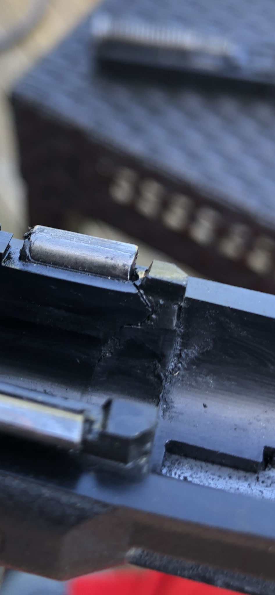

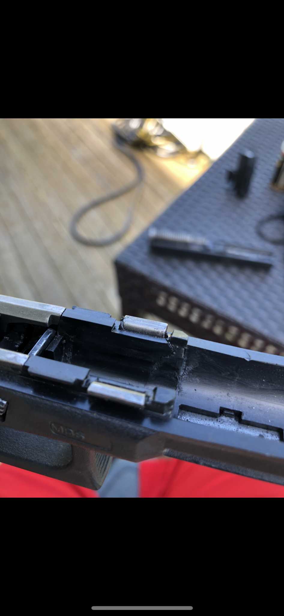

Hey guys wondering if anyone has seen or had anything like this before. Gun has low estimate of 20k rounds on it. Speer lawman 165 grain mostly. Glock 22 gen 4. Gun started to see Jams recently and then quickly turned into a jam o matic. Replaced everything chasing the issue, and saw this inspecting the frame. New frame with same magazines and slide and 1k flawless rounds. Not looking for a Glock vs xyz debate, I’m very happy with glock. Just looking to see if anyone else has had this experience and gain some knowledge here. Thanks guys 104556F0-7E75-42B0-A97D-4DD6F7FC9E1B.png8A15A1C1-B537-4212-A82D-53C21DF7D2B6.png
Thanks @Powder_Burns. Glock is making good on it. I guess more detail will help as well. I’m an armorer (new one) for my agency. 5 guns have gone down due to this recently, with 6 more on the fringe, and that’s only after looking at a small fraction of the issues weapons. We’re way past due for new stuff. It’s always damn near impossible to get money spent where you need it, and will be even harder now. Just trying to get more knowledge for the argument that is ensuing

Yes- Many Glocks have KB'd....
They had an issue with some Gen 3 and the steel frame inserts would crack... small batch of frames were impacted....
Any HP cartridge will wear the frame and components faster...
I have not seen this issue with Gen 3 and 180 grain bullets.

Hey guys wondering if anyone has seen or had anything like this before. Gun has low estimate of 20k rounds on it. Speer lawman 165 grain mostly. Glock 22 gen 4. Gun started to see Jams recently and then quickly turned into a jam o matic. Replaced everything chasing the issue, and saw this inspecting the frame. New frame with same magazines and slide and 1k flawless rounds. Not looking for a Glock vs xyz debate, I’m very happy with glock. Just looking to see if anyone else has had this experience and gain some knowledge here. Thanks guys View attachment 7348853View attachment 7348854

All Speer lawmen. Again not particularly mad or bashing Glock. I like Glock, ALOT. I know it can be abused and still go bang, and be accurate. Just wanted to get more info if others had any similar issues, as I knew I’d be talking to admin, and Glock regarding it. There was more than 1 frame that exhibited this. Quite a few along with frame rails breaking off etc.
Glock made good on all of the broken weapons , with them back in hand in 9 days from date they shipped out to them
we had quite a few cracked (they fixed promptly) with a huge # of them on the verge. Admin tried to get them to switch out all new guns to 9mm for free, but Glock wasn’t going for that.
I’m a Glock armorer... this is a known issue With the 40S&W Frames. Call into customer service and they’ll get you taken care of.
