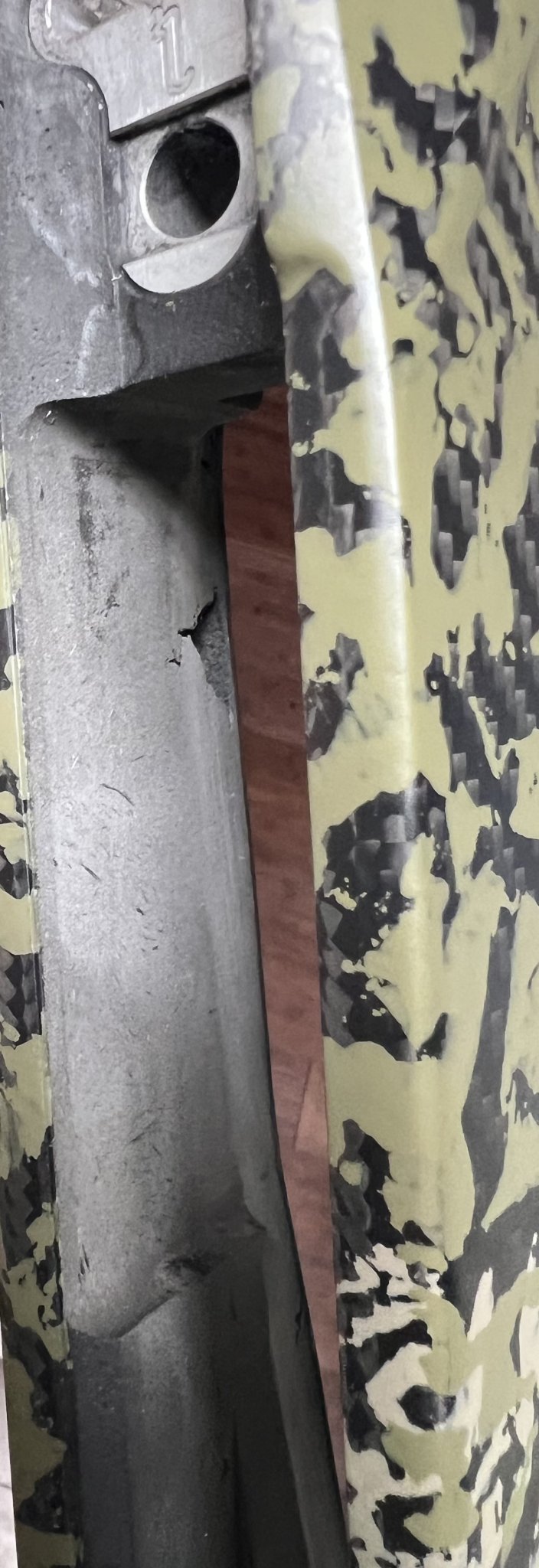

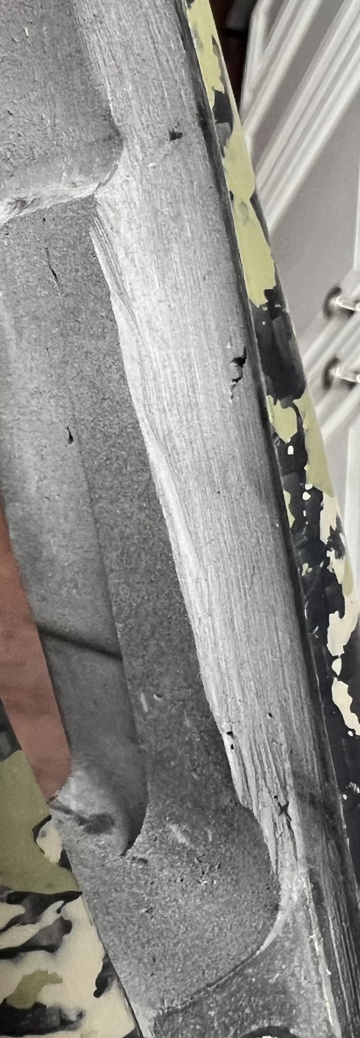

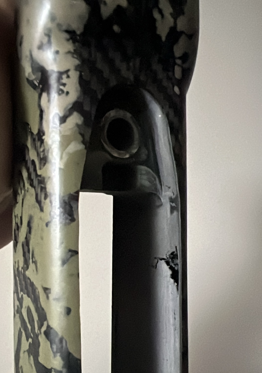

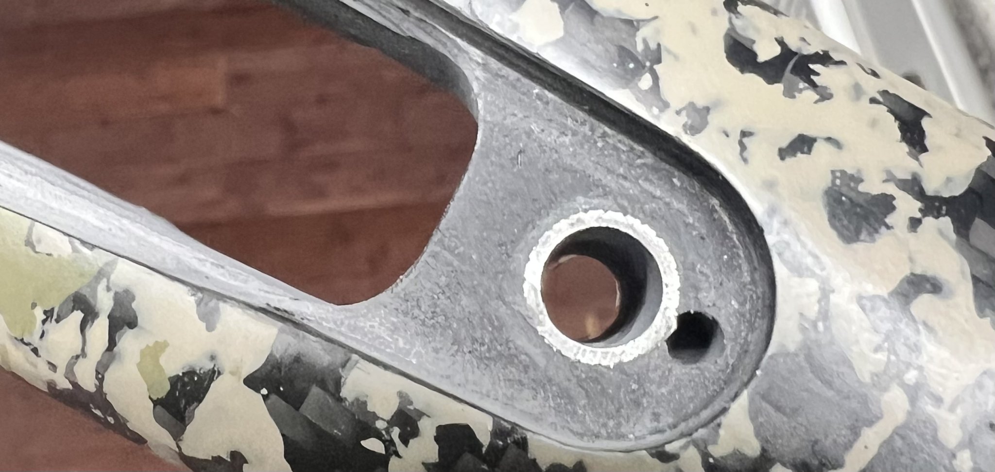

Had a well known smith open up the inlet for an Iota Eko stock for a Tikka CTR less than a year ago.
Noticed earlier in the week that there are multiple cracks and holes in the composite material on the inside of the stock. The carbon fiber shell seems to still be fine. But one of the holes goes all the way into the shell.
Waiting to hear back from Iota now for three days and I don’t have much hope. They didn’t sound too thrilled that a smith would have inletted the stock a little more. Customer Rep told me that he forwarded the pictures to their engineering team.
Really frustrated with the whole situation, to the point that I’ll be buying a Manners if I’m not happy with how this turns out. This is already a replacement stock because the first Iota Eko didn’t have the action holes drilled in the correct spot.
Stock hasn’t been bedded, just has factory pillars.
Would this be ok to bed the action and bottom metal? Or is the fiberglass material weakened and needs to be fixed a different way? Would this be a terrible idea to try and fix myself? Just don’t want to sink anything else into this.
Is this a problem caused by the additional inletting? Or a problem with how the stock was made? I really appreciate all of the help!

Were those area touched by the smith that did the inletting? Those look like voids in the fill material, not cracks. In other words, defects in the stock fill which were exposed by the inletting.
Yes, those are the touched up areas. Except for the circular hole near the pillar.
Assuming the stock does need to be repaired by Iota? Worried that bedding may come off due to other defects in the stock.
Were those areas touched by the smith that did the inletting? Those look like voids in the fill material, not cracks. In other words, defects in the stock fill which were exposed by the inletting.
Have whomever beds it fill the voids with epoxy. You should have no issues.
I am not seeing cracks either, it does appear to be voids in the fill

We use variations of high fill epoxies and it's more common than you think. It's almost impossible to use a filler of that type and guarantee that their are no air bubbles in the filler as it is being injected.

Good to know. Would it be better to bed the bottom metal first or the action? Or do the whole rifle at one time?
Those don't look like cracks to me either. The material left in those areas is so thin it's just collapsing. Fill those areas with epoxy, might have to open them up a little so you can fill it. Bed it and run it.

Those are 100% voids, not cracks and it wasn’t cause by your smith. They mold the CF shell and then the stock gets filled with a dense foam type filler as a second step which cures and hardens up to be inletted in another step. All the smith did was expose those voids. Is it an issue? It’s hard to say. I’d see what they say but personally I’d probably just get approval from them in writing to fill them with marine Tex, JB, or devcon and not void any warranties and run it. Or tell them you want the stock replaced with one that doesn’t have voids in the fill if they have an issue with you doing that. If you’re planning on bedding it you will fill them by default.
IMO it’s not a huge deal but it is on the stock maker.

If you're happy with the stock otherwise, it will be fine. No reason the epoxy shouldn't adhere. Like @redneckbmxer24 said, the person bedding should just prep them for filling.
Voids, saw little ones in mcm and manners. Definitely not a structural issue, but filling with a bit of bedding won't hurt either.
Decided to bed the action and bottom metal myself. It's far from perfect, but really didn't want to put another cent into this Iota stock.
Ordered the original stock from Midway and one of the pillars was off a good bit from the action screw hole. Iota offered to let me swap the stock for a different color and change the inlet to CTR. Replacement stock arrived and still needed inletting for the CTR bottom by the smith, which is what exposed the voids. Gunsmith had no idea about the voids because they appeared 9 months later.
