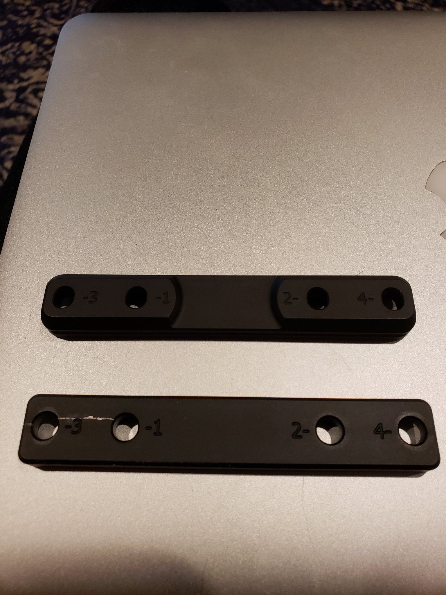

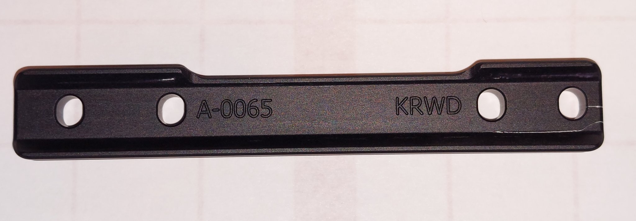

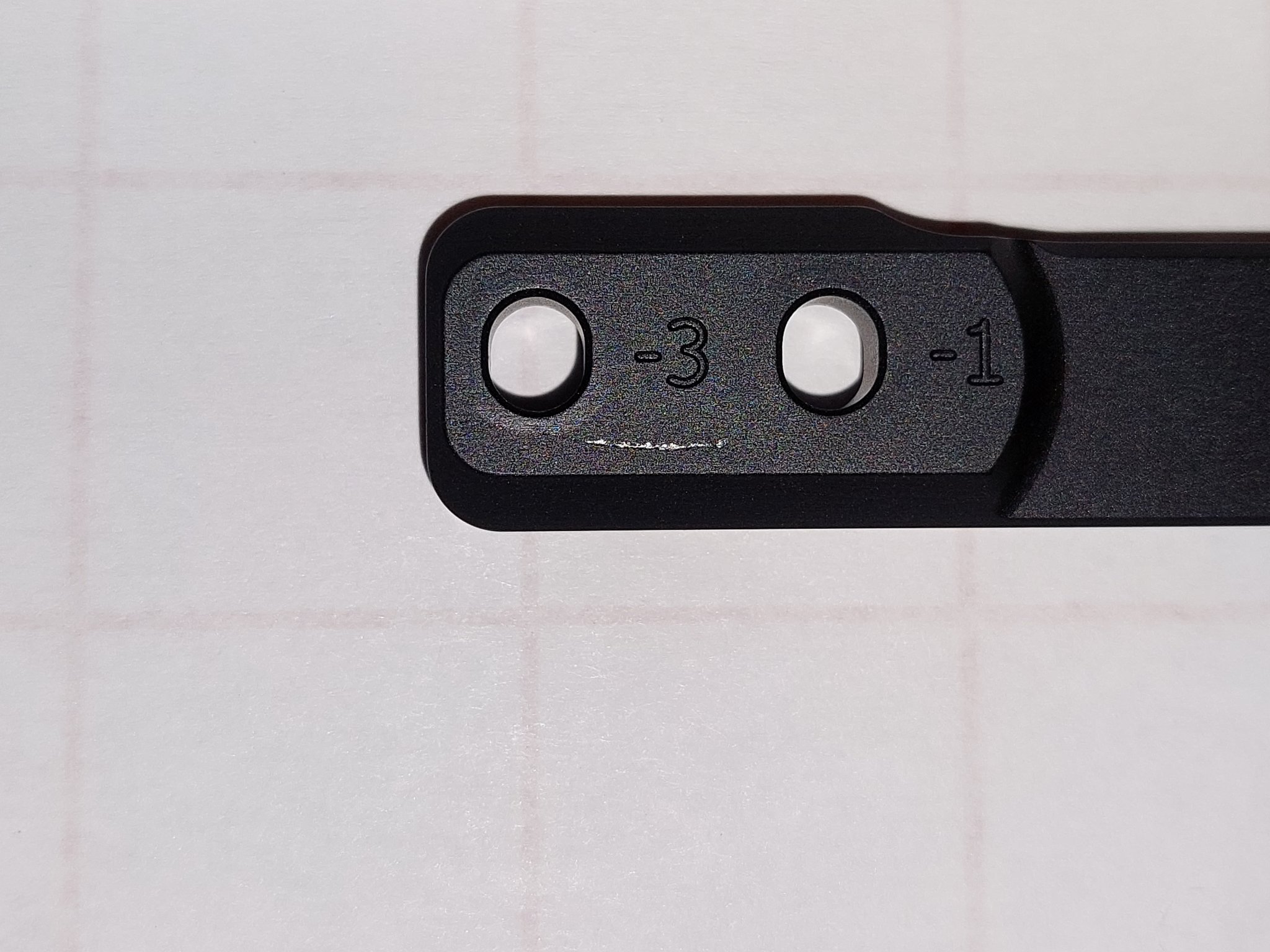

    Anyone have this happen?
    • Wow
    Reactions: Krob95
    Funny I just checked mine and I though I scratched it so I took it off and it was cracked across two of the holes. I think the holes in the clamp are offset to one side when they should be dead center of the screws.
    Appears to be quite common. They have excellent customer service to get it it sorted though. The replacement part is a lot beefier around the screws and has extra material.
    Ditto @clubsportmark. The new clamp is much better. It might have become a common problem but spuhr has a fix and mile high delivers it super easily. My interaction was so good, Mile High is at the top of my go to list. Excellent service. Excellent product. Thanks again to mile high and spuhr.
    Hmm, now I’m going to go check all of mine thoroughly. Not seen this before.
    Is this something that is a recent phenomenon? Most of my Spuhr’s are 3 or more years old and have no evidence of anything like this (3 out of 5 checked so far). Just looking at a 4003B, super thick and I’m trying to understand the torque required to cause this.
    Reactions: Enough Said
    On the clamp 40 in/lbs
    K. Only time I’ve seen this is when people torque them the same value as rings, like 60+. I have a few ISMS, never had an issue.

    The new clamp is twice as thick as the old one that cracked and I believe that solved that issue going forward. Spuhr even ask for the batch number on the clamp itself for their records , being active about their product.
