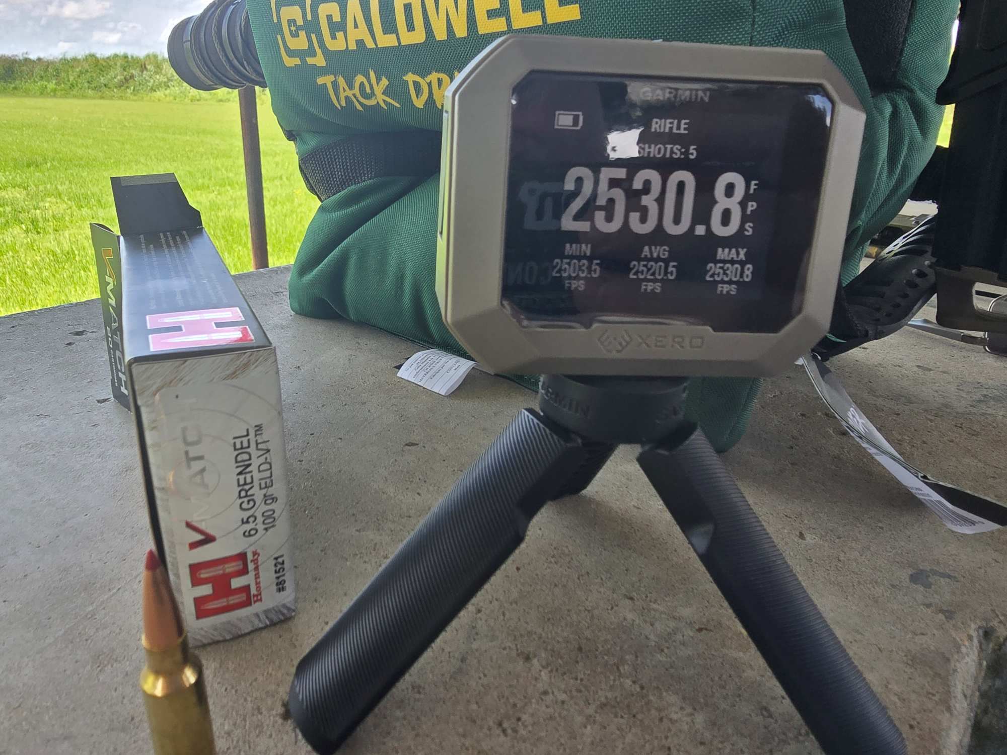

My plan was to use my 20X reference scope on all rifles, and then to see what ammo preference they had, and best possible 5 shot groups.

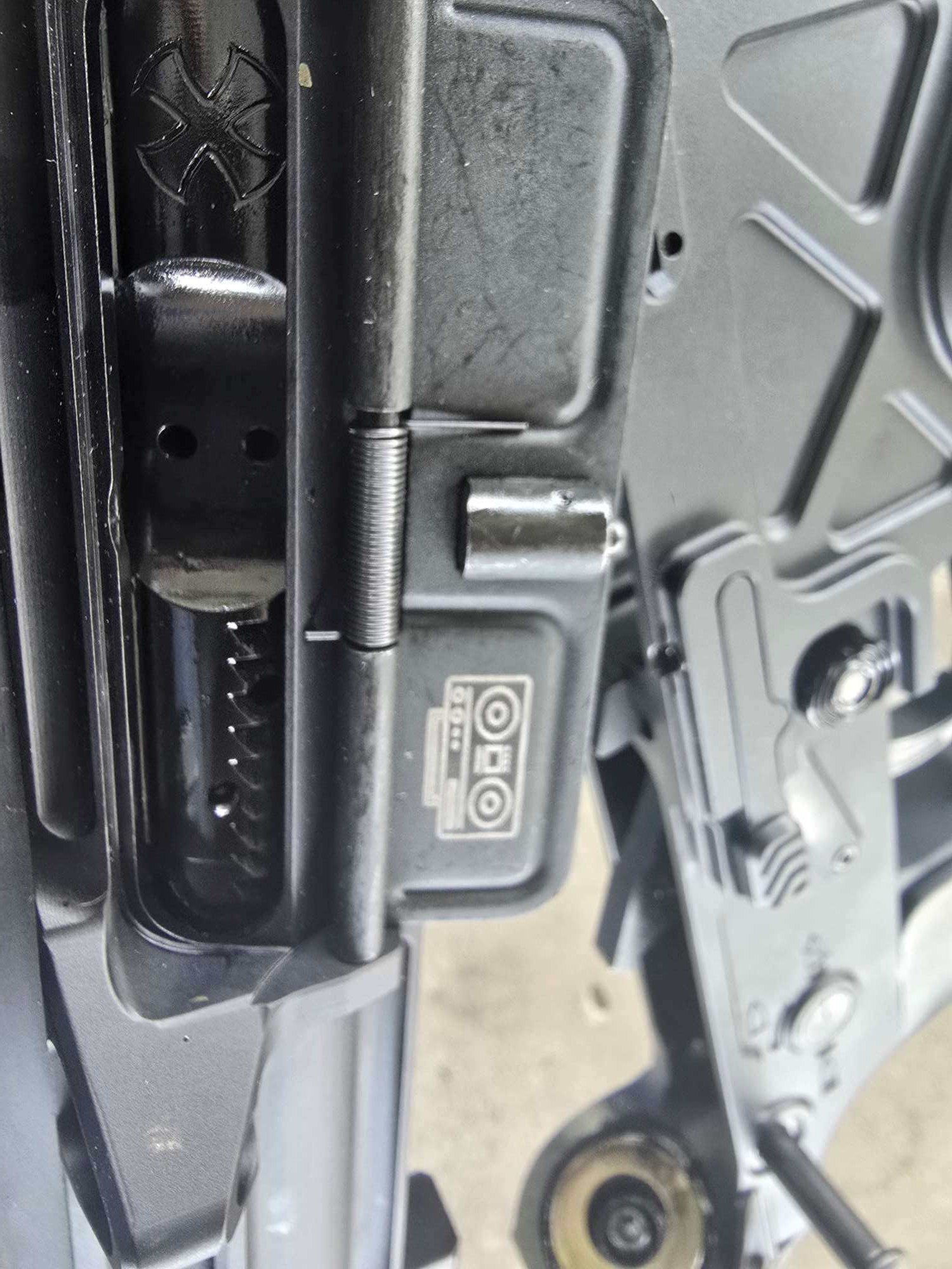

A long long long long time ago, before the wind, before the snow - Battle Arms Development gave me a store credit due to a couple things having some QC issues. I documented them, and the CEO of the company ultimately got involved and gave me the credit. I used it for a BAD matched ultralight receiver set and their proprietary charging handle, the RACK if I recall.

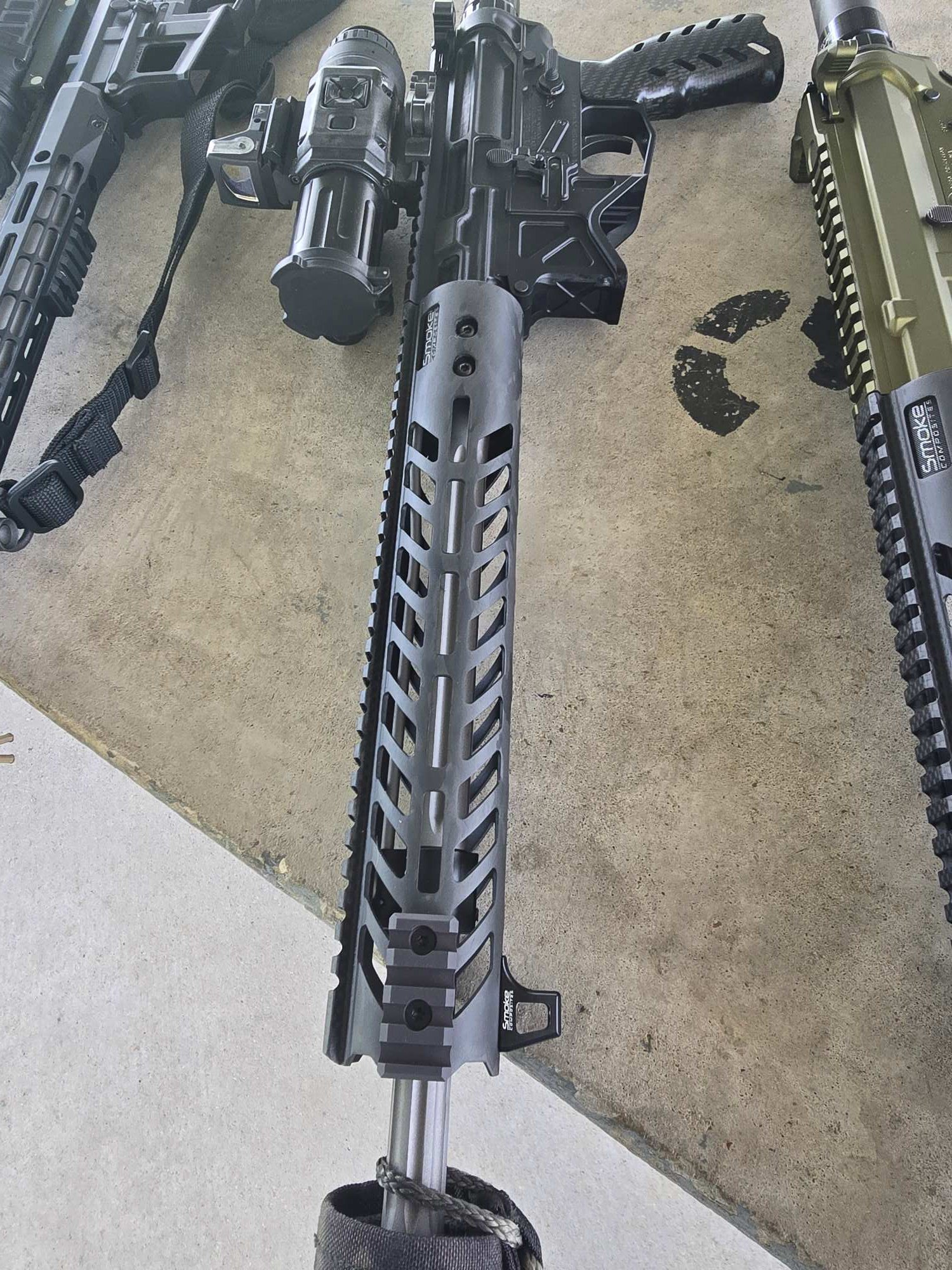

As seen, the dry Battle Arms build is 5 lb 6 oz. I think I could hit 5 lbs even but I used a JP Silent captured spring (2 oz heavier) , the 14.5" .750 fluted bbl vs .625 13.9" (~3.5 oz heavier}, USGI charging handle would be lighter, and a full mass BCG. I wanted the gun to be light but not at the cost of strength/functionally. I don't feel like there are any short cuts that compromise utility. With an optic, can, heavy but effective mirage cover and loaded she is 8.5 lbs. If I recall, the weight savings using the BAD receiver set is 6-7 oz and the Smoke Composites across the three components is another 6-7 oz.
