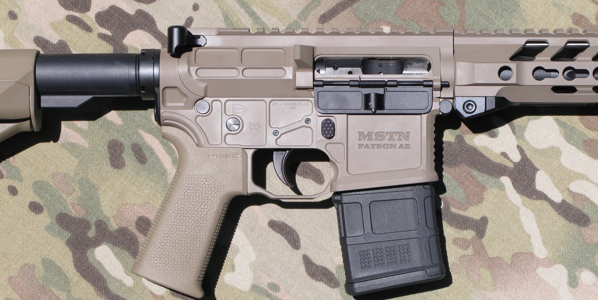

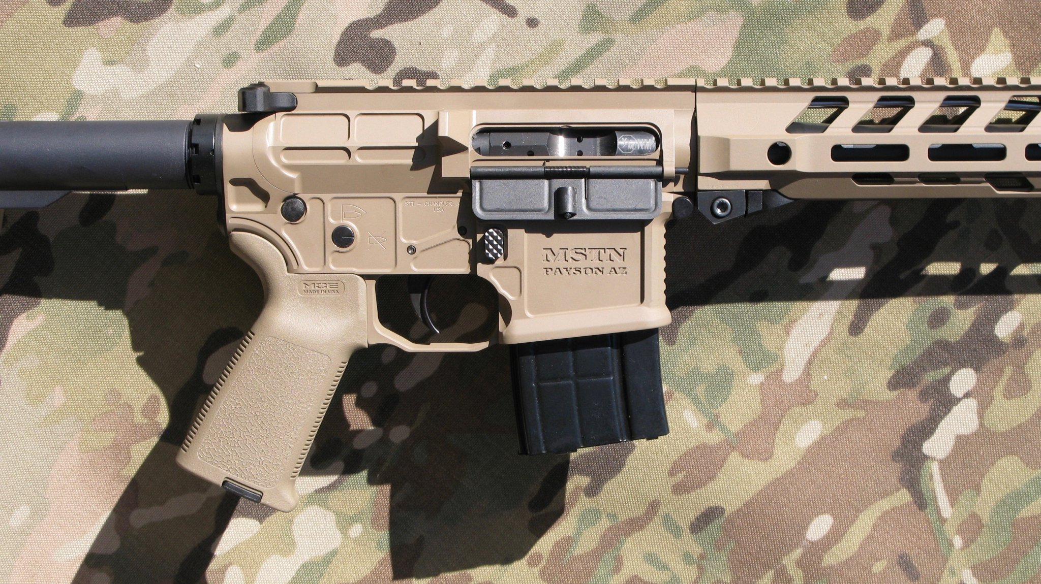

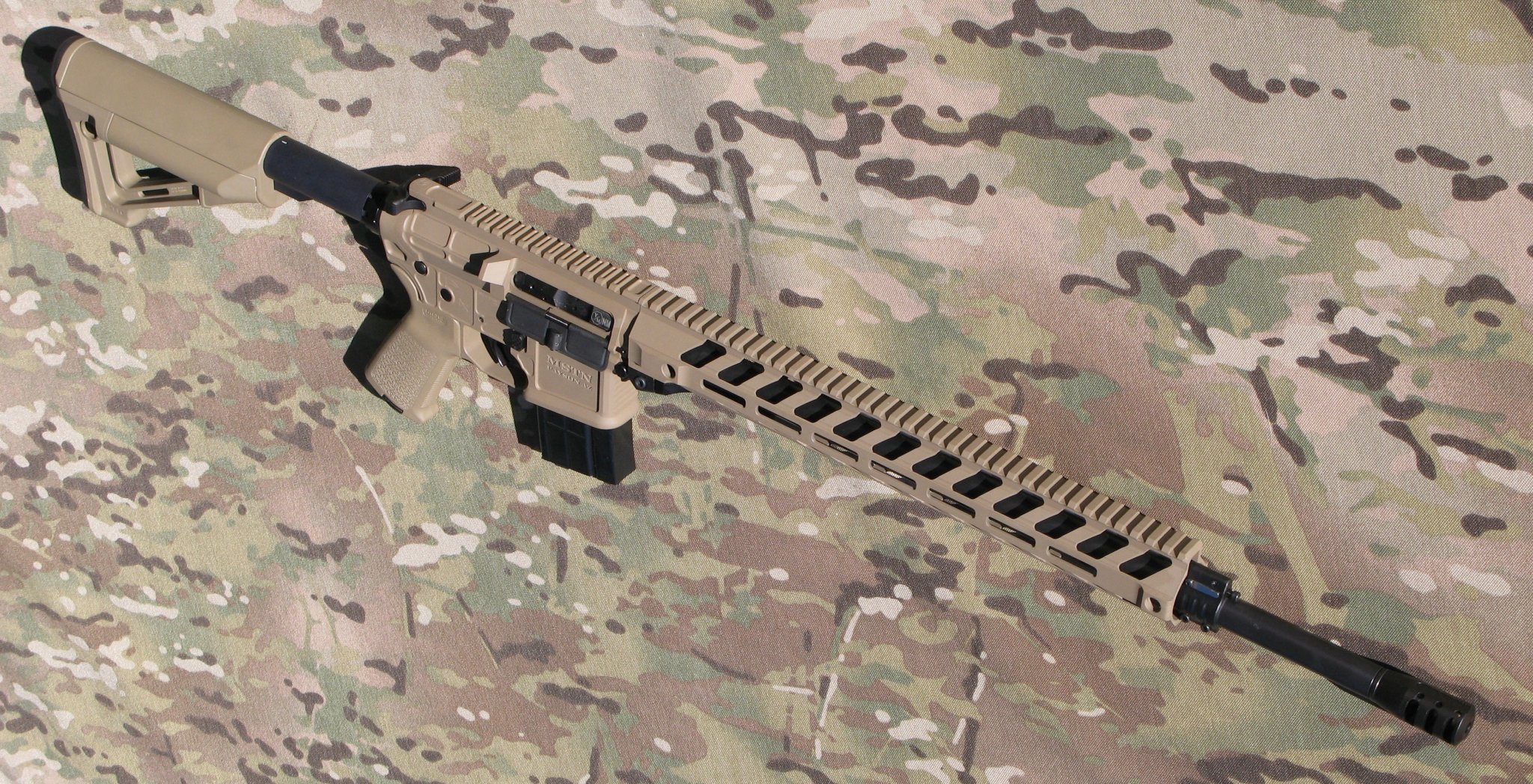

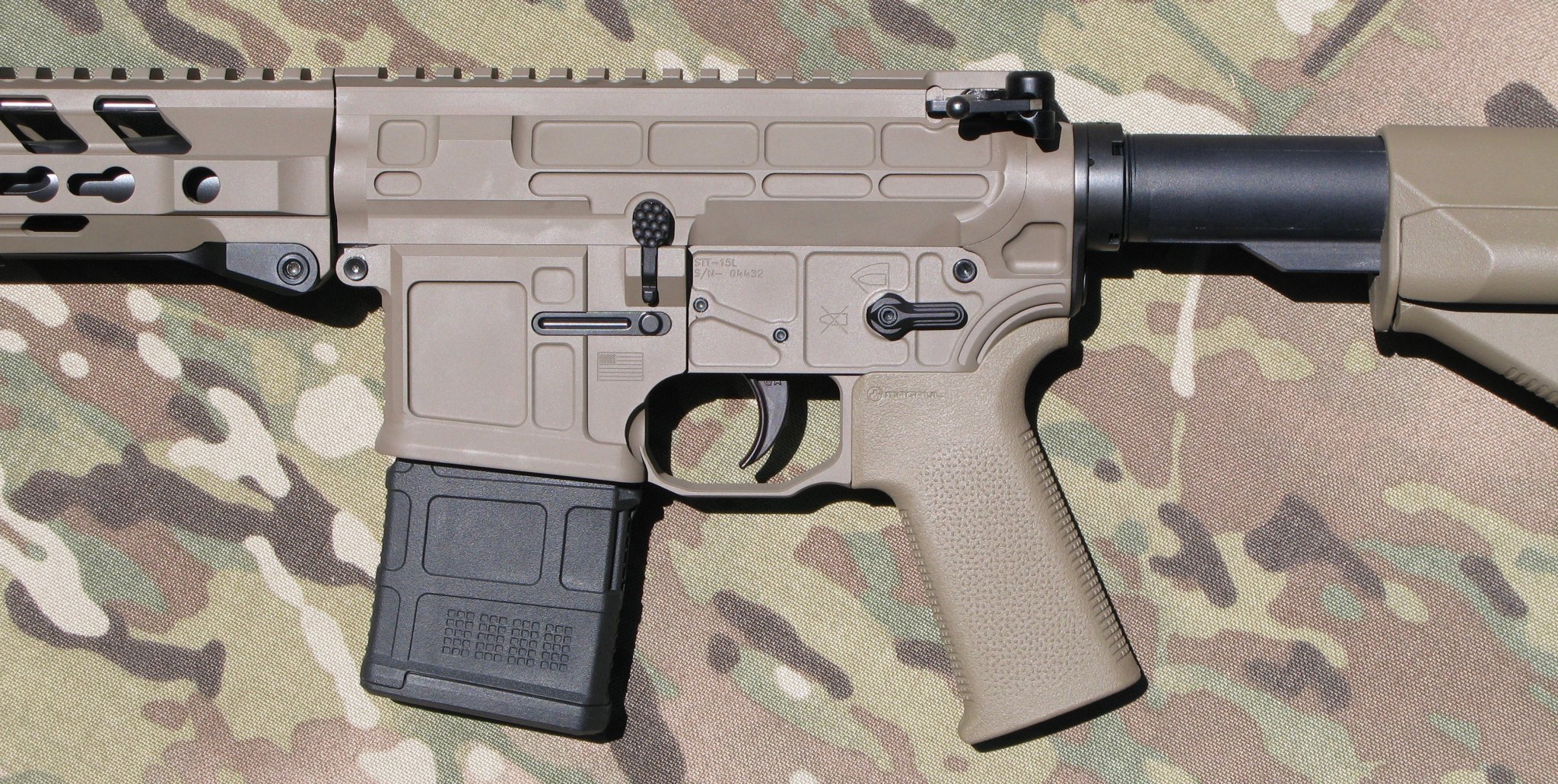

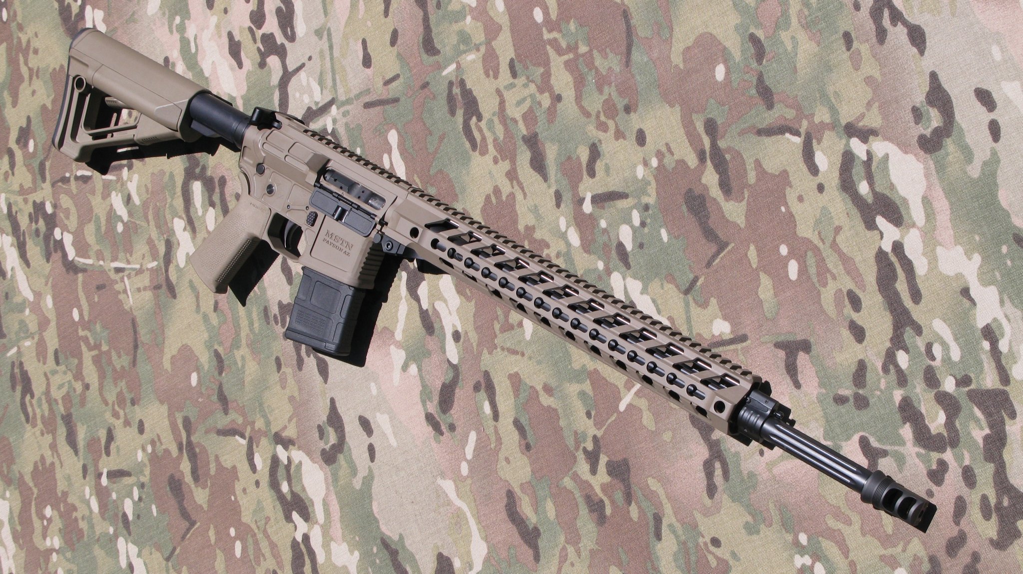

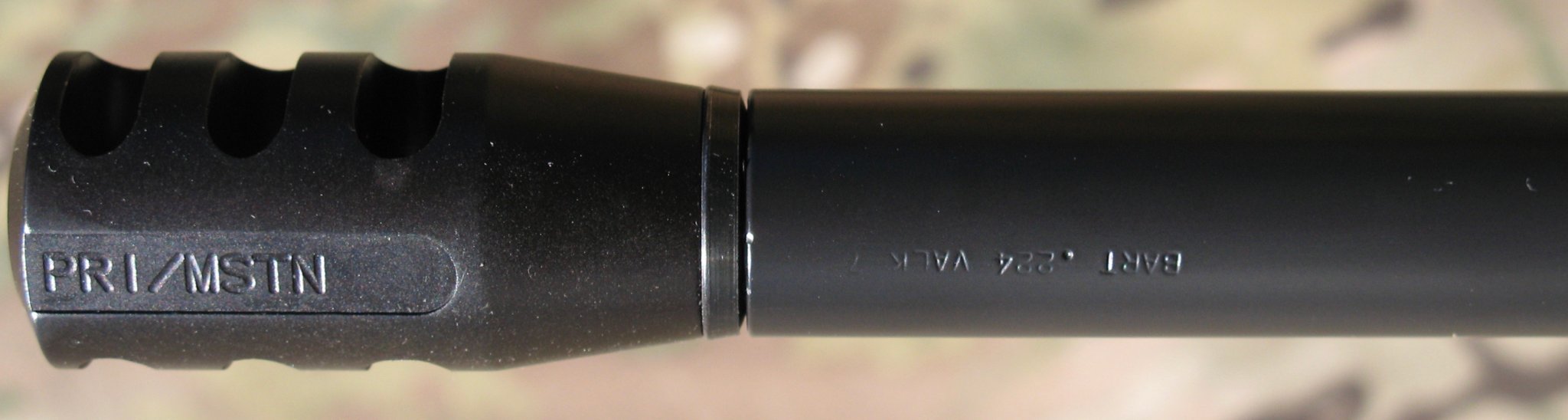

I've got a 20" 1x7 Bartlein barrel from Craddock in my personal .224 V. I'm getting 2690 fps from FGMM 90 SMK (SD 10 fps) and 2677 fps with Hornady 88 ELD (SD 14 fps) over an Oehler 35P chrono.
All my shooting is suppressed with a Thunder Beast Ultra 7 in .223. I'm using an SLR adjustable gas block.
Accuracy is a tad better with the FGMM, so far, averaging in the .5 - .6 MOA range for five shots. Some groups have been one holers in the .3 - .4 range, however. I've noticed accuracy falling off after 100 rounds or so. I believe this is due to:
Long bearing surface of the heavy bullets
Lots of powder being burned in that tiny bore
The Thunder Beast suppressor generating lots of back pressure

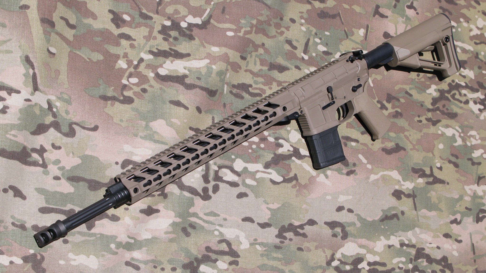

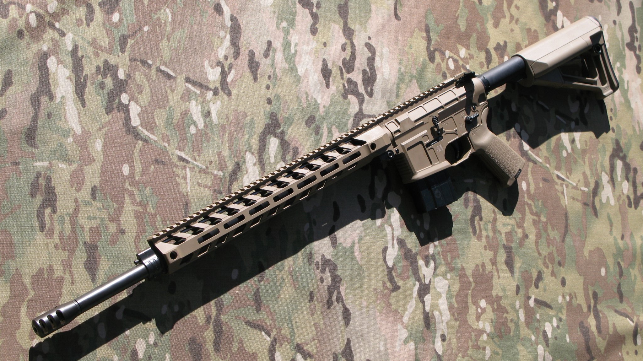

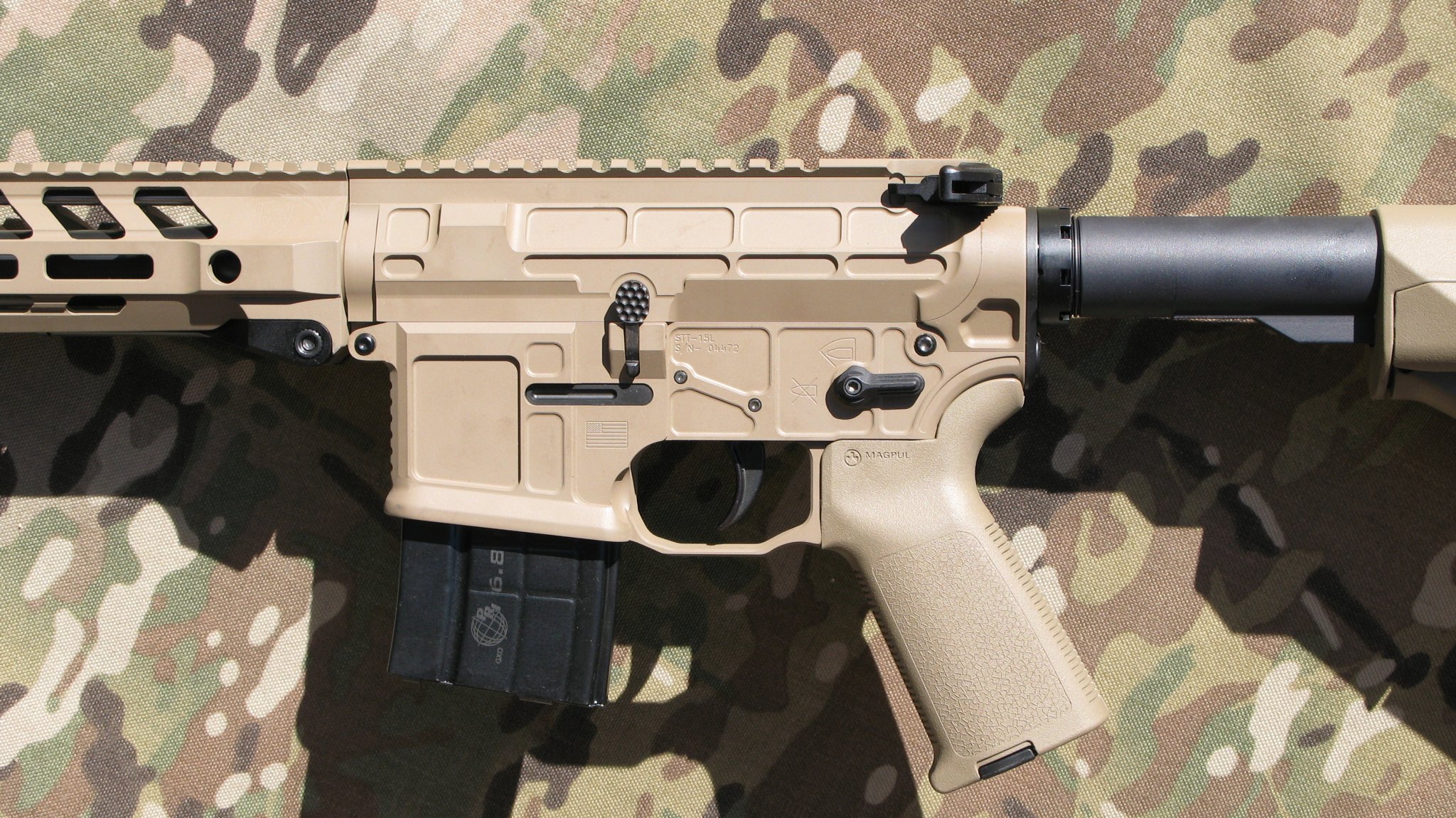

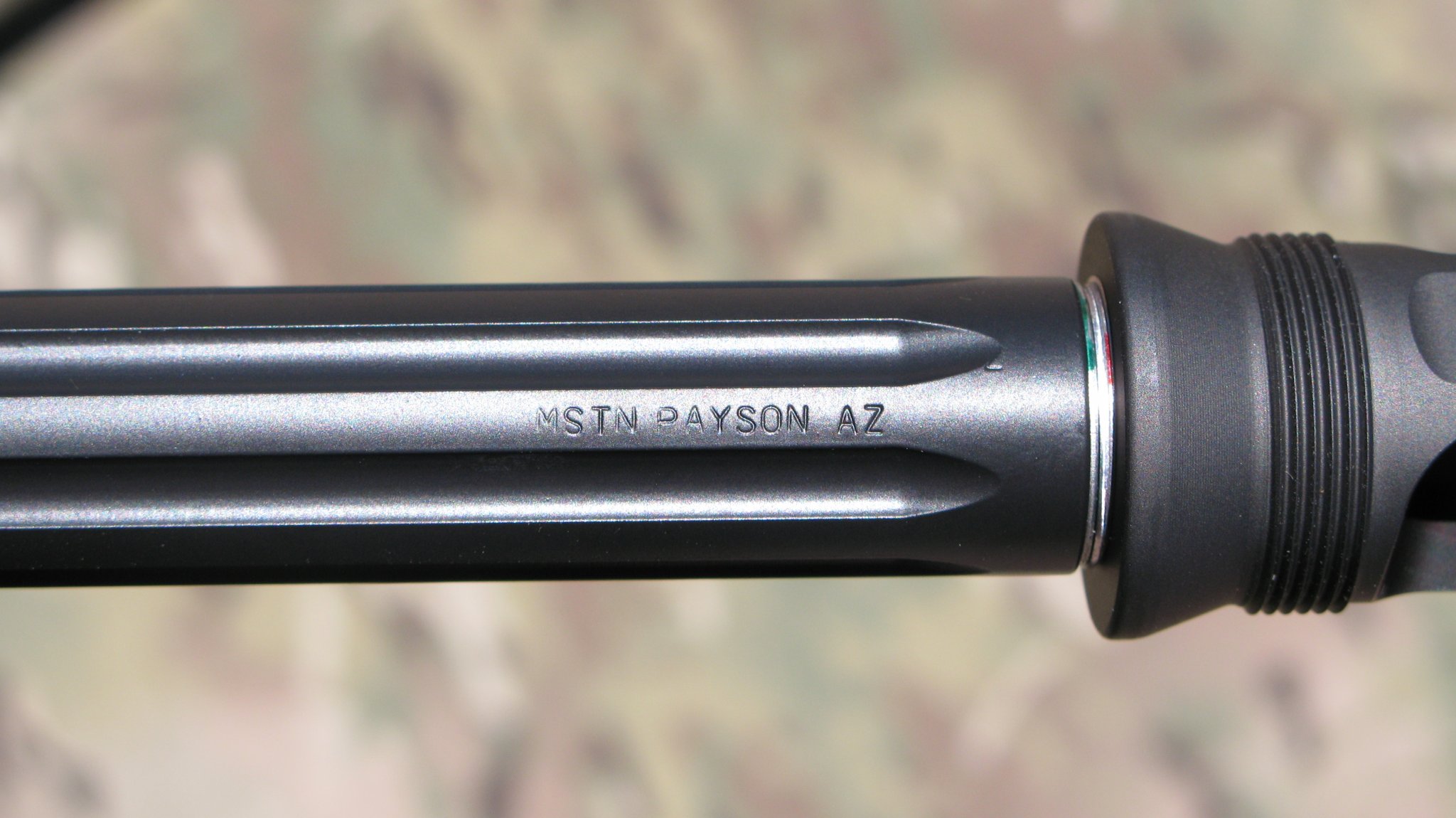

Pix of the rifle:
