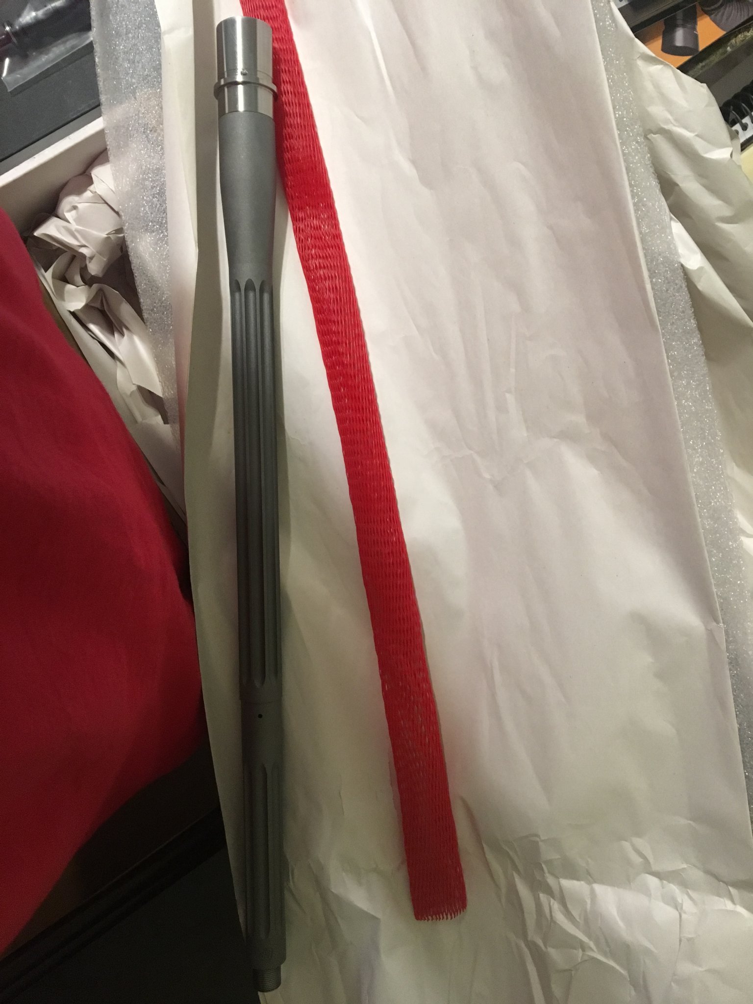

    Look at this beauty the wonderful Fedex fairy just delivered.
    20" .260 LH Gain Twist (8.75-8) +1 Gas system Bartlein.
    Next up some Cerakote and then to put it together! Paul Craddock Fuckin Nailed it.

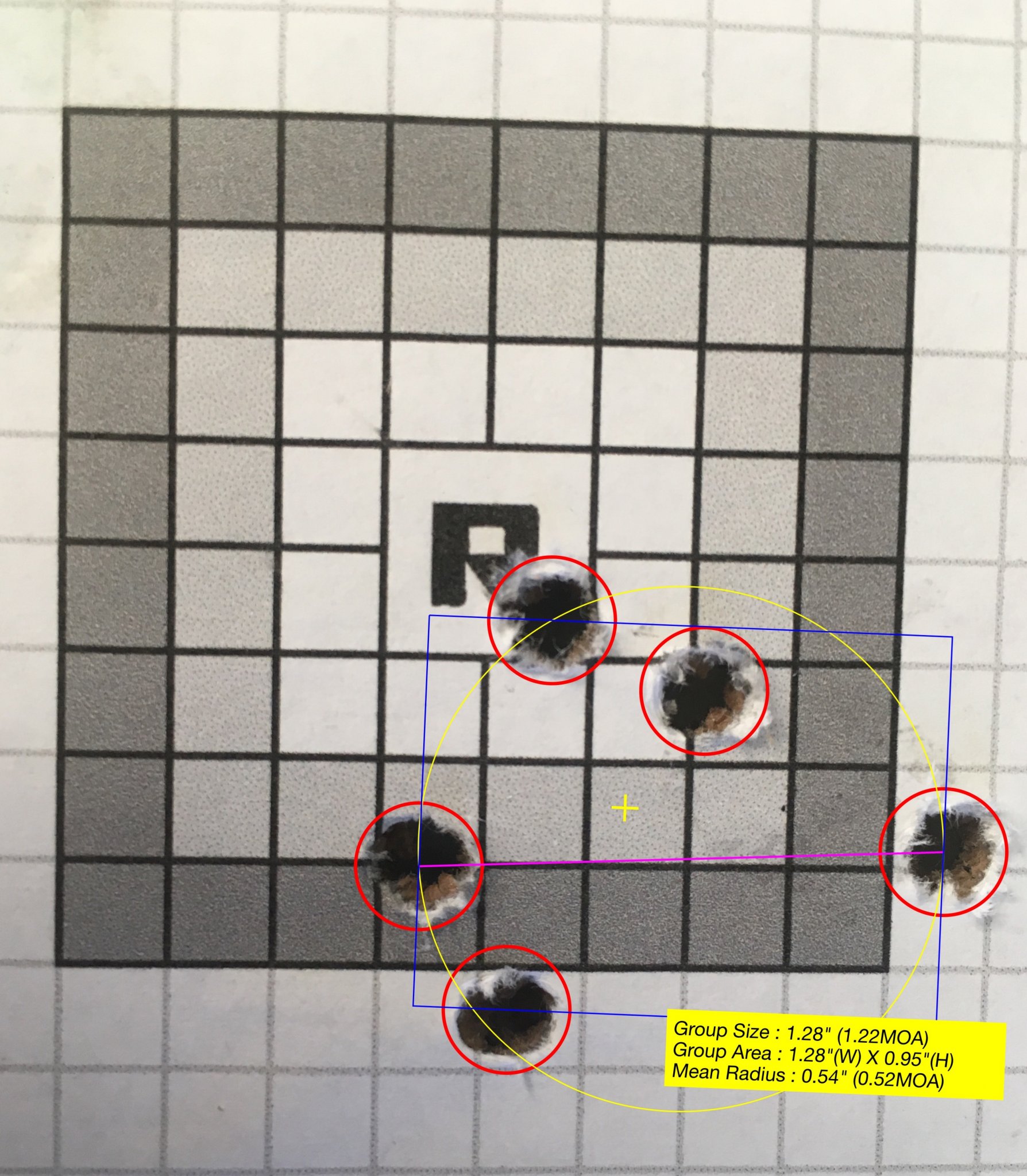

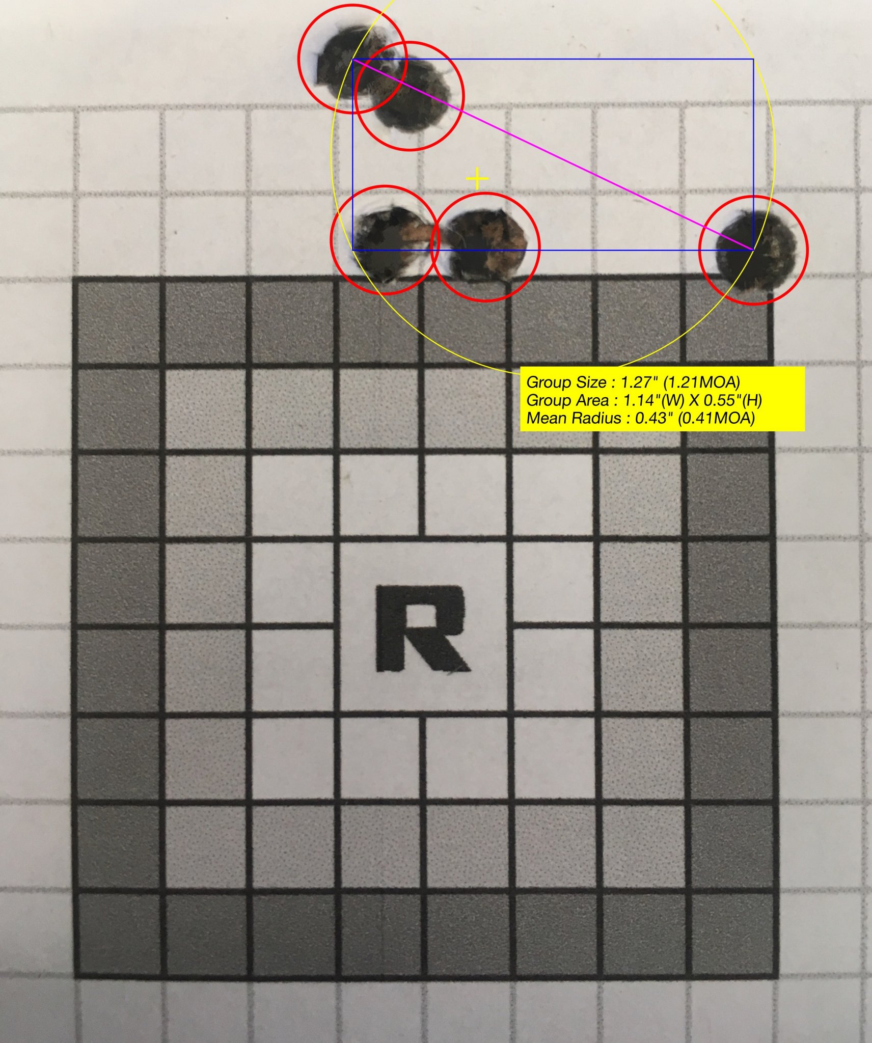

    Here’s some 55gr SIG EPA
    Even the LC M855 runs alright
    M855A1 is right in there too
    Of course FGMM 77gr is also alright but seems to be right on the edge (1/8twist) at 0 degrees.

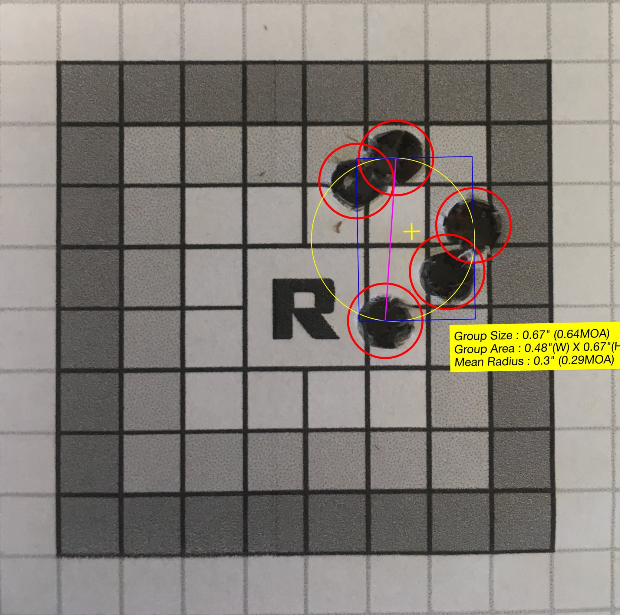

    took it out Sunday and shot a few old AMAX left overs 140s out of it. 41.5, 42, 42.3, and 42.5 H4350 which I got from here as good loads for the 22" barrel 6.5 semis,. I have also seen some at 40 and 40.5 . I was really hoping 42 shot well since I use it in the AI.
    Well they all shot well. 41.5 and 42 was my favorite. I ordered some brand new quality brass and will load up some elds and will take it out again very soon.

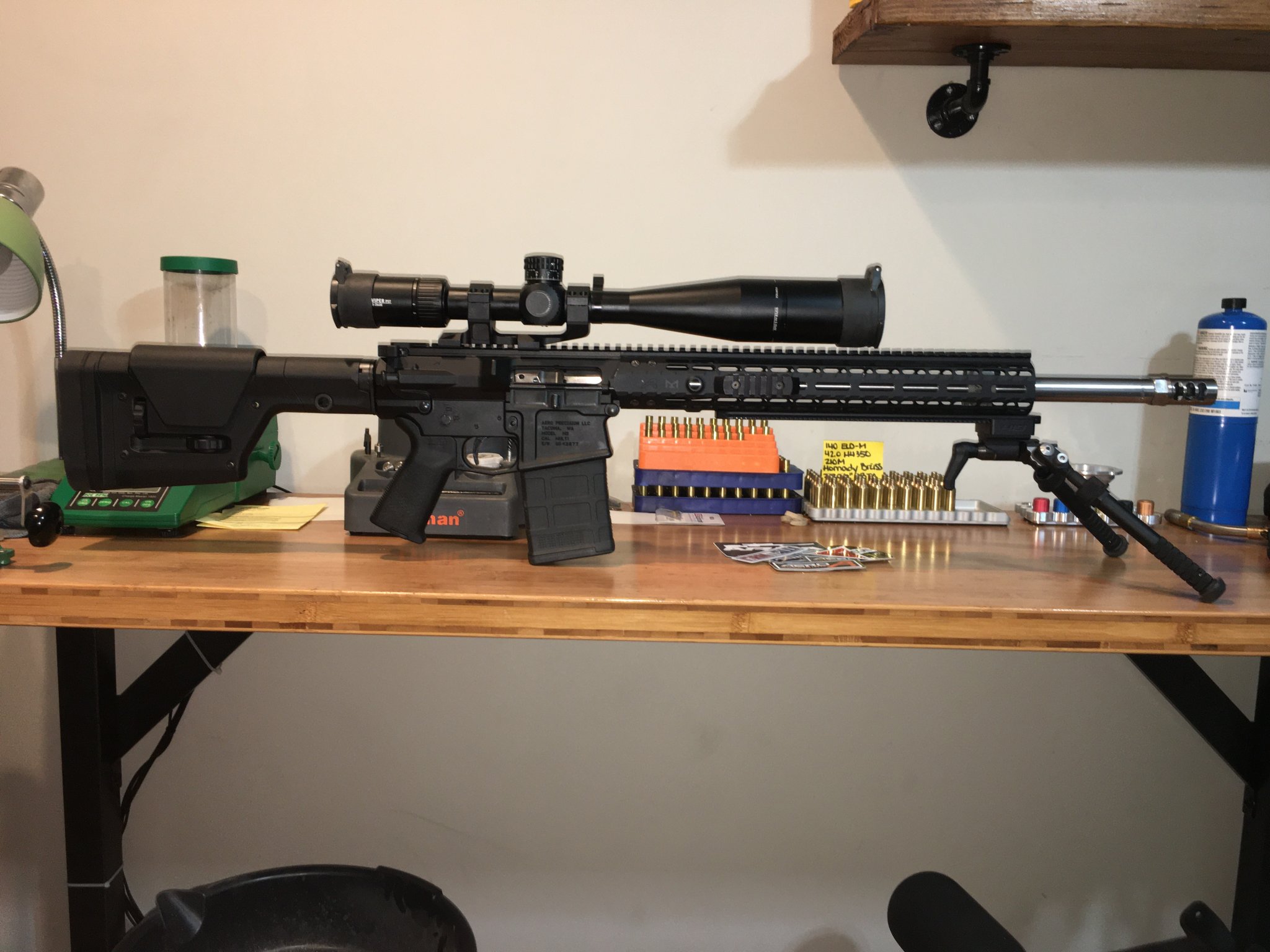

    DOnt get me wrong I like the SP10 and the GAP G2, but there is something extra special about building one up from scratch picking every component. I used Seekins new adjustable gas block with +2 gas and its wonderful.
