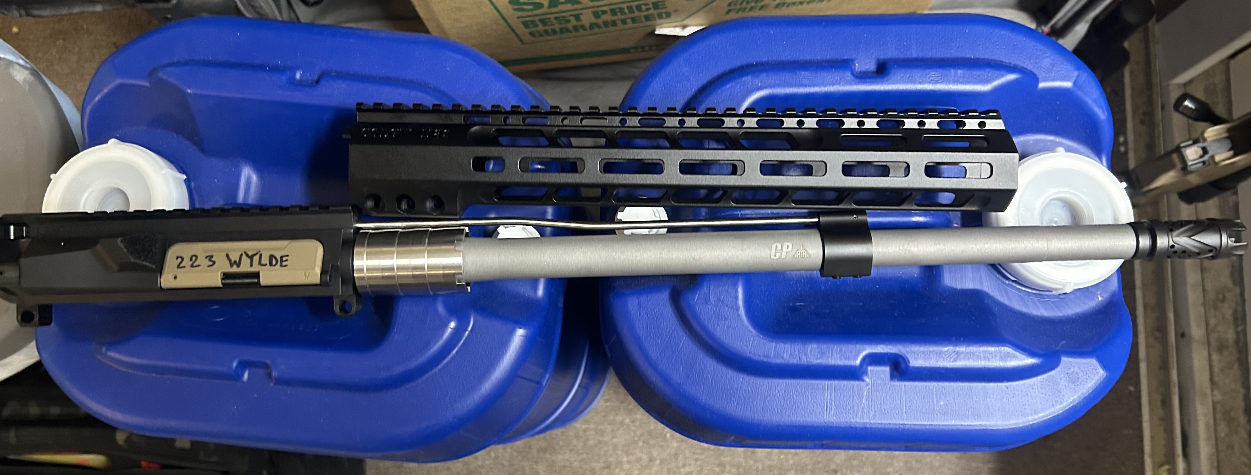

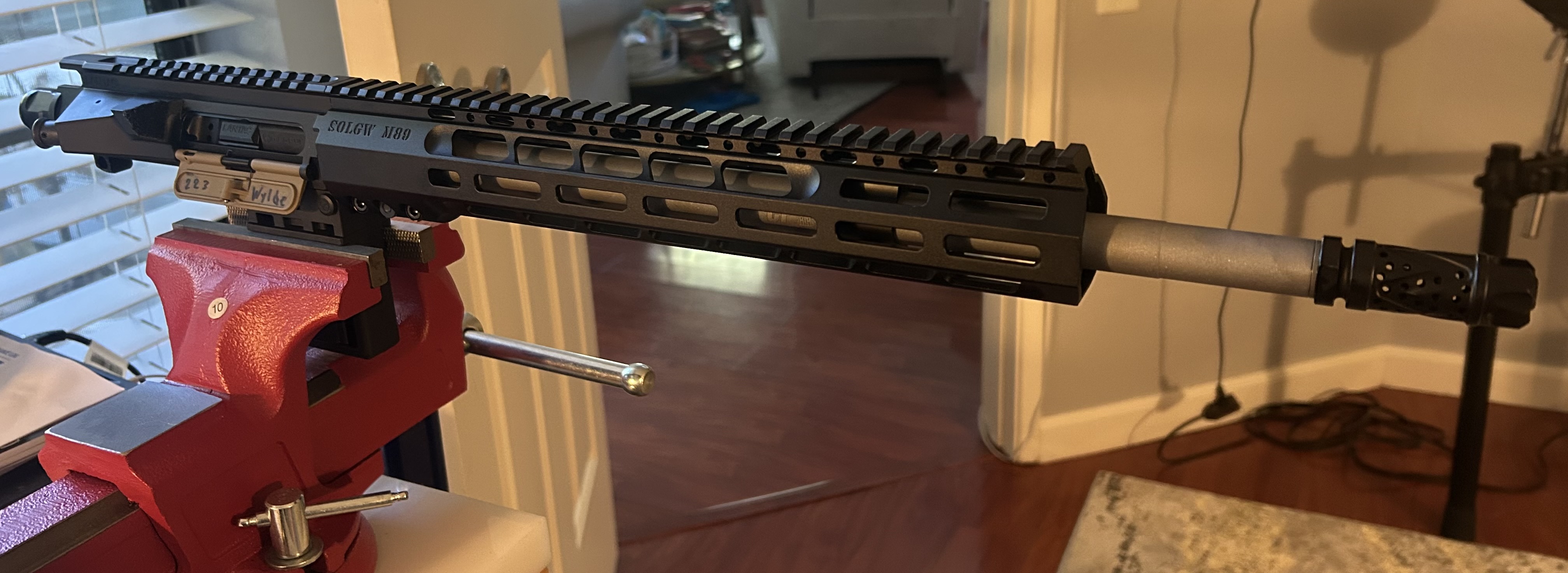

Figured I’d start a thread for a new build I’m working on. It will be based on a bead blasted RTR .223 Wylde 16.25" Mk12 Mod-H barrel with headspaced bolt & set screw gas block, SOLGW M89 13” rail, Lantac Billet upper (thermofit), Lantac enhanced bolt carrier, BCM MK2 ambi CH.
I’ll being using a different muzzle device than the one in the below pic. Currently waiting on a Cross Machine Tool Tactical Combat Flash Comp. Will update the thread as I put it together and load up some 77 smk’s for it in some ‘25 LC brass with a variety of powders.

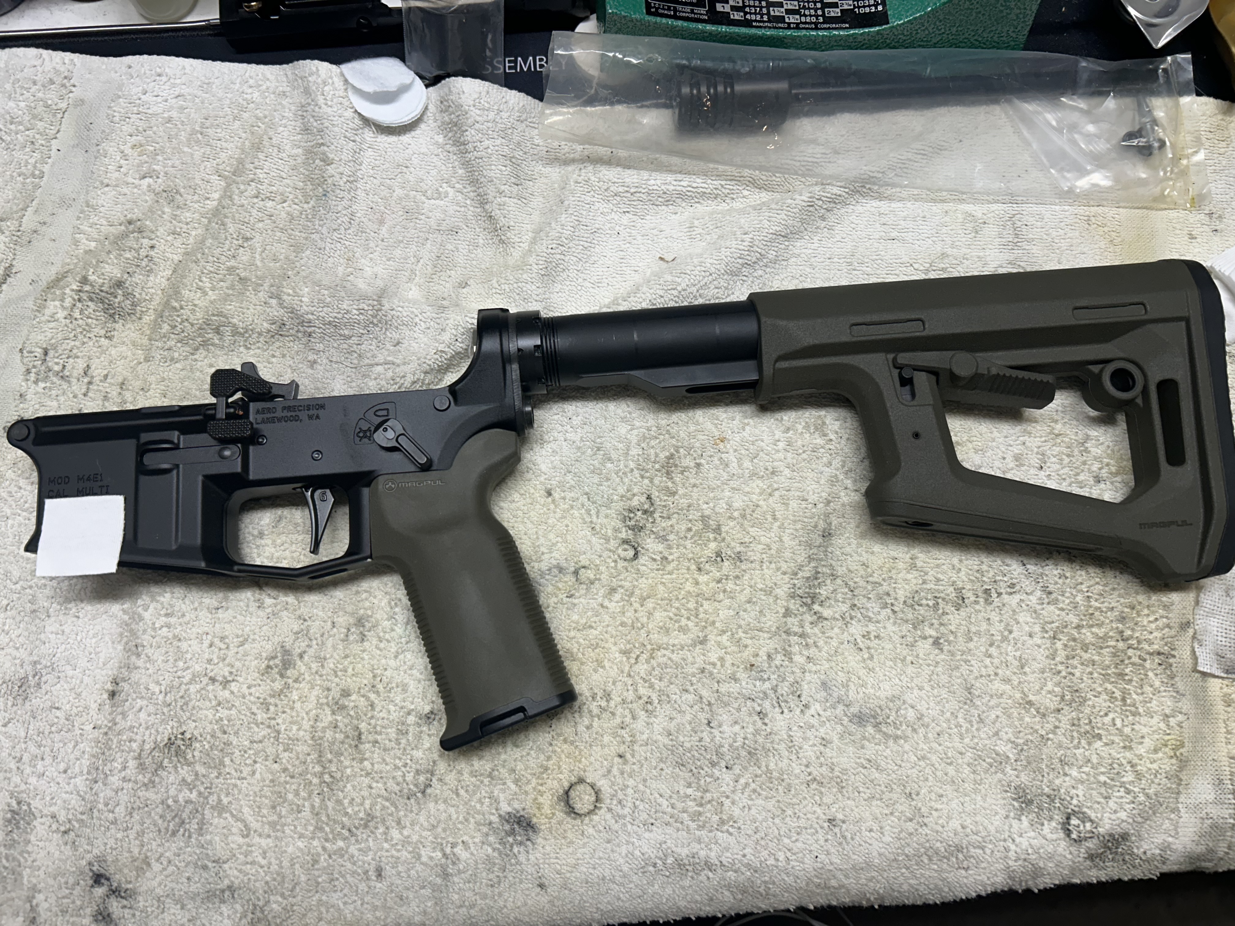

I will likely pair it with an aero m4e1 lower with geissele ssa-e x trigger, FCD safety, maritime bolt catch/release, geissele super42 buffer spring (h2 buffer), Magpul k2+ grip, and magpul dt-pr stock.

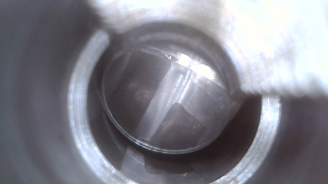

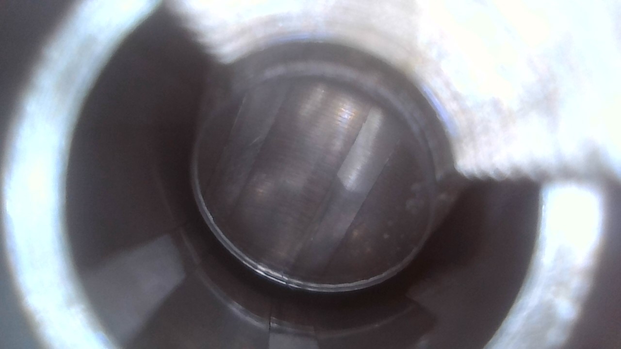

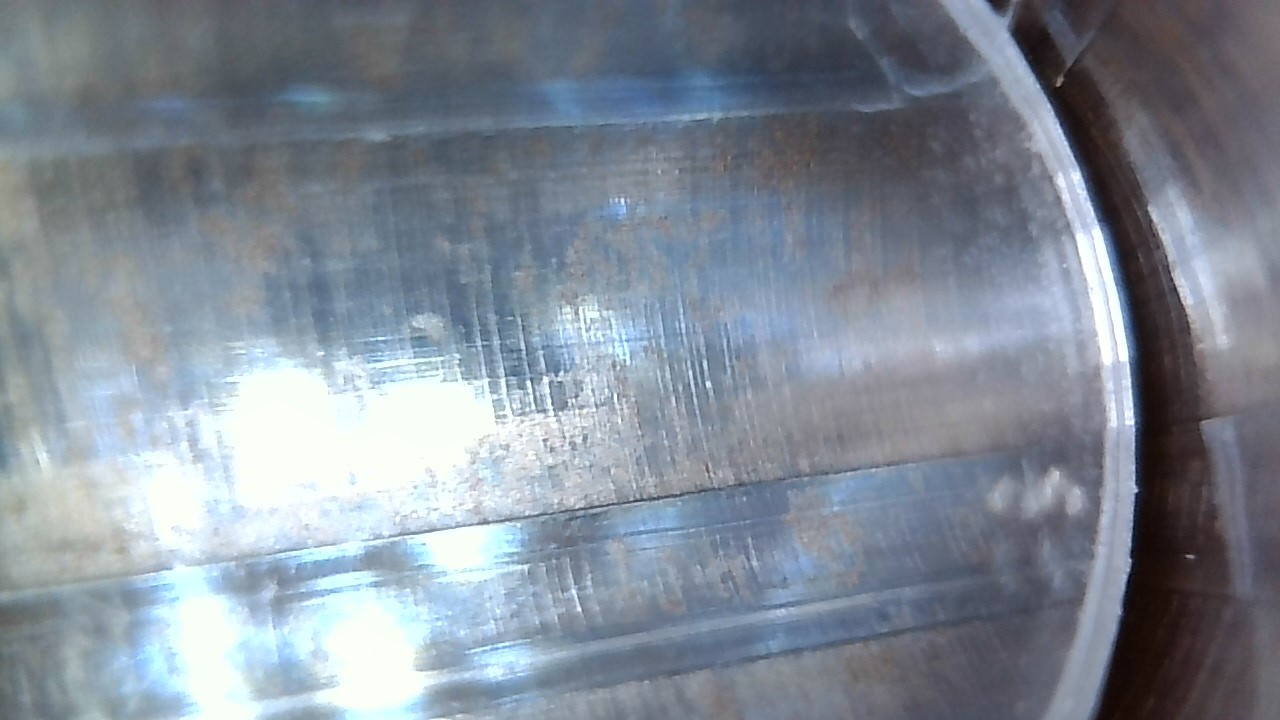

Finally got the new barrel borescoped today. Everthing looks pretty normal to me except I've never seend lands that start "unevenly" like this before (see first pic below). I'm not going to judge the barrel until I shoot it but I wanted to make a note of that.

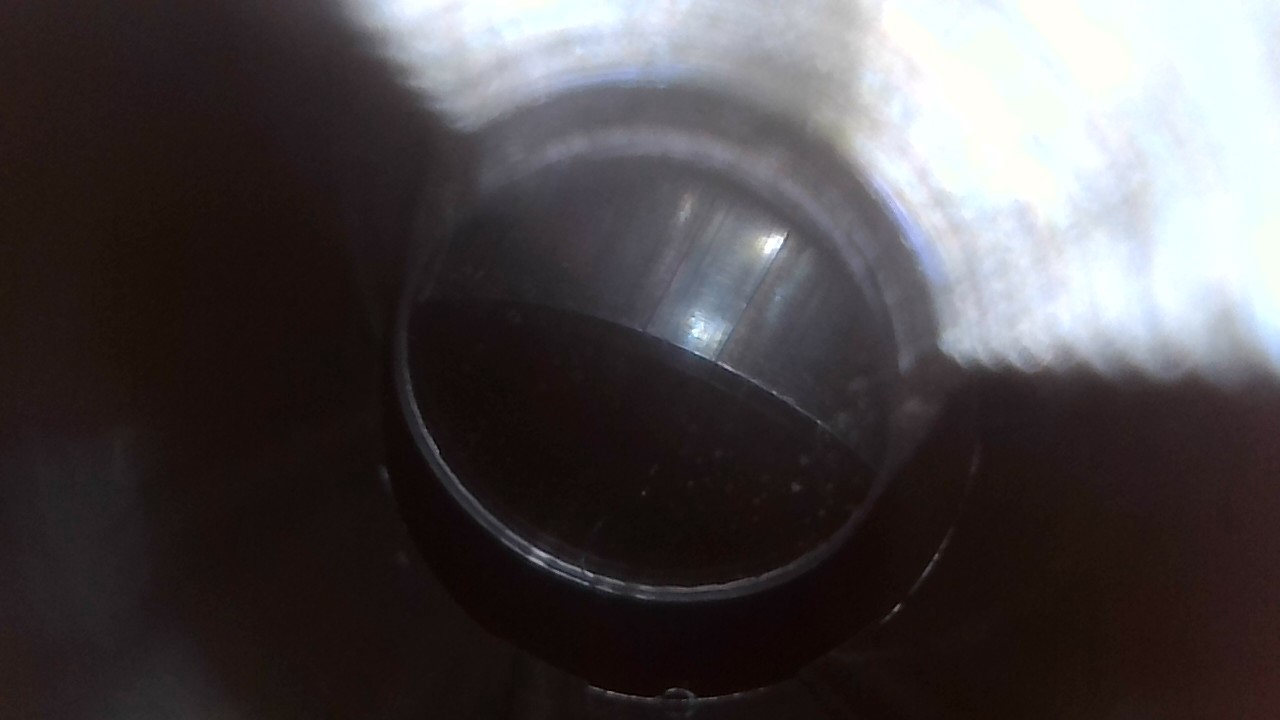

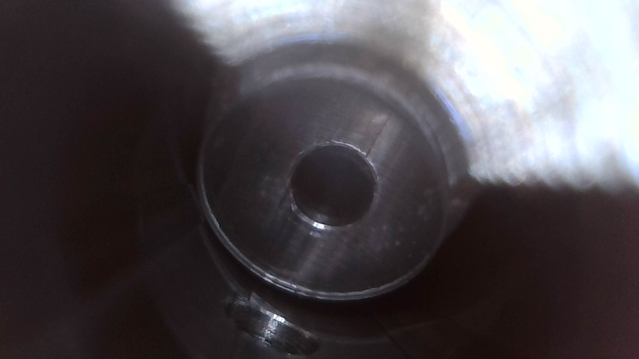

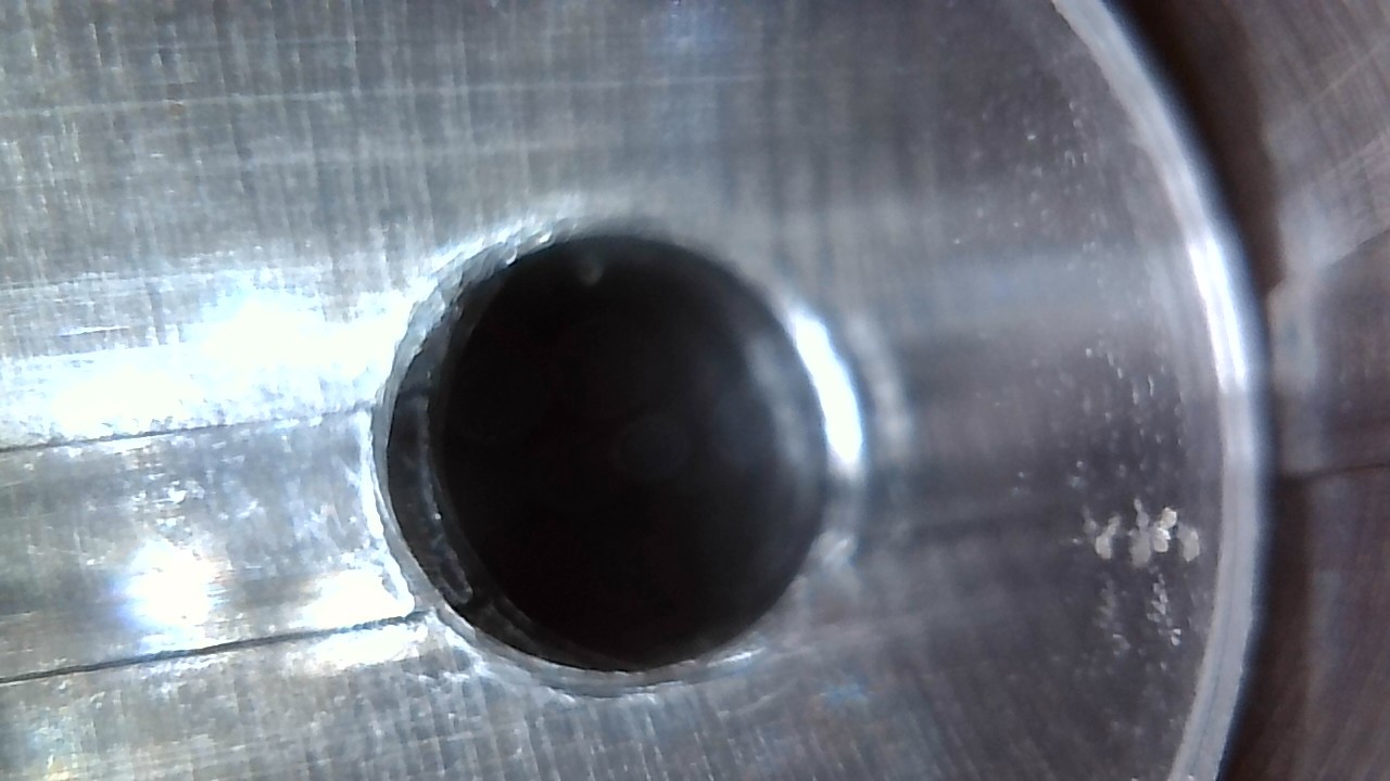

This is a mid-length gas system and the port gauged out to 0.079"
Now that the initial barrel inspection is complete I will start breaking it in then start load development.
Start of rifling/lands:
mid part:
Gas port:

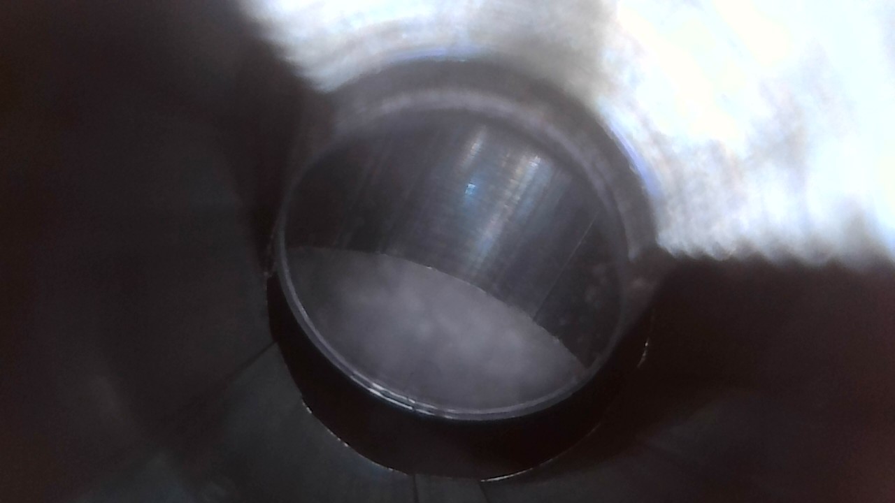

Crown pic 1:
Crown pic2:

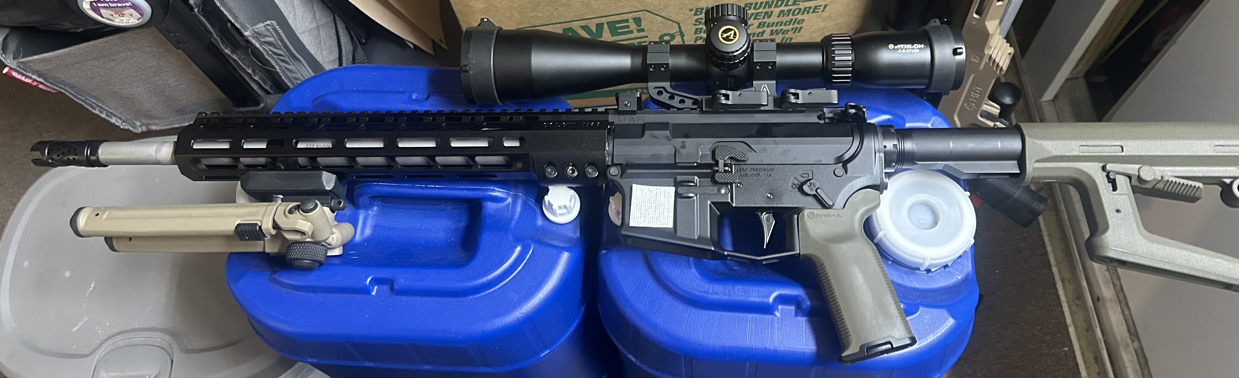

Got the bev block today and put everything together. Next steps, do a function check with some factory ammo then start breaking in the barrel and working up some handloads with 77 smk’s.

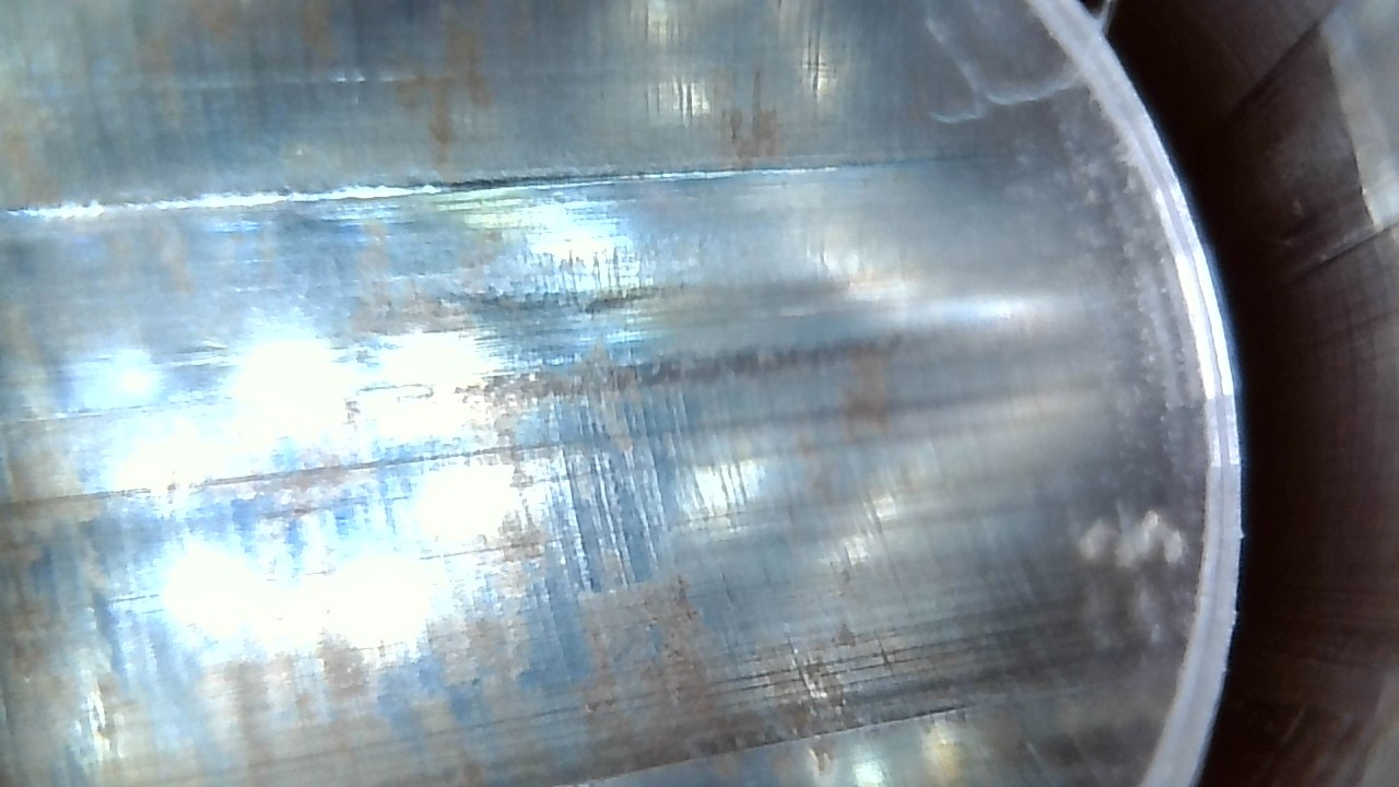

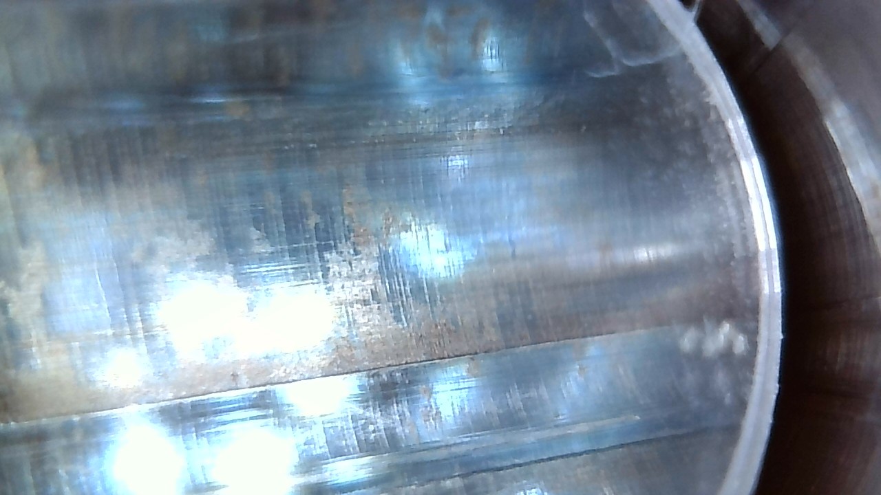

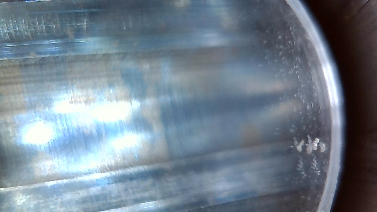

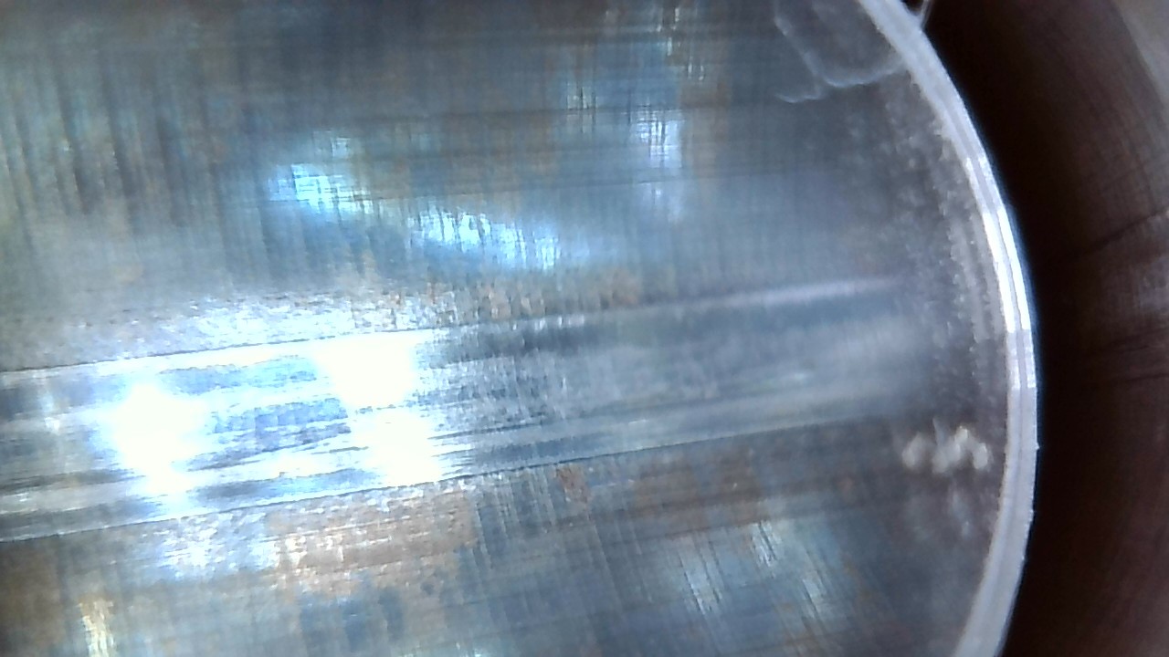

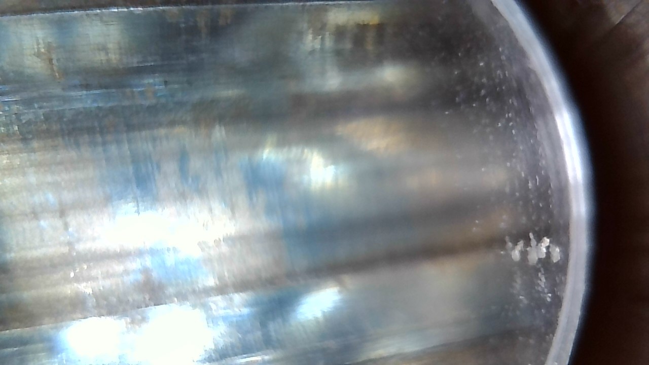

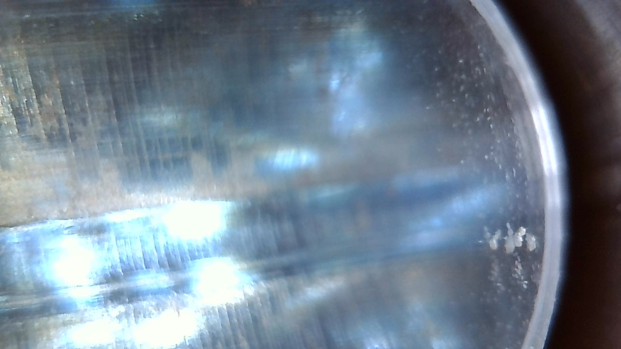

Just got a new borescope that has a focus feature on it and took another look down the barrel to validation gas port alignment (it's slightly off but I'm gonna run it) and I noticed this barrel has some pretty rough looking machining/chatter marks especially in the chamber area. It also has a ton of what looks like cooper or possibly rust deposits between the gas port area and the muzzle even though I have never shot it.
I will still try this barrel out but I wasn't expecting to see tons of brown discoloration inside unless its from them test firing (I cleaned the barrel thoroughly with eliminator followed by some iso alcohol before looking with my new borescope and I didn't really see blue color on my patches).
I will be done with my handloads for this upper soon and hopefully get to the range within next few days.
Is this copper or rust?

Looks a lot like a couple ARs we have here.
Hoping you have similar results as we have!
Very good shooters and a ton of fun.

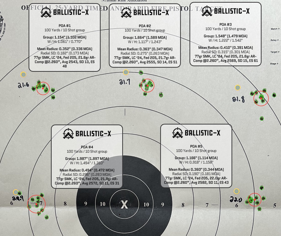

Just got back from the range and we’ve def got a shooter!
Shots 5 through 55 on the barrel (definitely some fliers on my end but I always include them to be consistent). I shot 5 ten shot groups for initial break in. There were a few 0.5” 5 shot groups within some of them and some with 2-3 bullets going into the same hole.
Also for the record the brown discoloration marks between the gas port area and the muzzle are gone after shooting 55 rounds down the tube then cleaning with eliminator and a parker hale jag followed by boretech brush then patching it out with some 91% ISA
73gr ELDM shoots slightly better through my 16" Criterion Core than 77gr SMK does (though they're both roughly capable of 1-1.2 MOA 10rd groups). I'd be interested in seeing what yours can do with it, if you have any laying around. I've been looking at the RTR barrels but hoped they would shoot a little tighter. Though those mean radius numbers aren't too shabby. Did you get a headspaced bolt from Craddock or are you using the one that came with your BCG?
Yeah I got a headspaced bolt with the barrel. I don’t have any 73 ELDM on hand but I do have like 400+ of the 77 smk’s. Keep in mind these groups are the first few shots down the barrel with zero load development. I do have some 77gr bergers and N140 on hand so after barrel break in I will see what groups I can get with them.
