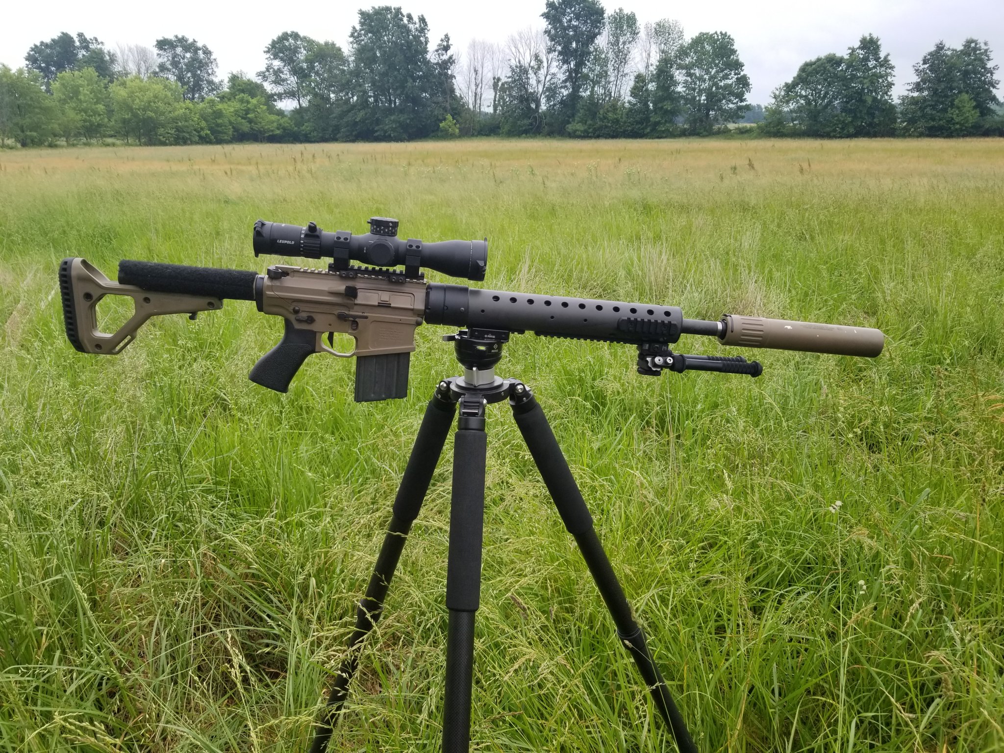

I found a JP barrel / bolt combo for a little over $400 - 20" heavy contour 11.25T. I have read a quite a few good review and some so-so reviews and a few bad ones. On the other hand...everything written about Craddock Precision is stellar. The price point on the JP is very appealing.

That is the combo I am running and it has been exceptional. I have no experience with the Bartlein offering but I have had the JP together for 3 plus years now and am thrilled with the accuracy.
