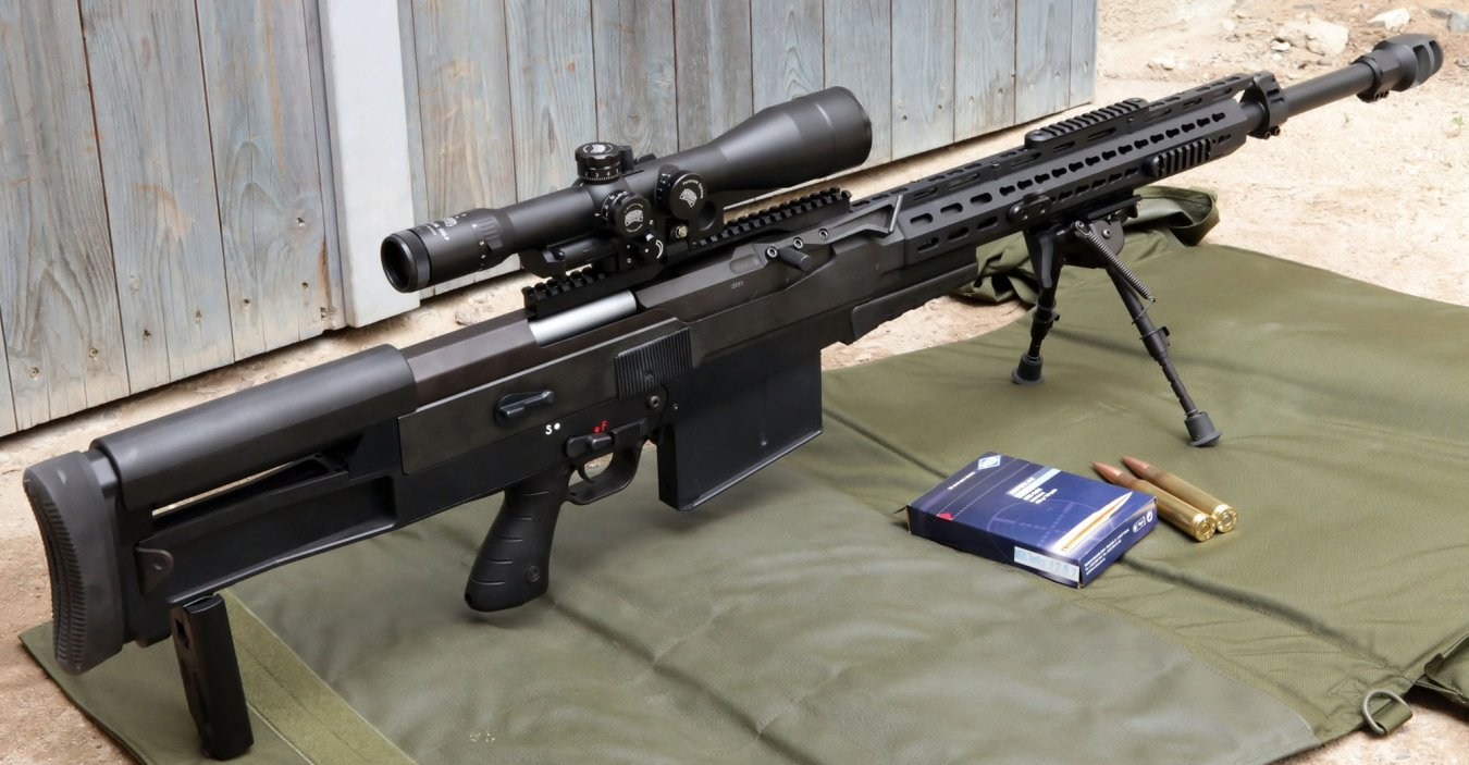

I am particular to the Accuracy International ATAICS Chassis.
I really like the look of this rifle, but I'm pretty sure it's only capable of firing a .308 round. If I could chamber it in .338 I would but I know a gun enthusiast would cry foul, and rightfully so I think. So my search begins with two questions..
1. What calibre and bullet would meet this requirement?
2. If I did want to create a custom rifle, is it possible to create a rifle based on the ATAICS chassis?
You can get a long action ataics chassis which you put in any rem700 footprint action, you just cant get a long action at308 which is a complete ai rifle from the factory.
The pic you shared is an at308, not an ataics.

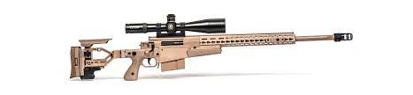

What about this?
This is one of my top picks at the moment, but I really like the visual style of the AT308. I think it's the fact that it just looks more robust, there isn't as many parts to it. I know it's stupid but I prefer a rifle that has as little modularity in terms of the chassis as possible.

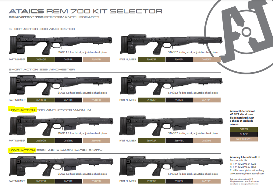

The long action .338 in this image, isn't that a AT style chassis?
Yes, it is. Its just not got an ai action to go with it.
You have to put your own rem700 pattern action into the aics.
(accuracy international chassis system which is a stock for other manufacturers rifles, ai offers their at308 and ax308 and axmc rifles into the same stocks but those are a complete rifle system thats not really compatible with anything else where as the aics is meant for everything else)

Yes, it is. Its just not got an ai action to go with it. You have to put your own rem700 pattern action into it.
Okay, so if I want to build a rifle based on this chassis I could very much do so?
If that's the case then what calibre would you suggest for a military sniper shooting between 600 - 1200 meters? I've been reading a lot and there's a lot of mention to the military using .308, and .338. But what about .300 Norma Mag, what would be the better choice?
Yes, you can very much take a rem700 action or any of the dozens of aftermarket custom variations and put it into an AICS stock.
