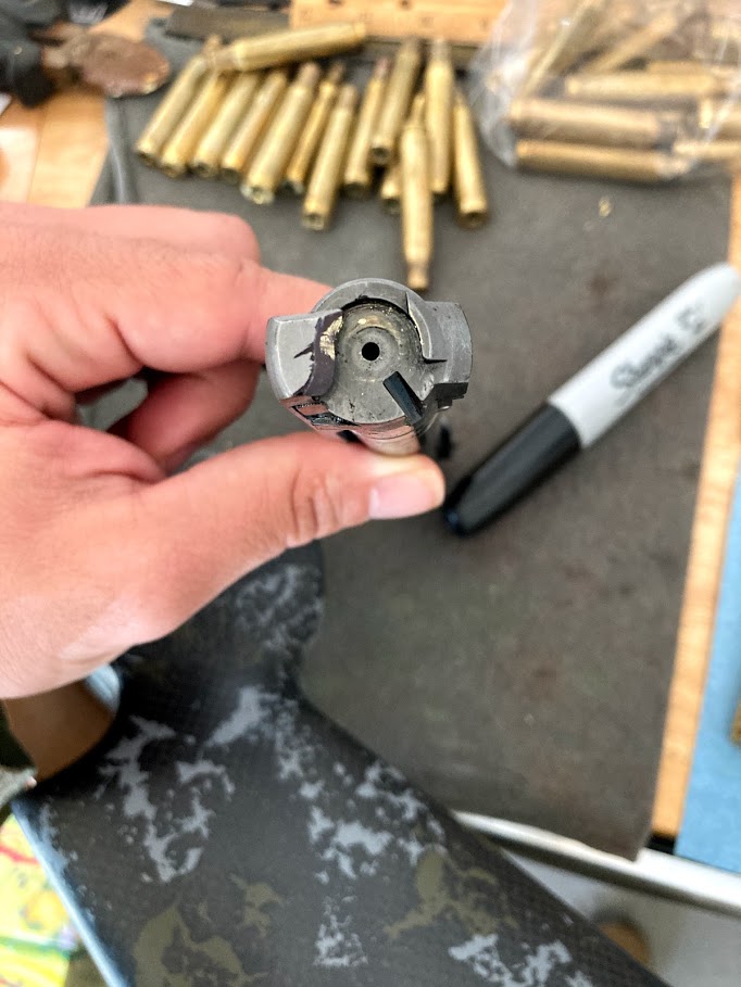

Sounds like I need to grab my files and stop ignoring my M70's problem. Feeds fine from the mag, but trying to run the bolt on a single round dropped into the action? The amount of force required to send it home is not dissimilar to what I would use if I wanted to break someone's nose. My M70 has been far more temperamental and decidedly less forgiving than my other actions...
The "sharpie" trick will likely help you out here. Mark up the extractor with one and cycle the bolt once or twice with a sample case. It should wipe away the ink where the contact is and if it's right on/at the edge of the transition from the flat face of the extractor to the chamfer feature, that is where I'd start. Accentuate the chamfer slightly to try and encourage the outward movement more.
Reactions: CarbonMTN and DJL2
Thanks! Will do.

For giggles, here's a picture I took...still need to actually do the filing bit. This reminds me that I have a spare extractor hanging around because I do this thing where I drop rifle bolts on concrete (accidentally). I bent the extractor and popped it off the bolt body a few months back doing that. I grabbed a multi-tool, approximated what seemed "right" and put it back on while I waited for the spare. If anything, that slightly improved the situation. The 1911 similarity failed to impress/endear. I suppose in the name of science I should hunt that spare down...
https://photos.app.g
