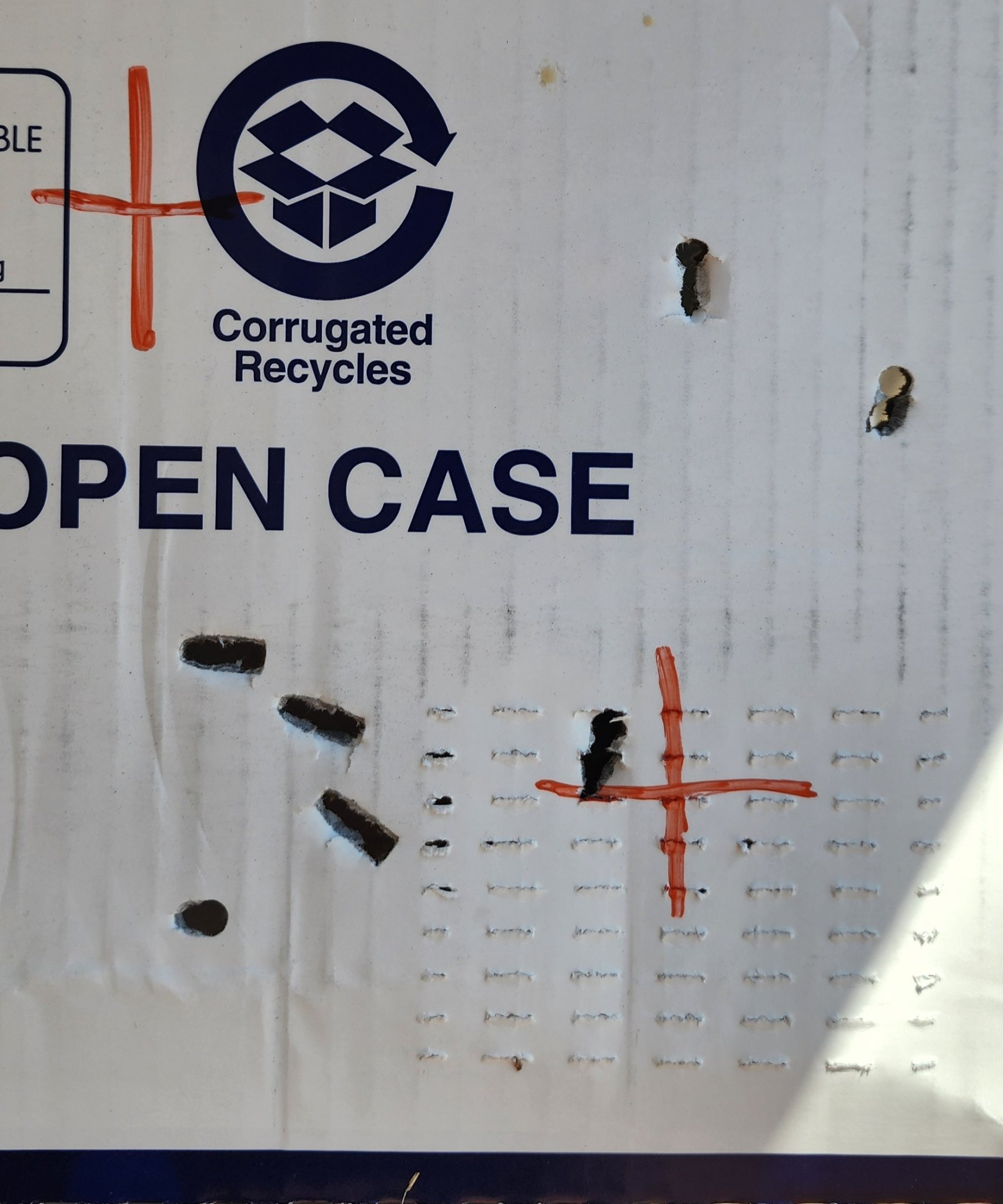

Any help would be appreciated. I purchased a Crickett 6061 precision for my 7yr old son because of the adjustable LOP. All of the ammunition I have tried is keyholing severely and wildly inaccurate at 20yds (10"+ groups). I have tried 7 different types of varying bullet weight and velocities.
CCI quiet 22 40gr 710fps
Federal suppressor 45gr 970fps
CCI suppressor 45gr 970fps
Remington subsonic 40gr 1050fps
Remington golden bullet 40gr 1255fps
Remington thunderbolt 40gr 1255fps
Winchester SuperSpeed 37gr 1330fps
Does anybody have any suggestions or know what could be causing this problem?

Check if the rifling is barely there, got left out, or whatnot...
There was this thread on another forum wherein someone's Ruger GP100 was devoid of any rifling, no joke.

Bingo Edsel!! No rifling at all. Didn't consider that to be an option haha. Bought it new, so I'll be contacting the manufacturer tomorrow.

Keystone fixed this very quickly once I contacted them. They paid shipping both ways, swapped the barrel, and it was back in 10 days. Very accurate now and my 7yr old son killed his first 2 squirrels right after christmas.
