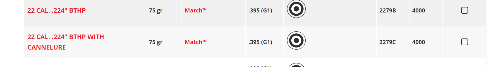

I picked up some hornady 75 gr bullets with cannulure,,,they were on sale, I would prefer no cannulure As I don’t plan on crimping I prefer precision type ammo which is why I like the hpbt style heavier gr bullets. Do the bullets with cannulures shoot as well as th e same bullet without? Hornady 75 gr match factory ammo has shot VERY well out of my match barrel, like 3/4” or better. Hoping to duplicate. I have never had to reload for 223 before now.
Today Hornady shows the same BC for the bullets, couple yrs ago, cannelure bullet was substantially less. I don't have both, but the reg bullet was fairly longer.
