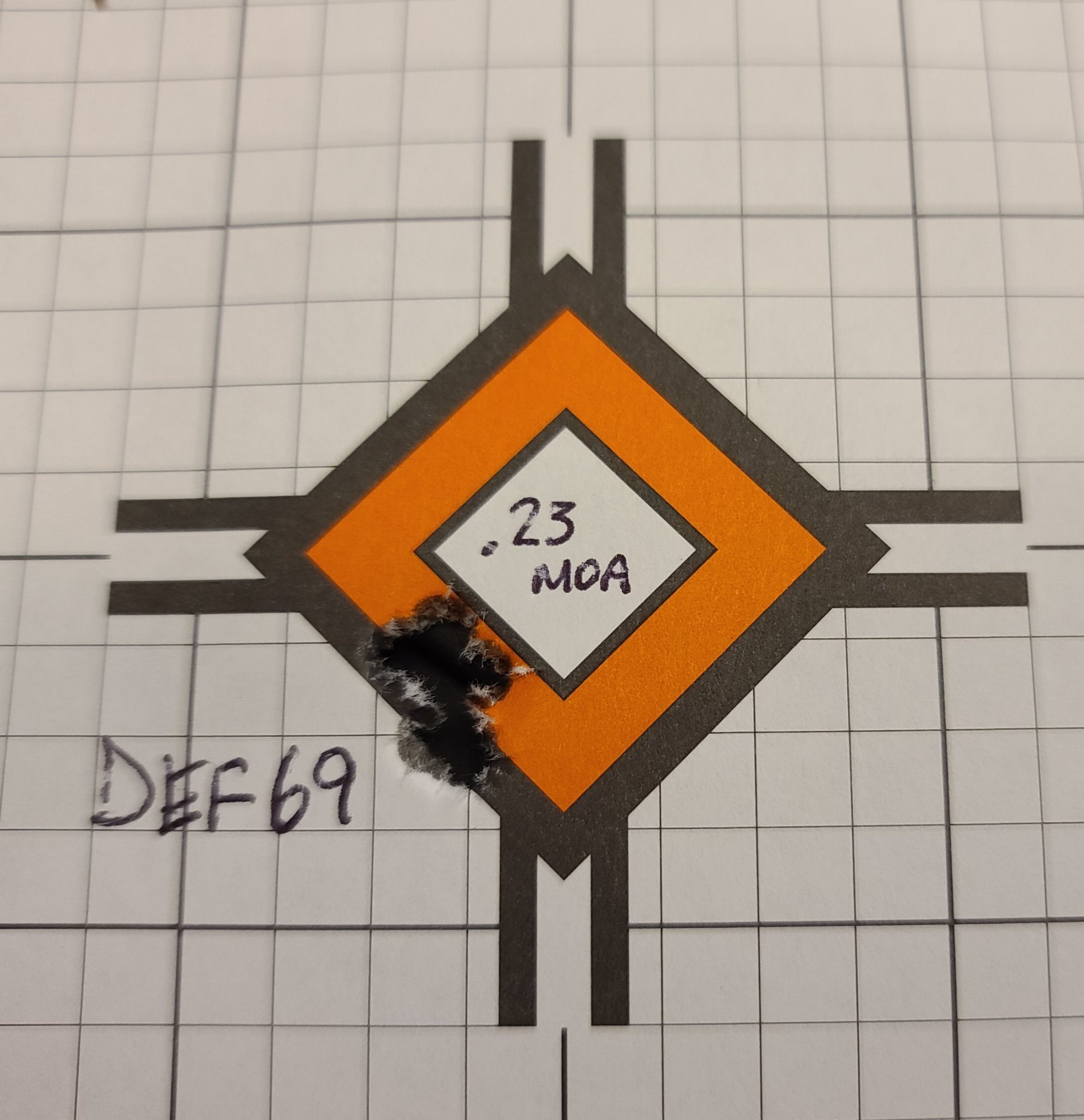

A bunch of guys jumped on these Crimson Trace deals on airgun forums I'm apart of. Most think there just amazing but haven't had any higher end scopes. Guys who have had experience with better scopes are all saying these aren't really that great even at there clearance prices. Your review seems to agree with that. I thought about one for a second but went for a different scope.
I have a Series 3..... 5-25x. Knobs do spin quite easily, not a fan of that. Floating dot reticle I like. I would almost never be below 15x so the shrunken reticle is a non-issue. It's a nice Japanese built scope for $499. Shot it today as a matter of fact. It's sitting atop a JP .223 20" Precision AR.

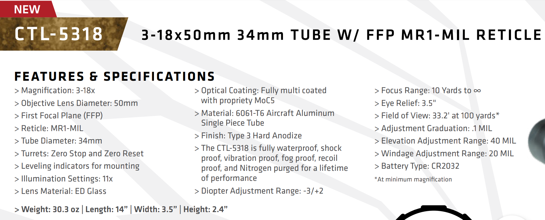

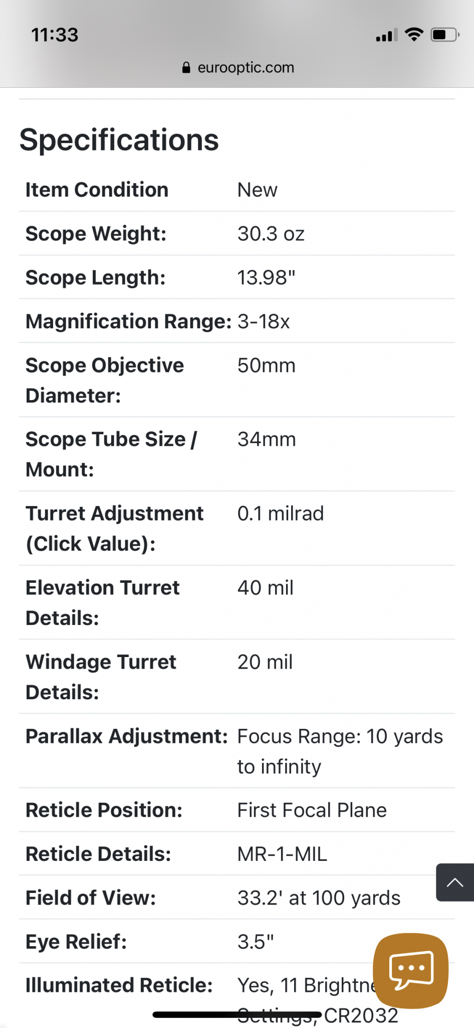

Are you sure you’re only getting 20 mils total? I’m pretty sure they’re closer to 40 mils, I have one on a 338 lapua and dialed 19 mils to a mile last week with clicks left on a 20 moa rail.
Check your zero stop.

Regarding elevation travel the marketing material, which seems to have been scrubbed from the CT site, indicates it should have 40 mil.
Reactions: Gohring65
I *think* I have it figured out. I removed the turret completely, and there are over 4+ turns of total elevation from top to bottom...but, no matter how you adjust it, you are limited to 19.5 mils of elevation (regardless of whether you are at the top of elevation travel or not). Not sure what its set up that way, but I found the same thing mentioned in another google search.
What's baffling is the complete lack of information regarding this not only in the manual, but on the website as well.
I found this spec sheet on the web. It was the specs I viewed when I bought the scope. I needed that elevation travel for my lapua. I’ll have to check mine out to see if I can see what your saying. I dial mine to 19 mils often I just never really needed to test it any more because it fills the role nicely. My confusion is, I have a 20 moa rail on my lapua and I dial 19 mils on a scope of only 20 mil total. I wouldn’t even get close to dialing that much elevation out a 20 mil total scope on a 20 moa rail. I’d say the way the zero stop is set up is that it’s only allowing that much travel, but if the zero stop is removed the entire adjustment would be available. I can’t remember, but I think I had another scope that the zero stop would have to be removed to get the total travel.
