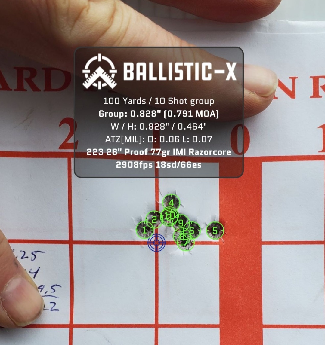

    To give you an idea of what 77 razorcore can do in the best of circumstances, fired from my tactical division prs rig.

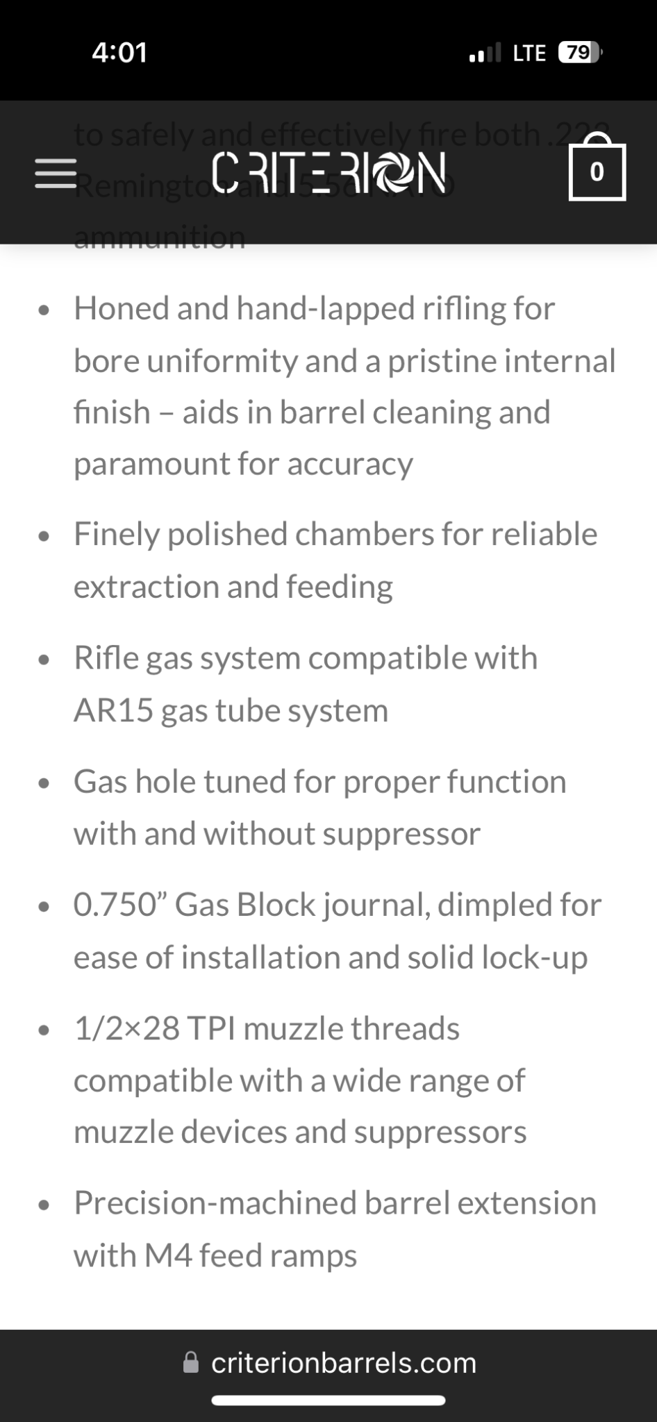

    I firmly believe that the Criterion CORE barrel is the best bang for the buck you can find. Close to the very best regardless of price.
    Spend some time inside a dozen or so of them with a borescope and you'll appreciate why. They're gorgeous inside.
    With top shelf ammo, they will shoot top shelf groups.
    Their Wylde chamber with 1x8 twist gives you 1.5" - 2.0" barrel length worth of velocity over a NATO chamber 1x7 twist, too.

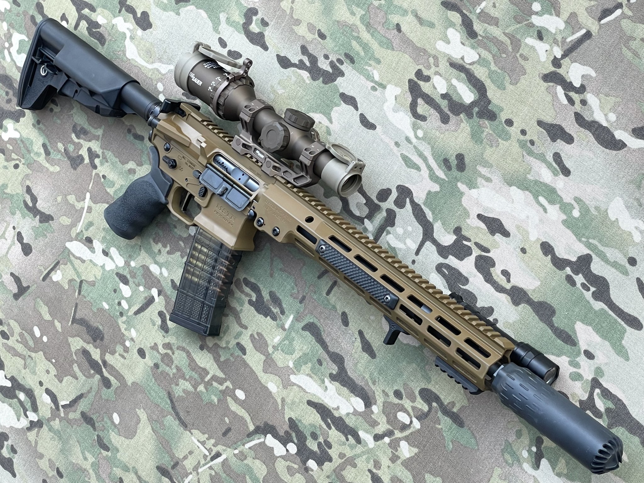

    My latest Criterion barrel GPR:

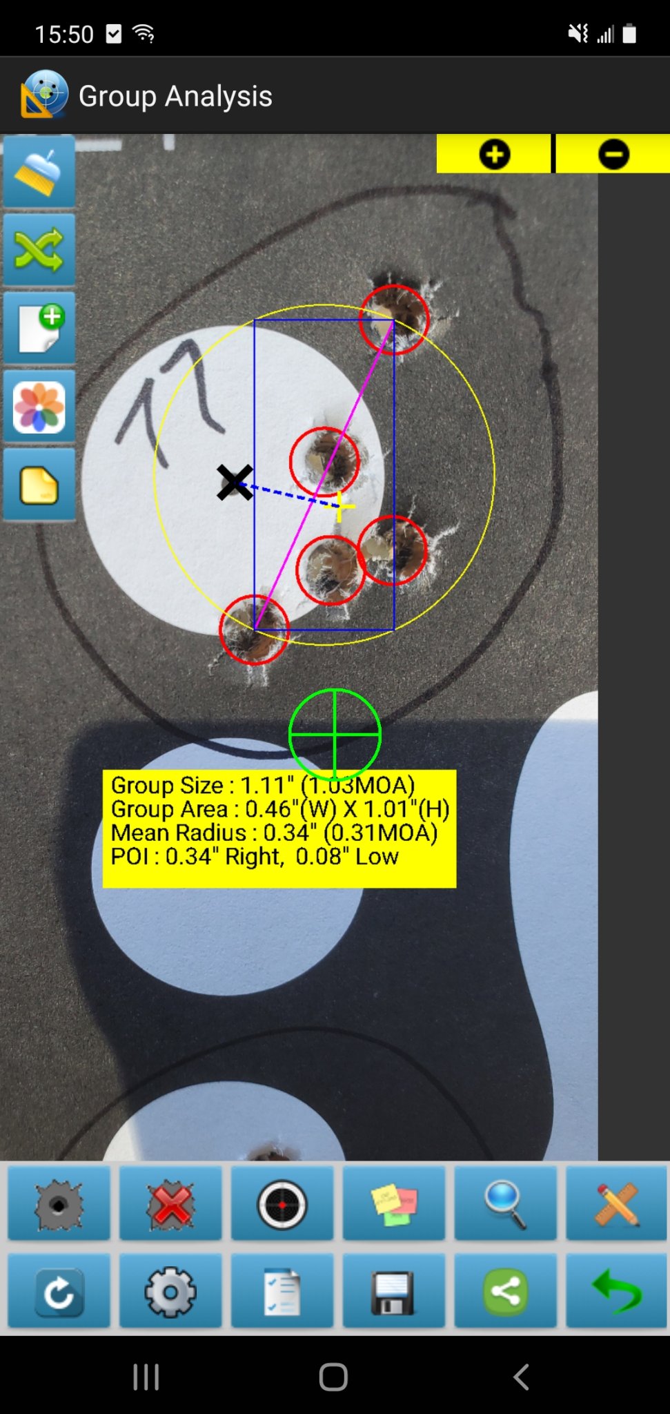

    I have a Criterion 18' hybrid that shoots sub MOA with 77g FGM.
    As in I have been getting groups as small as .55 with FGM 77g.

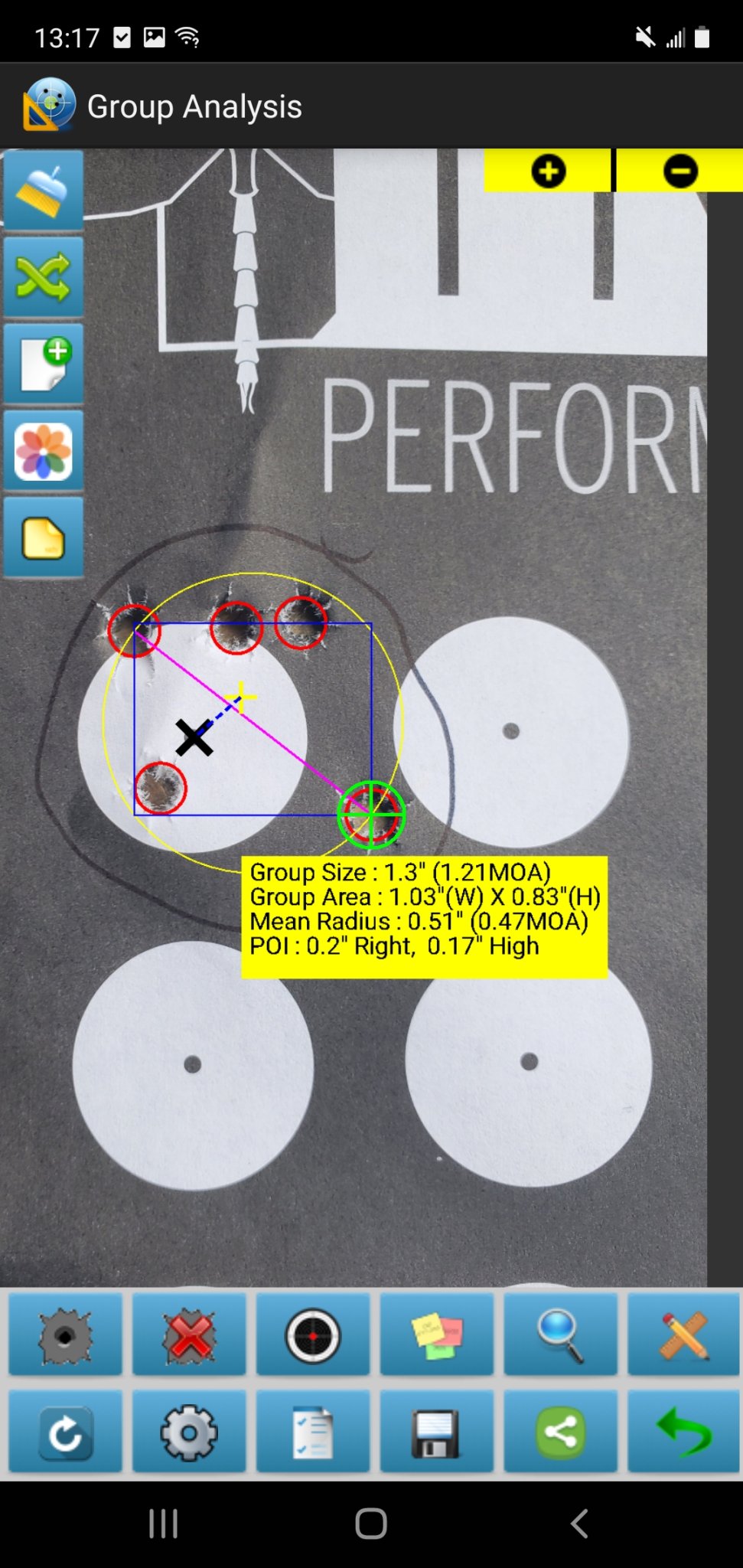

    I also have a Core barrel in 16' and another one in 11.5'.
    They shoot well but I haven't had the opportunity to measure them the way I want to.
    IE, match ammo, 10x+ optic and at least 100 yds prone.

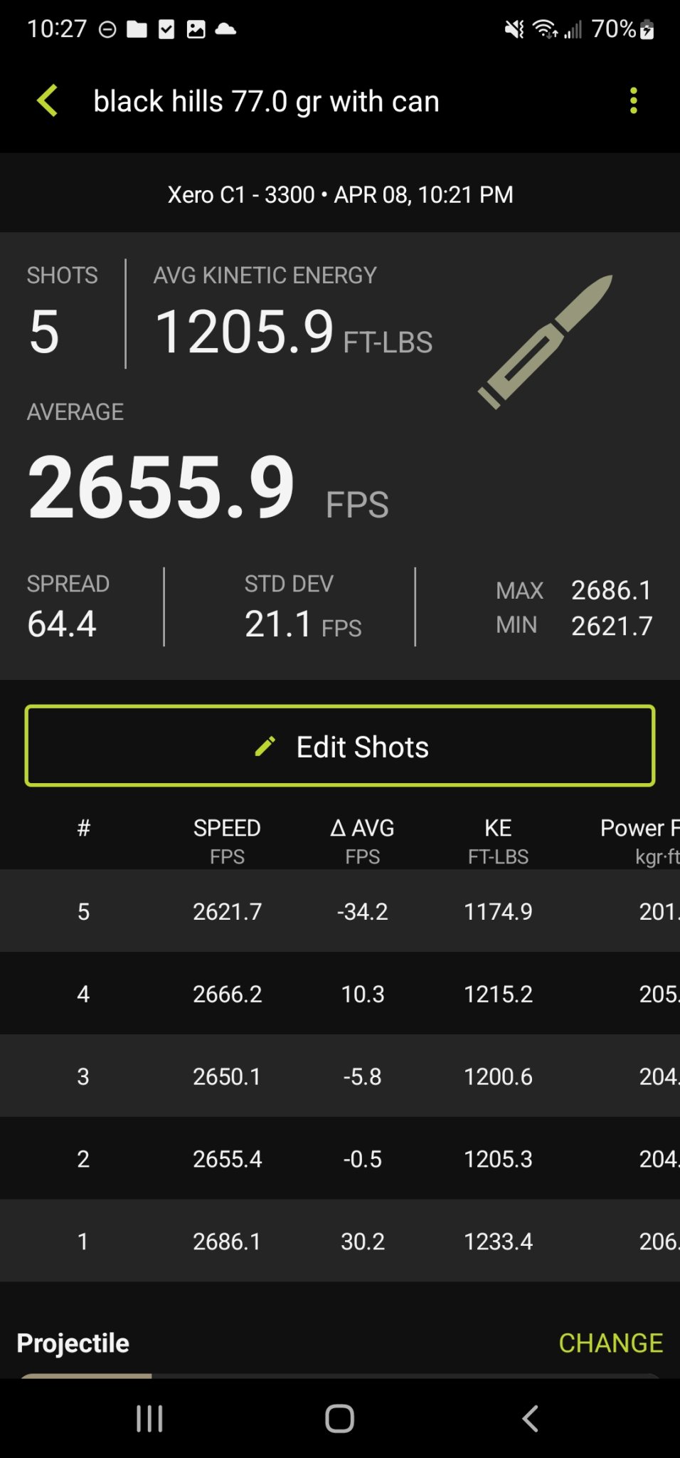

    I noticed that about the velocity too. I'm getting 3000 fps out of M193 and 2900 fps out of M855 from my 13.9 Core. In comparison, I got the same velocities out of a BA 16" barrel.

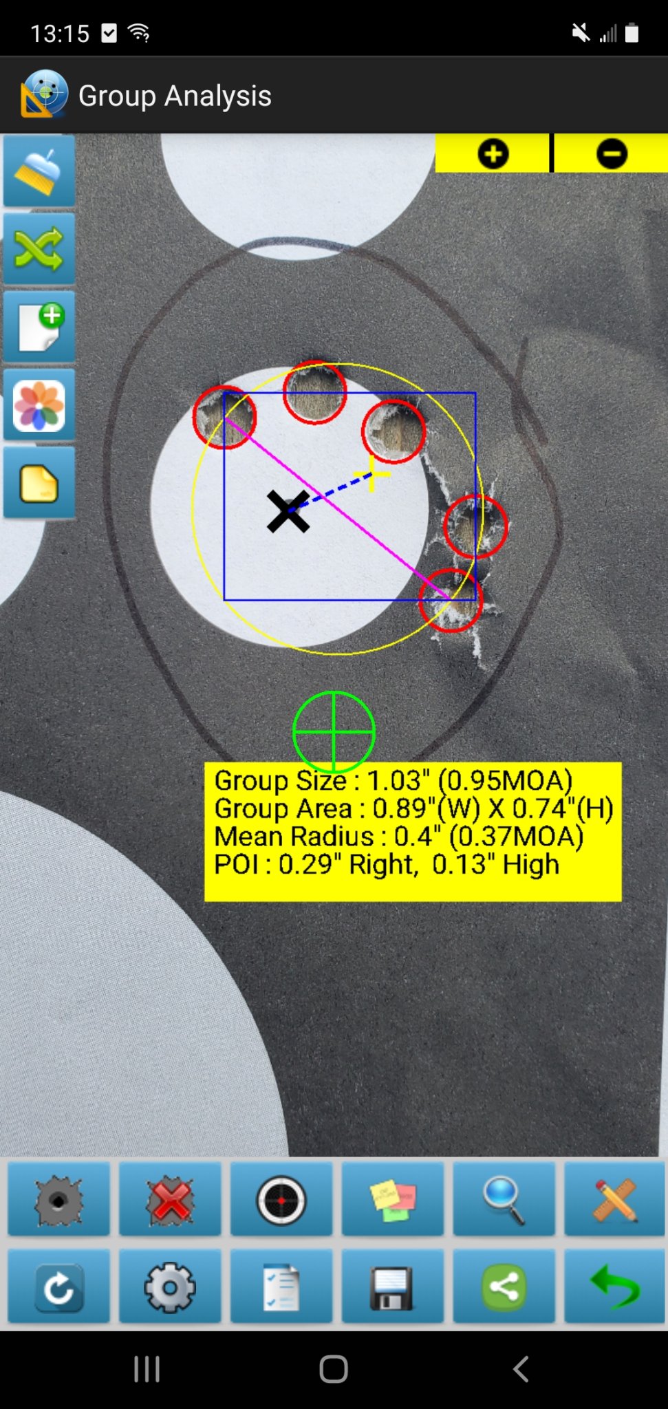

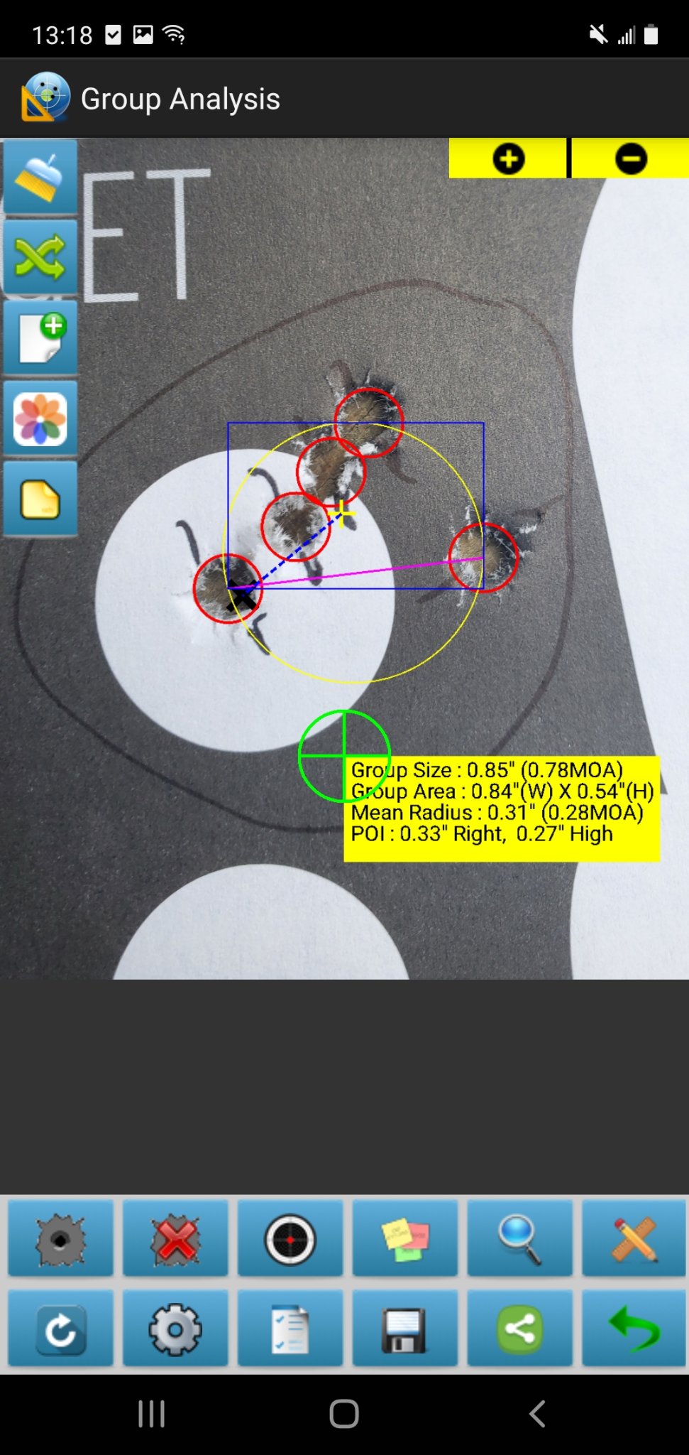

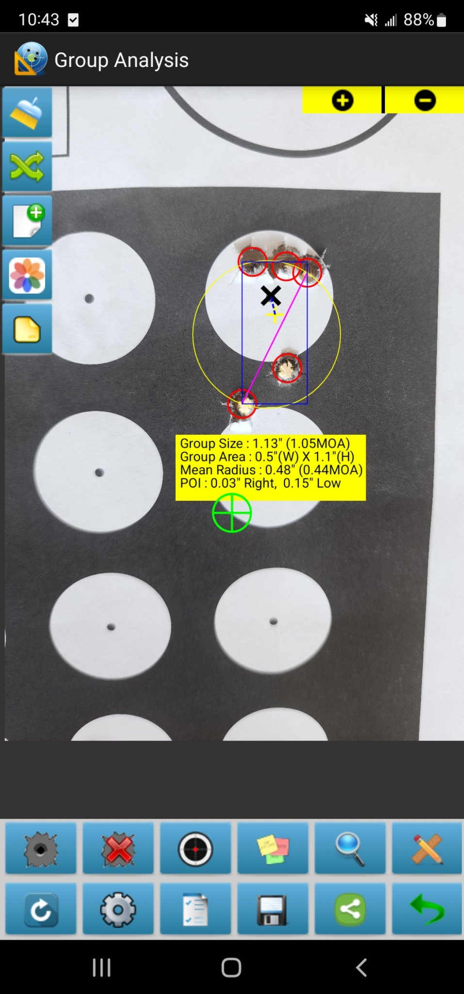

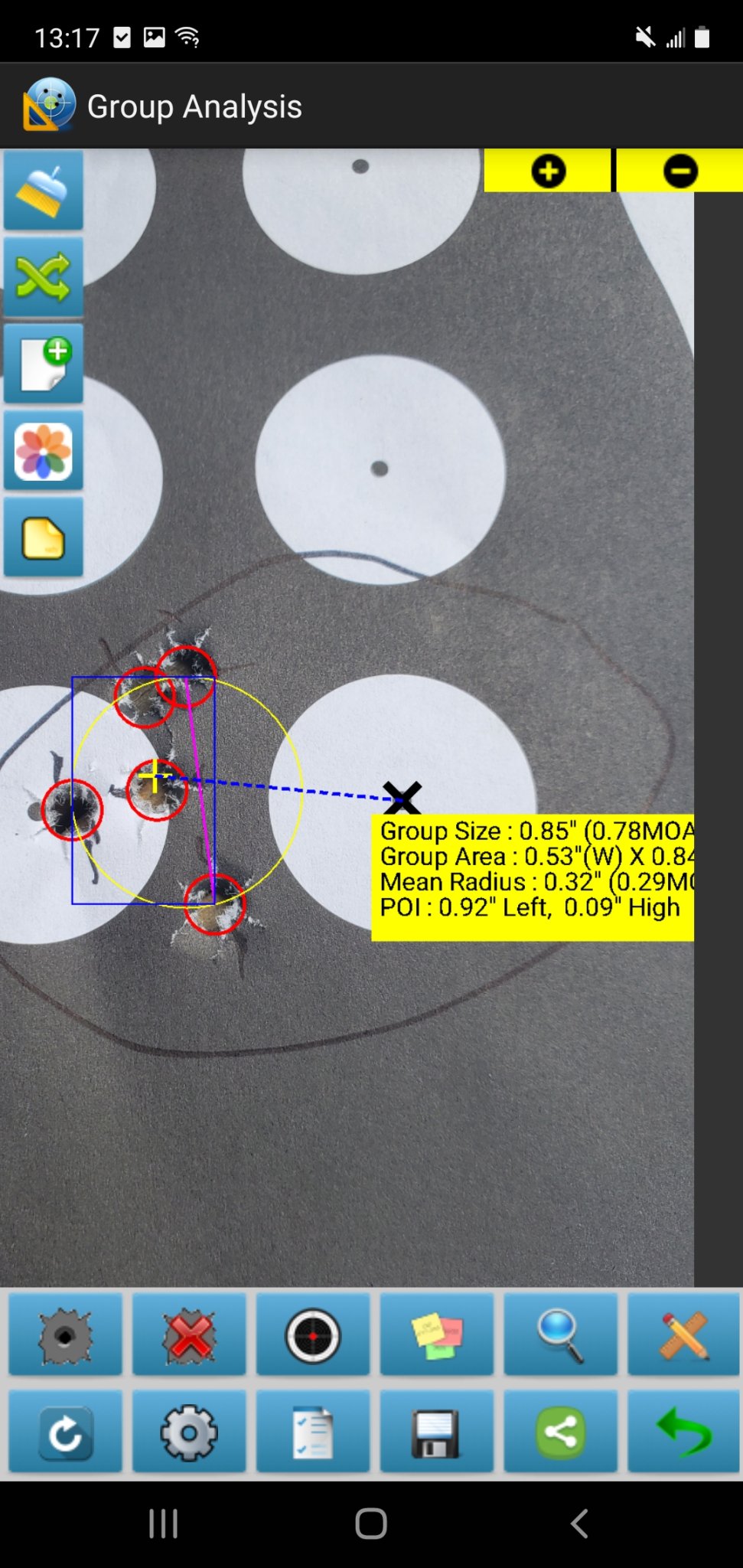

    I had the same results with a .308 18" Criterion and 22" 6.5CM barreled upper that are TnG'd
    Here is a pic of each of my Criterion barrels better groups... (10rds each, both 100yds, benched, scoped, rapid'ish fire ( no barrel cool down ) all the accuracy improvement assm. tricks I could do easily.
    NOTE: I threw the flyers in both... I got to giddy from the group sizes.
    Both LFAR's assm.d with an Adj. GB ( SLR ), heavy buffer weights, 9.3oz for the 6.5CM, Tubbs 308 Flatwire , .308 carbine stocked / 5.3oz buffer , Tubbs .308 Flatwire, Both TnG'd , I made sure there was no chance of gas block contact with the handguards, and snug fitting upper to lower.
    10rds Horn. AG 140gr 6.5CM, PSA upper with 22" Criterion, TnG

    .308 18" 155gr Horn. AG, PSA Upper, with 18" Criterion, TnG
    !!!!!!!!!!!!!!!!!!!!!!!!!!!!!!!!!!!!!!!!!!!!!!!!!!!!!!!!!!!!!!!!!!!!!!!!!!!!!!!!!!!!!!!!!!!!!!...jpg

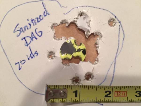

    Another 308 with a cheap nitrated barrel w/ 20rds DAG surplus after TnG>

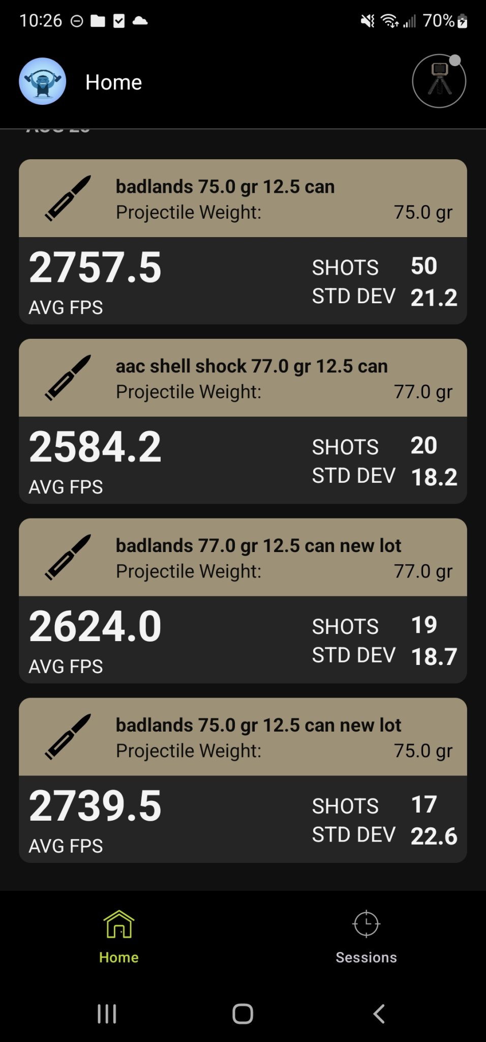

    Both my criterion barrels had rough break in periods. Right around 200rnds they calmed down and tightend up.
    12.5 core with griffin explorr. Current round count around 6k
    All groups shot with an atacr 1-8 and front sandbag
    Black hills 77 box avg vel 2650
    Badlands 75 gr shell shock. Avg vel 2750
    I've had pretty good luck with my 18" Core. I rebuilt a RRA LEF-T upper with it, didn't do anything fancy, just tightened the new barrel nut on and installed parts. I did notice it was somewhat a little finicky with ammo, I had a pile of Frontier 68gr that would be good one day and then another would be 1.5-2", I actually shot at a target during a match at 560-ish and had the round impact about 6 feet low.
    I have played with quite a few different offerings of match ammo and the group above was shot with ADI 69gr, I have now stockpiled quite a few cases. Best I can say is find an ammo it seems to be happy with and buy that.

    Man, i should have taken pictures. I'm just not much of a group shooter and didn't think about it. I went out yesterday to a short range (100 yards) and took a box of every type of ammo i had on hand to try out this new Leupold Mk4 i just got.
    I was shooting at 2" pasters and using my finger as a ruler I was satisfied. With Hornady black 75gr, all shots were well within the 2", as it was with 77gr Razor core. The AAC ammo mostly shot well, with about 25% of the shots going either high or low. It's a real shame. That AAC ammo could be killer for the price if they could get the consistency down. The velocities were all over the place.
    The AAC 55gr V-Max shot pretty well too. It seemed to be more consistent than the heavier stuff shooting about MOA according to my finger. The best results I got were with Black Dot 55gr V-Max. All 4 5 shot groups were MOA or better with 2 of the groups being about one ragged hole.
    I'm happy.
