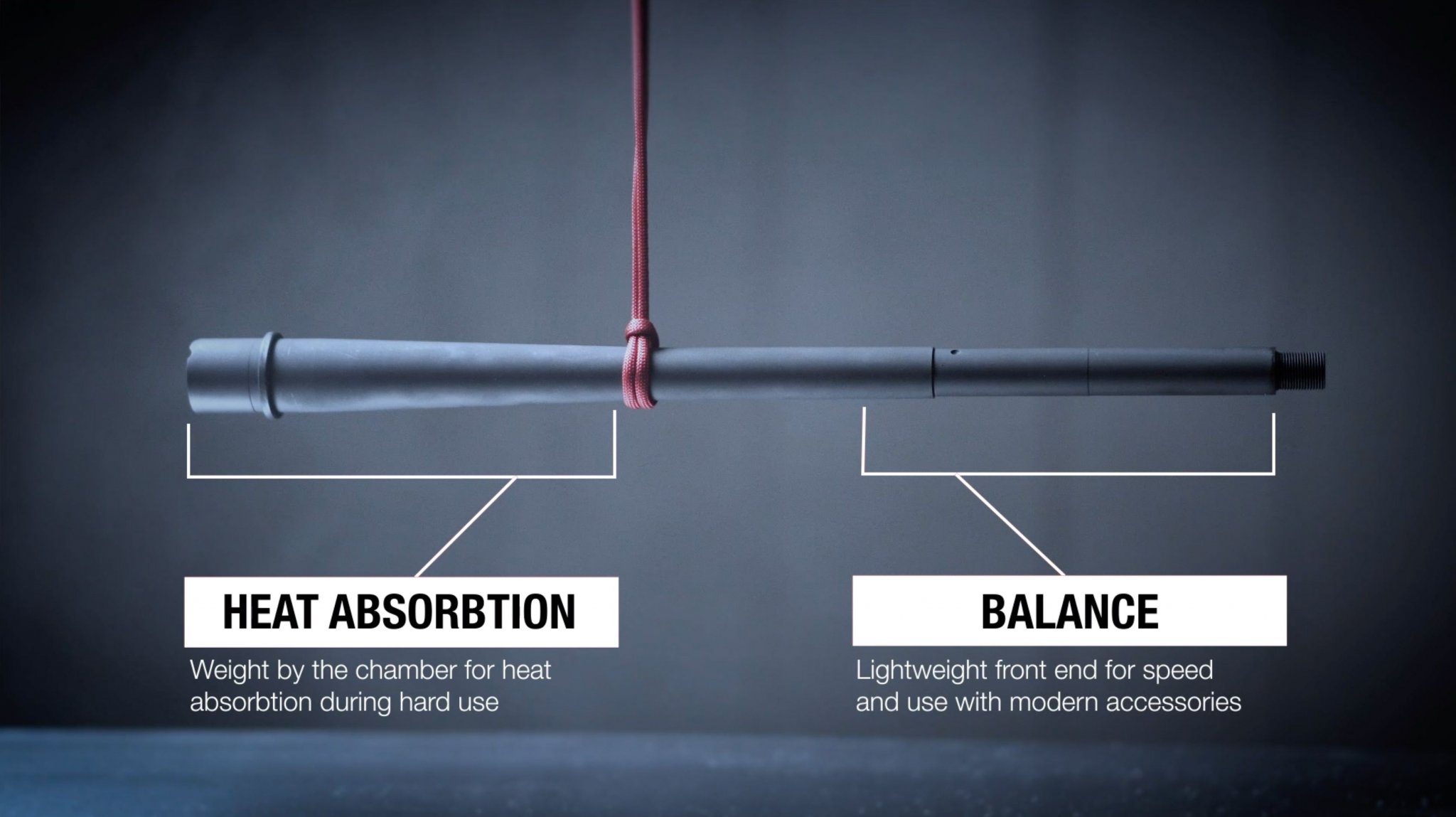

I think the HYBRID barrels have more weight (larger diameter) forward of the gas block.
If you're looking for a barrel that can handle lots of heat but is also very well balanced, I think you will really like the CORE Series. The continuous taper design gets rid of steps in the barrel that hold heat at various rates when the barrel heats and cools off during use. Thin spots heat up and cool off more quickly, while heavier portions heat up more slowly but then retain heat longer... This can create consistency issues when using the rifle as barrel steel expands and becomes more flexible as it heats up. The CORE Series uniformly dissipates heat and remains very consistent during use (more like a typical bolt gun barrel). Material around the chamber absorbs heat and keeps the balance near the shooter for increased control, while the front remains balanced and fast, which increases handling. This is especially important for those who move with their rifles and use modern accessories that mount to the front end of a rifle (i.e. suppressors, lights, lasers, clip on night vision etc.). Feel free to give us a call if you have any questions.

My 223 wylde hybrid profile shoots like its possessed. Its a bit heavy for a coyote rig though. This CORE barrel seems like just what the doctor ordered. According to the website, its half a pound lighter than the hybrid profile barrel. Sounds like my two hybrid profile AR's are about to be dedicated target rigs and I'm about to have a new hunting setup.

Interested as well, especially the 14.5”, suppressed full time. Being thinner up front, do groups open up more as it warms up with a can on the end?
I already know I want a hybrid profile for one of my more precision/recce-style builds. Was thinking about the Core for a lighter build if it still handles suppressor heat POI shift fairly well. I’m not talking mag-dumps, but something along the lines of a higher volume carbine course.

....am I reading the website correctly, it's saying the weight of the 16" barrel is 4 LBS. ??
