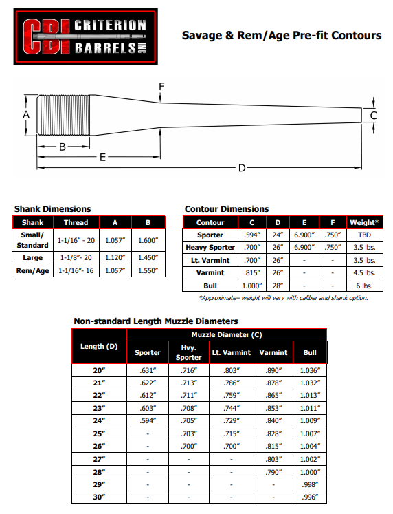

    Looking for some advice on Criterion prefit options. Looking at maybe giving a Criterion Rem/age prefit a try depending on other things pan out. Anyway I’m trying to get away from the heavier than shit m24 contour my 308 currently sports. Was thinking med/light palma ish for a little bit less weight, but still able to sustain under repeated fire. By the looks of their chart I was guessing their Varmit contour is he closest to that. Anyone have any experience with these to give me some guidance either way?
    http://criterionbarrels.com/prefits/Remage

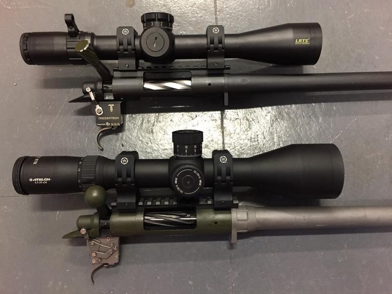

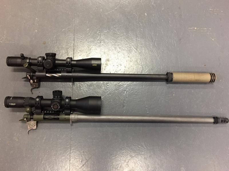

    Here is a comparison of my 16" rem varm next to my 24" cbi varmint.
    Chamber
    Overall

    Here is a comparison of my 16" rem varm next to my 24" cbi varmint. Let me know if imgur is still being retarded and you cant see the pics.
    Chamber
    Overall

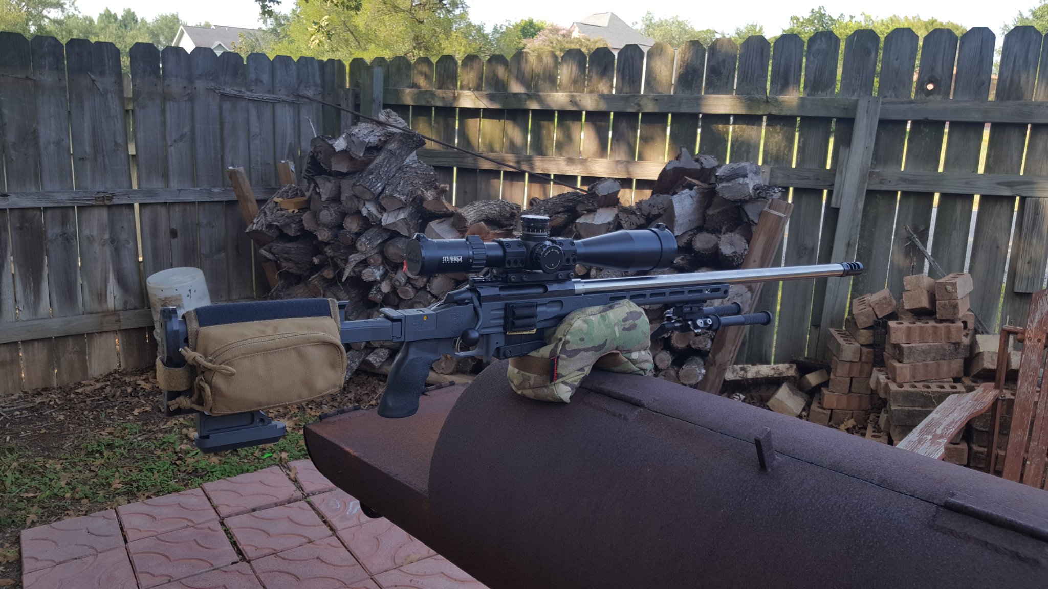

    Right now I have 20” 308 M24 contour in a AICS 2.0 legacy chassis. It’s 13 lbs with no scope. Rifle is for sale right now and if it goes I’ll be buying a bew BA with KRG bravo (picked one up for a hunting rifle of mine for better tripod interface and actually really like it. I think adding the adjustable buttpad, maybe spigot, and Arca Rail will be a nice lighterweight package to complement the barrel change as well) if I get too impatient I’ll probably just rip the barrel off and sell the chassis and use my 700 action. I’m weighing my options either way.

    I would do a varmint contour then at 22". Your only saving .75- 1 lb or so between the two contours at that length but that's just me. If absolute weight savings is the greater determinant lt varmit would be your ticket.
