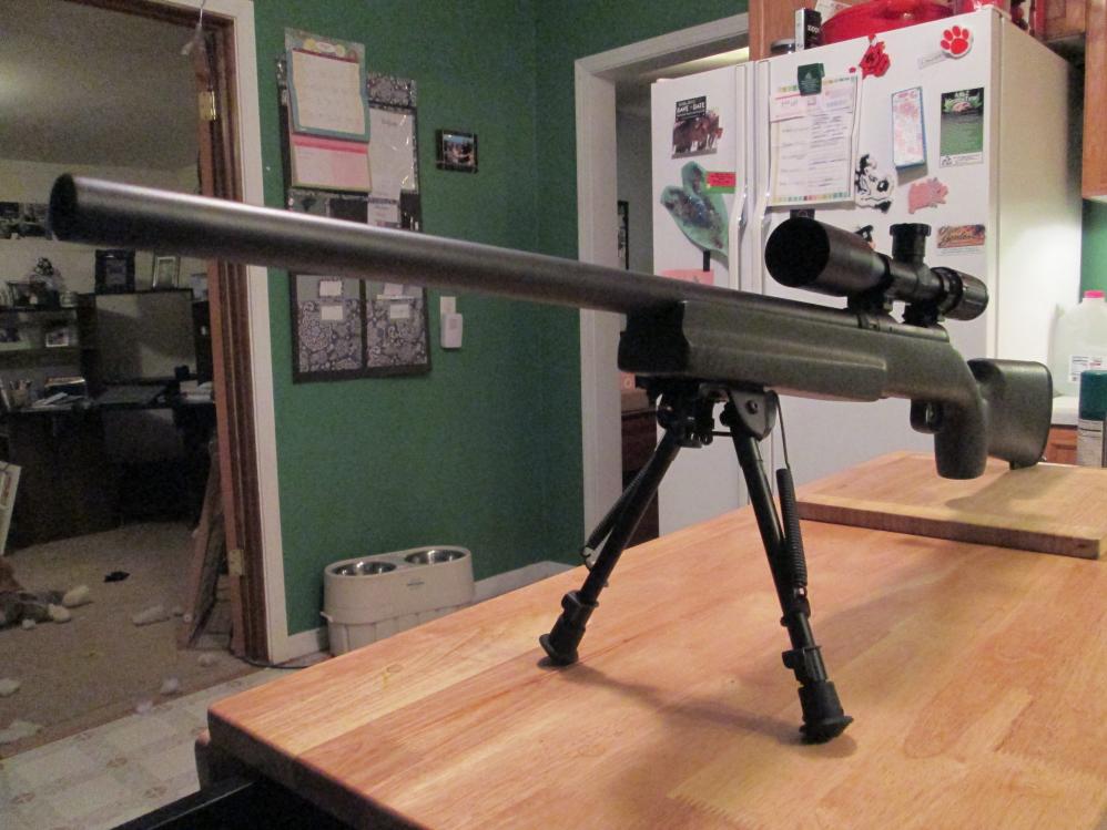

    Sounds good. I too, am new to the long range precision game and just finished putting my rig together:
    Savage model 10fp
    Bell and Carlson Medalist Stock
    Harris 9"-13" bi-pod
    Burris xtreme tactical 2-piece bases
    Leupold PRW medium rings
    SWFA SS 12X42 mil/mil scope
    Just got it out to the range for sight in today. .75" groups with 175gr Sierra match king factory ammo. Can't wait to stretch her legs. IMG_0028.jpg
