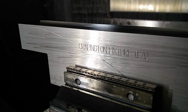

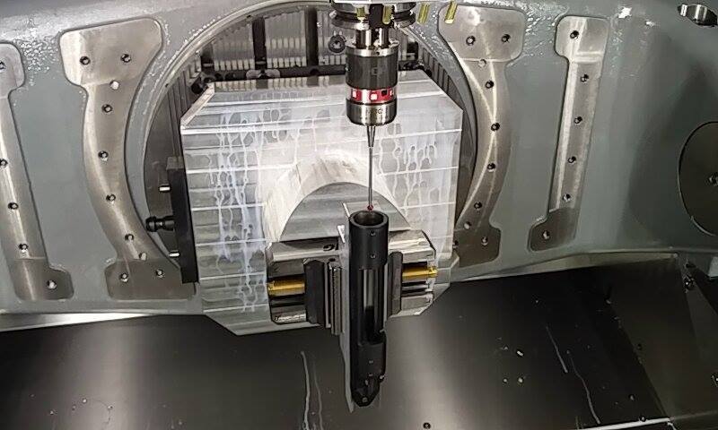

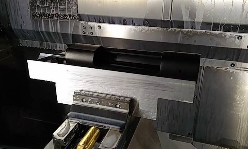

I'll mill a fixture for the action. Make a couple of bushings to accept a ground carbide rod, to indicate off of. Holes will be ramped out.
The machine is a brand new 5 axis Hermle C42u. I've got the proper tools, don't worry ;-)

Finally had some time to spare, so I finished the job on the Remmy.
I've never doubted that Remington was kinda "meh" in their quality, but this action takes the cake. I'm never touching one again :p
It turned out well.
Thanks for the help.
