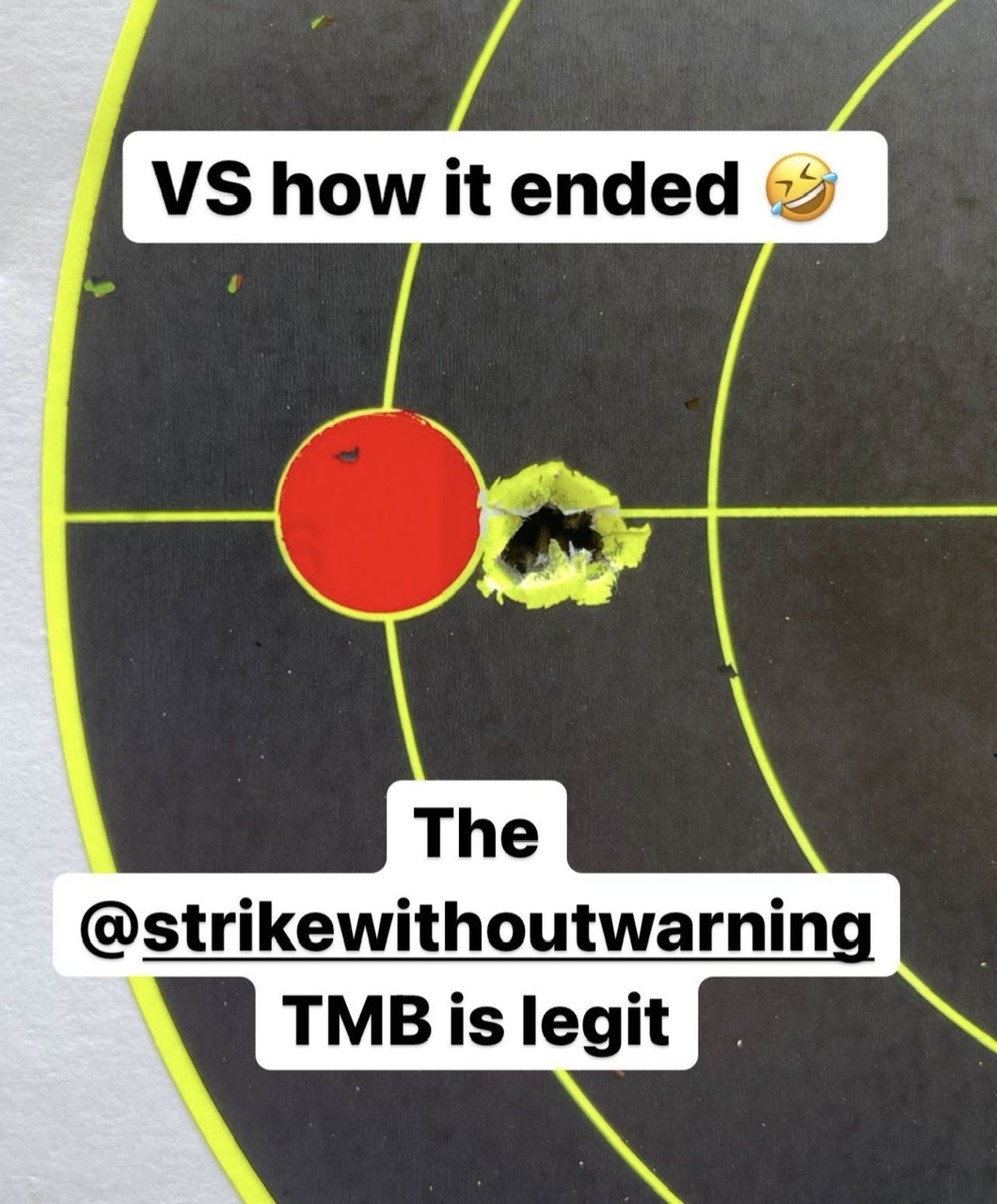

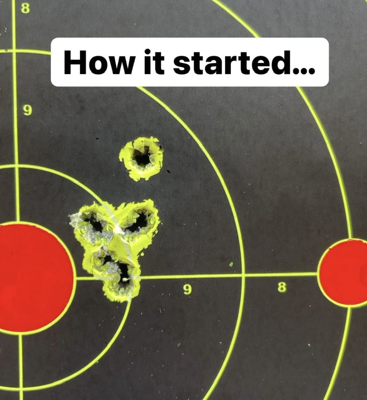

At one point, I had 2 different guns chambered in 6 dasher with the same reamer by the same GS. Gun 1 was a ARC Nucleus with a 27" MTU barrel and the other was my AI with a 26" heavy palma.
I had done initial load development on the Nuke and landed on a load that consistently shot in the .2s and .3s. I didnt want to have 2 different loads but wanted to be able to shoot the same ammo in both rifles. The groups were great in the Nuke but horrible in the AI. I threw the barrel tuner on the AI barrel and tuned it where the AI groups shot equally as well as the Nuke. If I removed the tuner, it would go back shooting 1". Install tuner to the setting I found, .2s- 3s.
Now.. I sold the Nuke so I only had 1 dasher. I took the tuner off, completed a seating depth test, and found that .020 further jump shot equal to the Nuke and the barrel tuner.
Now I use the barrel tuner for factory ammo that originally shot about .5 but now shoots .3s regularly.
A barrel tuner will not make a shit barrel shoot great but it can make a good barrel shoot better. It isnt a miracle maker but is a tool to help in certain ammo situations.
That is only my personal experience.

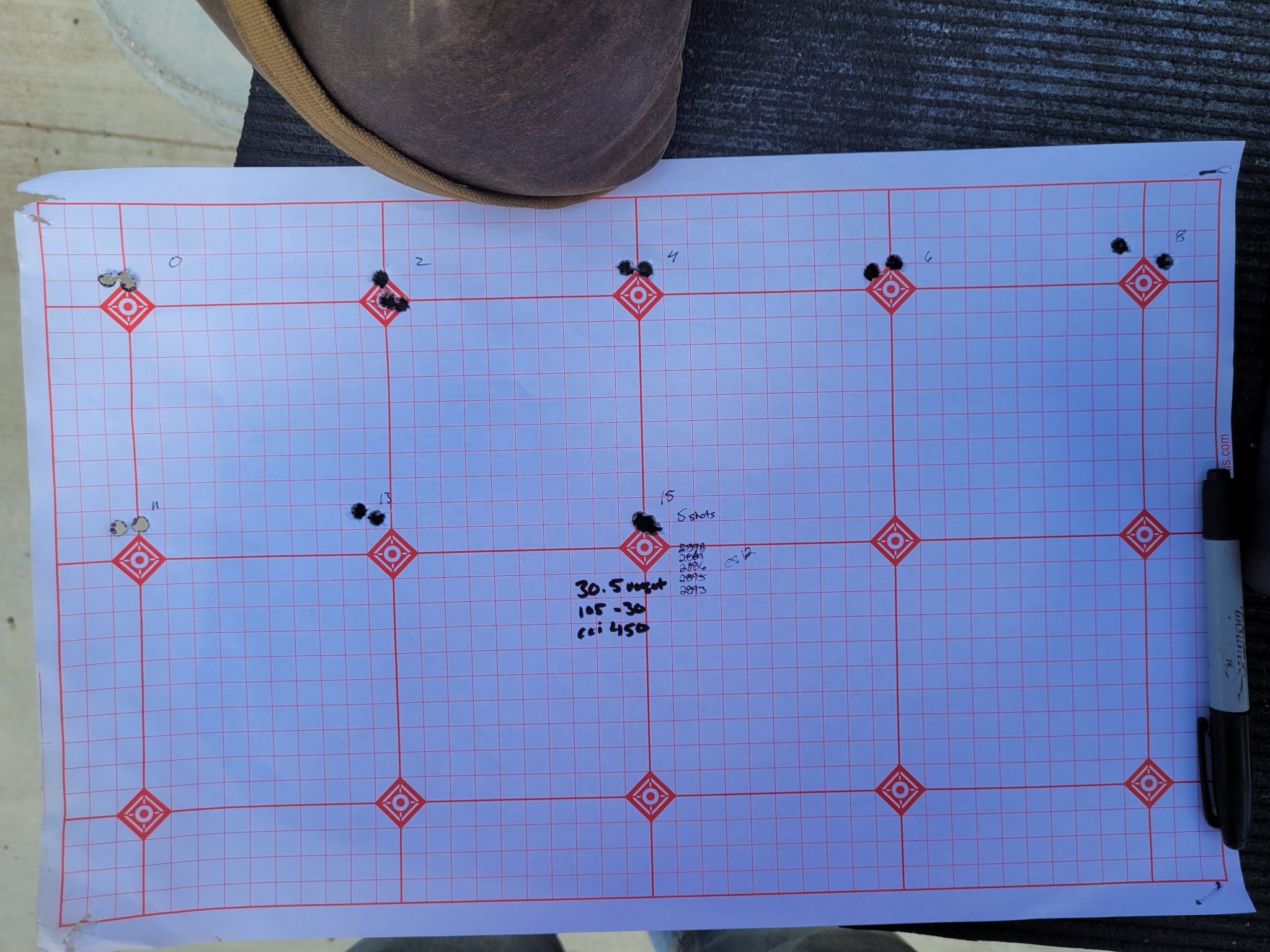

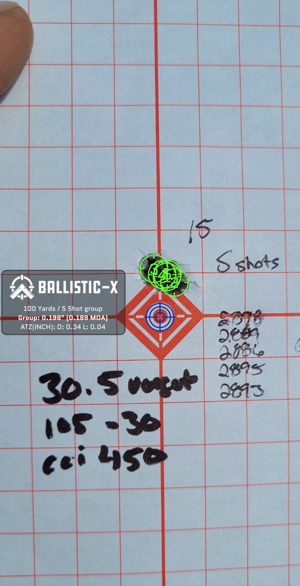

In this photo you can see the tuner at work shooting 100y. Prior range session, i found a powder node that held tight vertical at 400y, but had some horizontal stringing at 30k seating depth. Its a bra with 105s at 2885fps. Horizontal stringing was still slightly under moa wide, its a br variant after all. I started at 0, 2, 4, 6, 8(8 was much larger, so skipped 3 notches) 11, 13, 15. When I shot setting 15, both went in same hole. I verified with 3 more, 5 shot group. Since this sessions, I have tested tuner setting 14,16 with similar resutls. Gun shoots under half moa at 600y, furthest I've on paper.
