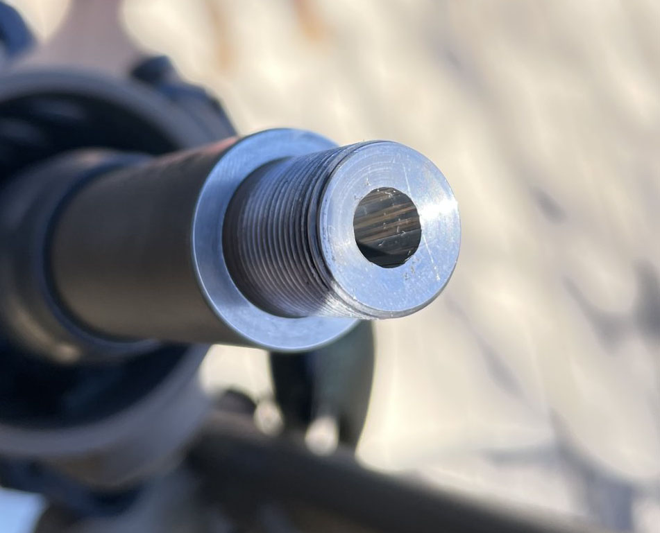

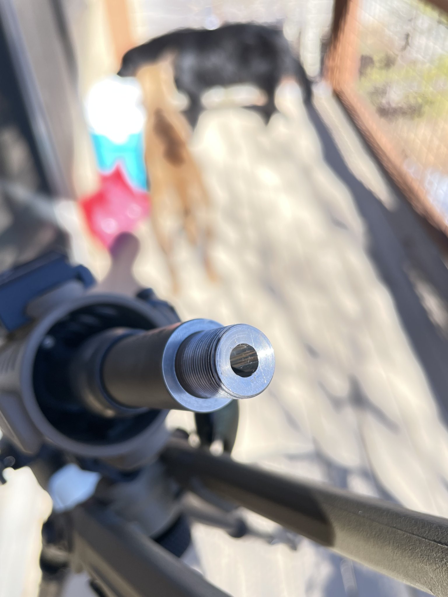

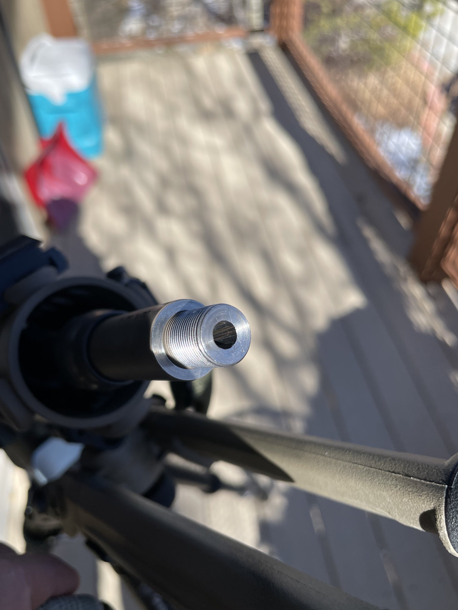

I have a PRI Mk12 mod H that has suddenly lost its accuracy. It held 1moa 10 shot groups all day with my handloads. It has suddenly opened up to 3moa. I checked torque in the optic and rails, tried shooting without the suppressor, and decoppered the barrel. Still shooting 3 moa. The rifle has about 1500rnds on it so it’s not shot out. I ran the handloads through a friends rifle and it grouped fine so ammo doesn’t seem to be the culprit. I took the brake off and cleaned the crown very well and noticed a scratch very near and into the muzzle. I am not sure if this is enough to cause the accuracy issues. The pictures attached do make the scratch look much more severe due to the light. I couldn’t get it to show up at all without outside light so keep that in mind. My next step was to swap scopes to make sure it’s not the optic. I’m trying to get through the last of my hand loaded 308s before I swap (changing bullets). I don’t want to re-zero with such a low round count left.

IMHO, it looks very possible you damaged the business end of the crown , just based on the trajectory of that scratch/damage trail.
I'd want to take a closer Look at the actual land/grooves at the crown, in some good light. Maybe use a camera on a tripod with zoom/macro settings if this helps to see it.
Also, I'd guess some more background would probably useful/helpful as do how you damaged it. Just event or object or what exactly caused that scratch?

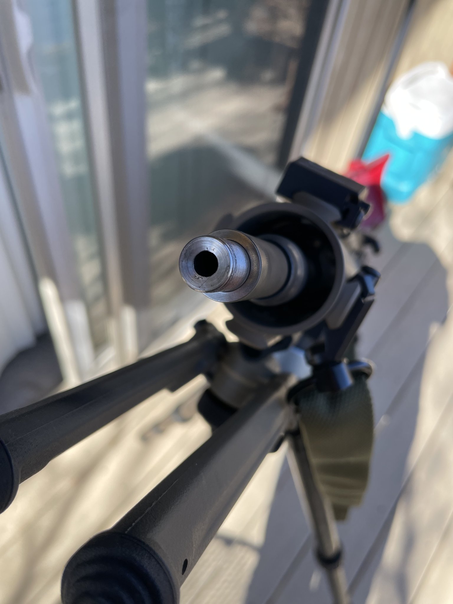

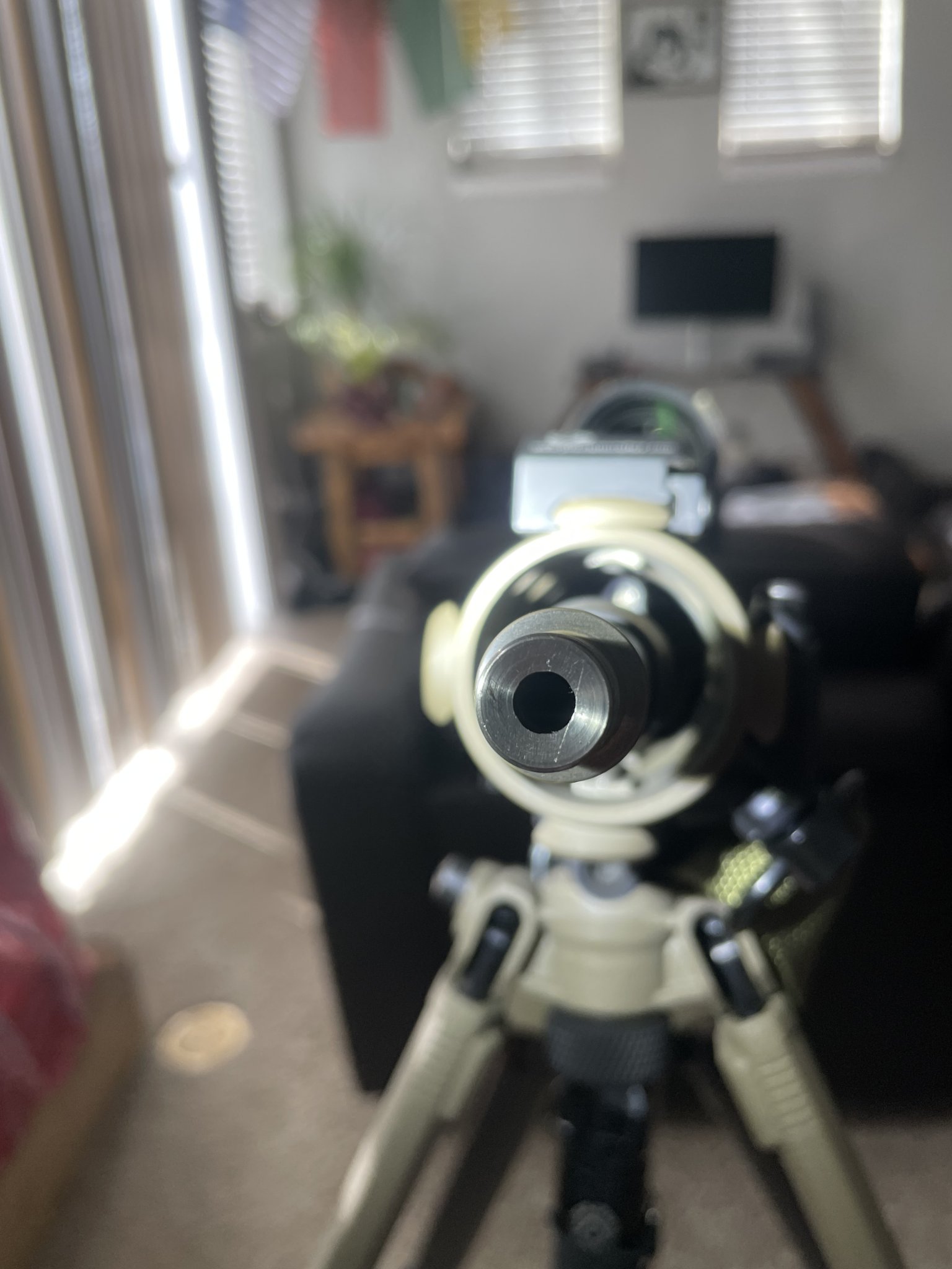

Getting a bit better light on it. It does appear there is maybe just a bit of damage to the inside lip of the muzzle. I like the idea of lapping compound and a marble, seems simple enough. If it doesn’t fix it up I can take it to a smith. I don’t have one close to me so if I can save myself the drive it is preferable. Open to any other opinions and thank you to everyone so far.
Meant to mention, in the barrel there are some piece of lint from a rag. Just an FYI as it almost looks damaged.

If there is a scratch that the bullet is rubbing on as it exits, absolutely a scratch can create issues. Particularly a scratch perpendicular to the rest of the bore. I seriously doubt the scratches that we see on the surface of the crown cause much problem at all but the line crosses into the bore itself.

The lateral scratch at the 3 o'clock position appears to be the main issue, as it crosses the land. You have a few options to address this. One option is to use brass crown laps from various suppliers to try lapping the scratch out by hand as it appears to be a very minimal depth. A bore scope would reveal the true nature of the damage, not everyone has access to one though.
Brownell's offers crown cutting tools that can be effective, depending on your level of patience—patience = precision. However, they may not have a tool that would match the specific profile on your crown, you would have to look. I’ve had good results repairing crowns using hand tools, though I agree that nothing compares to a lathe-cut crown. One member suggested having a gunsmith recut the crown, but this may not be feasible for you in the short term, and I totally understand if that is the case. If you have the tools or want to own them, recutting and lapping by hand could be a viable solution and save you some $$. If you're not satisfied with the results, you can always seek a gunsmith's help, but resolving the issue at home is also a valid option.

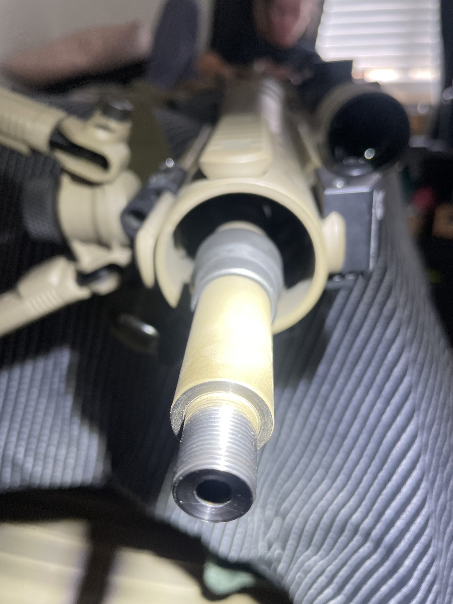

I used Sweets. The bore was mirrored after cleaning. It still shot poorly after even after fouling. I haven't had the time to get to the range to confirm if the crown work has improved anything. I used a large ball bearing and lapping compound and stepped up the grit as I went. I didn't go too crazy with it, just a lot of time a lot of spinning.
Let's see that shiny new crown.

Sorry for the late update boys. Really been scratching my head with this one. I shot the rifle after polishing the crown, still shot poorly. Maybe a little better than before but nothing to really note. I decided it was time to take it to the smith. He went over the entire rifle and was not able to find anything wrong. The crown and barrel looked great. I bought two separate boxes of match grade factory ammo and I am getting similar results as my hand loads just to rule out any of my reloading skills. The only thing I have yet to change out or test is the bolt and BCG. Not sure where to go from here really.
