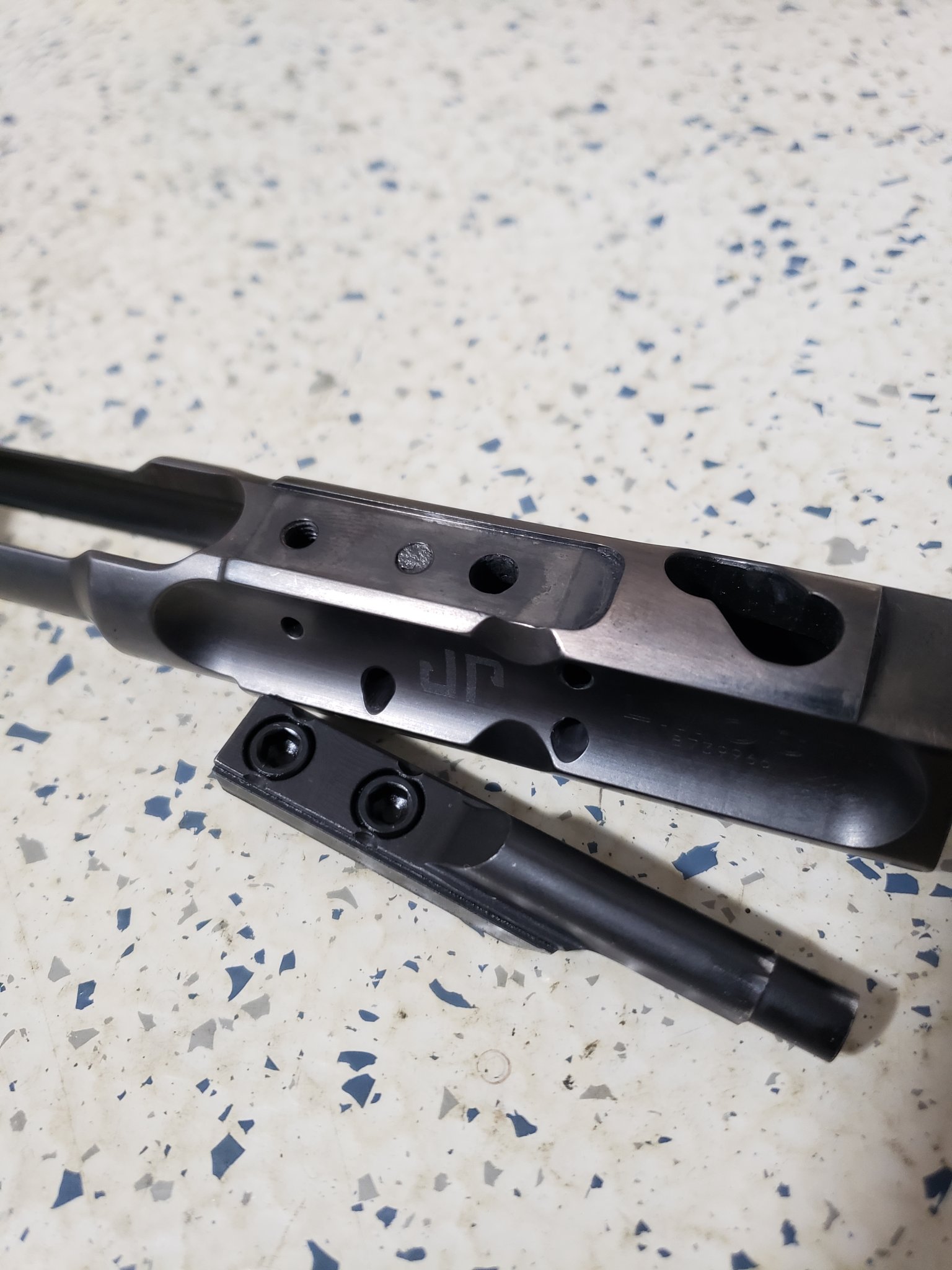

    You might be familiar with the guy here who posts under the screen name of "Padom" & who has done numerous technical & shooting reviews.............he's a living testament for RCA's BCG's.
    JP's reputation speaks for itself & their nitrided & polished stainless carriers with their DLC/PVD bolts are impeccable.
