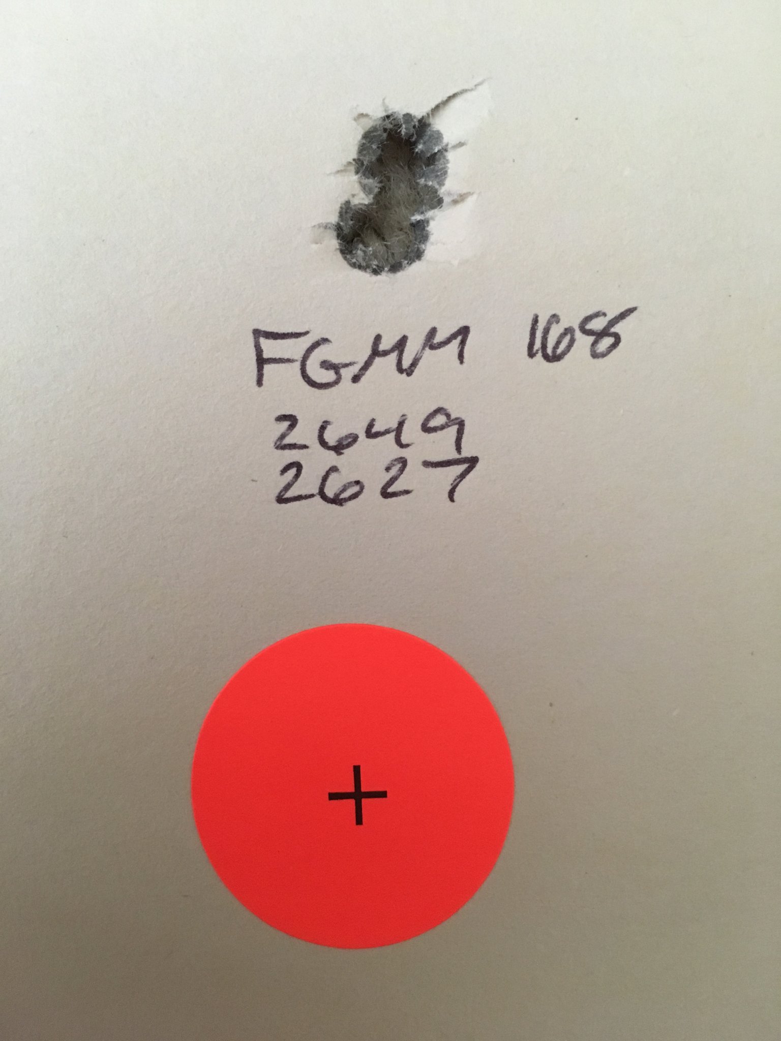

It just happens that I found a discarded 168 FGMM round in the dirt today. I just pulled it apart and found 39.9grs of a short kernel extruded powder inside.
It’s gotta be something similar to 3031.
You can easily replicate this cuz 3031 was used in FGMM factory loads back in the day.
Fyi, some info I found elsewhere. Let us know how it works out.

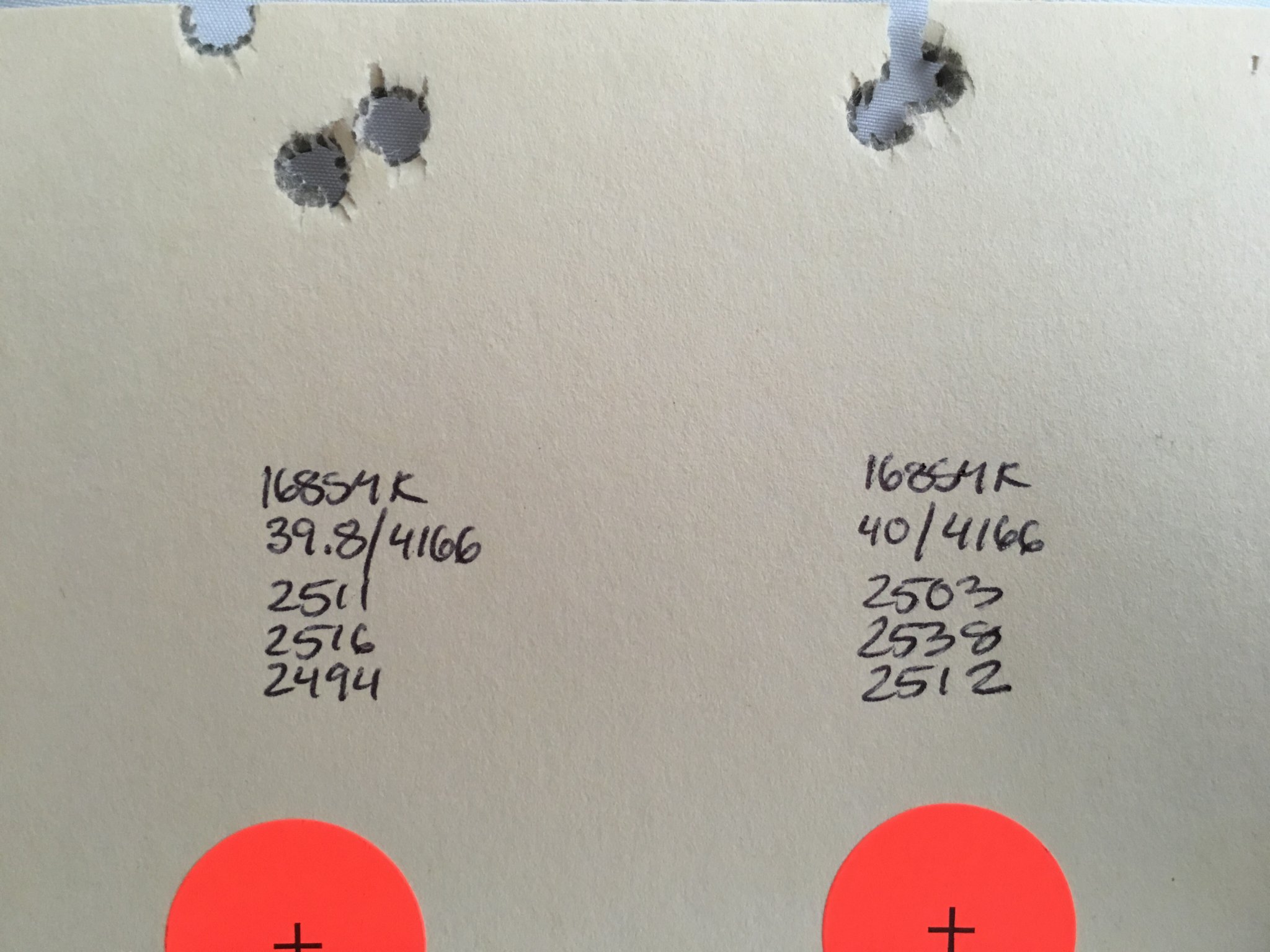

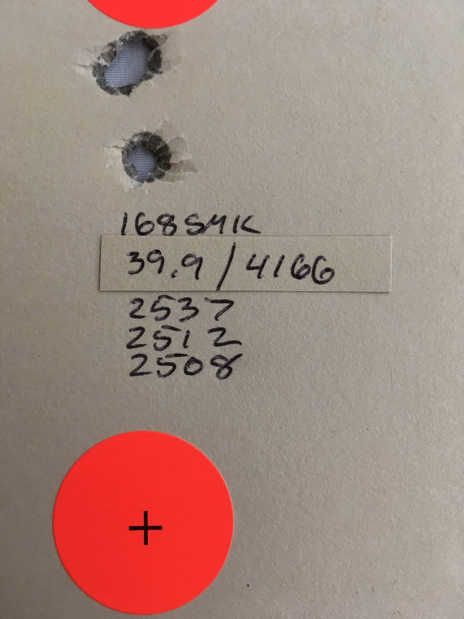

So I went digging in my ammo stash and found another one but it had 41 grains of the same powder. I reduced it to 39.9 so I could have two of the same. I also found 5 more that had 43grs of 4064. Must be older.
I compared the 39.9gr powder to AR Comp and 4166. It is definitely not 4166. It looks like AR Comp based on the kernel length and diameter. Similar bulk density as well.
I loaded 39.9grs of AR Comp and 4166 in FC cases. We’ll see.

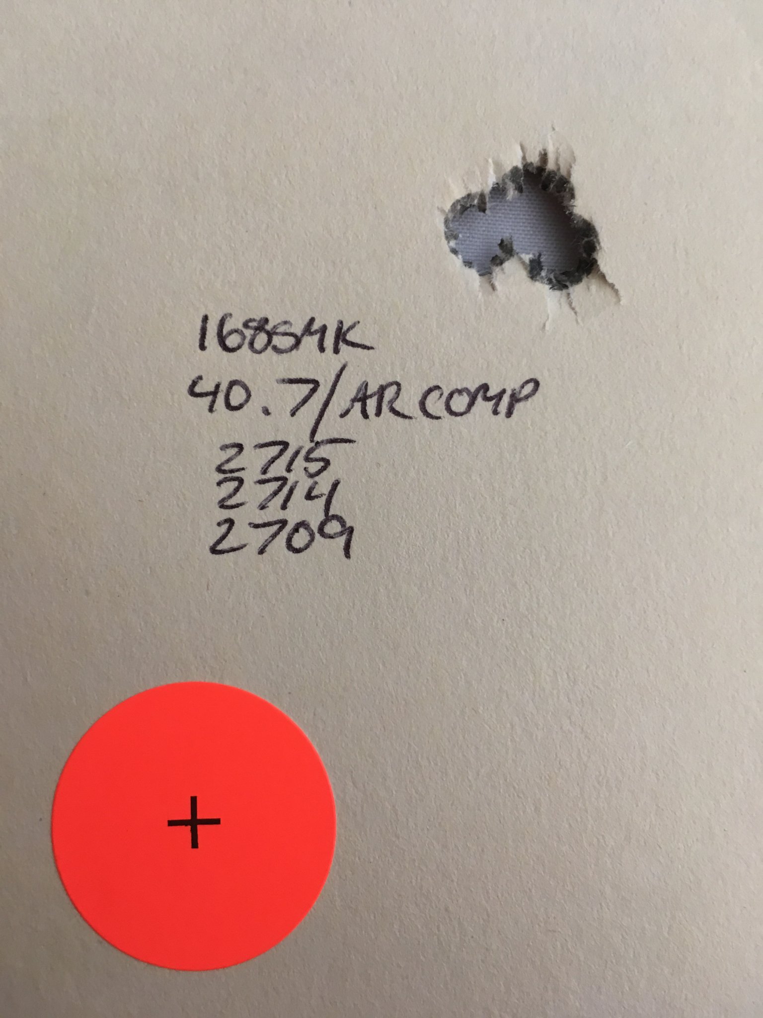

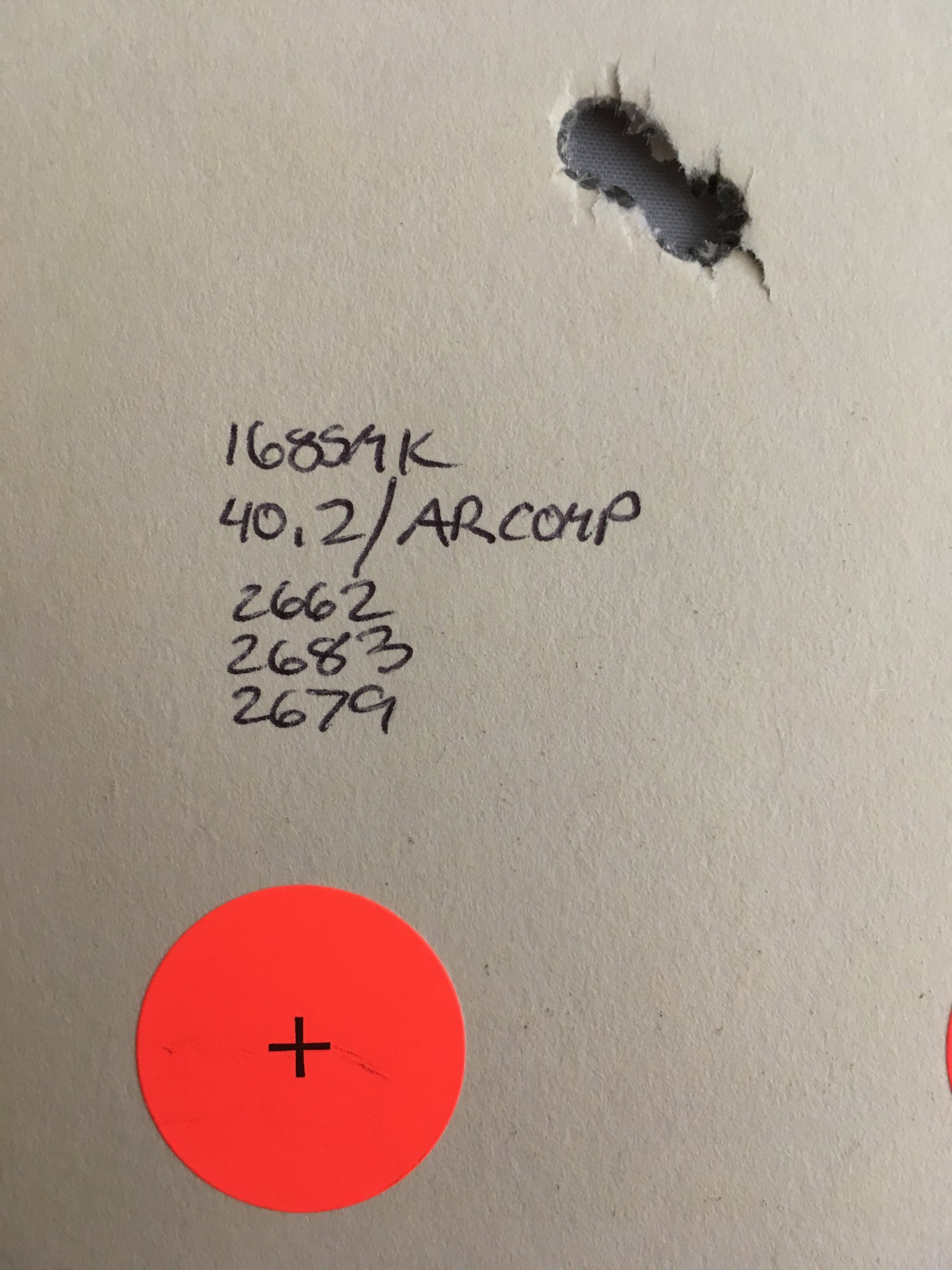

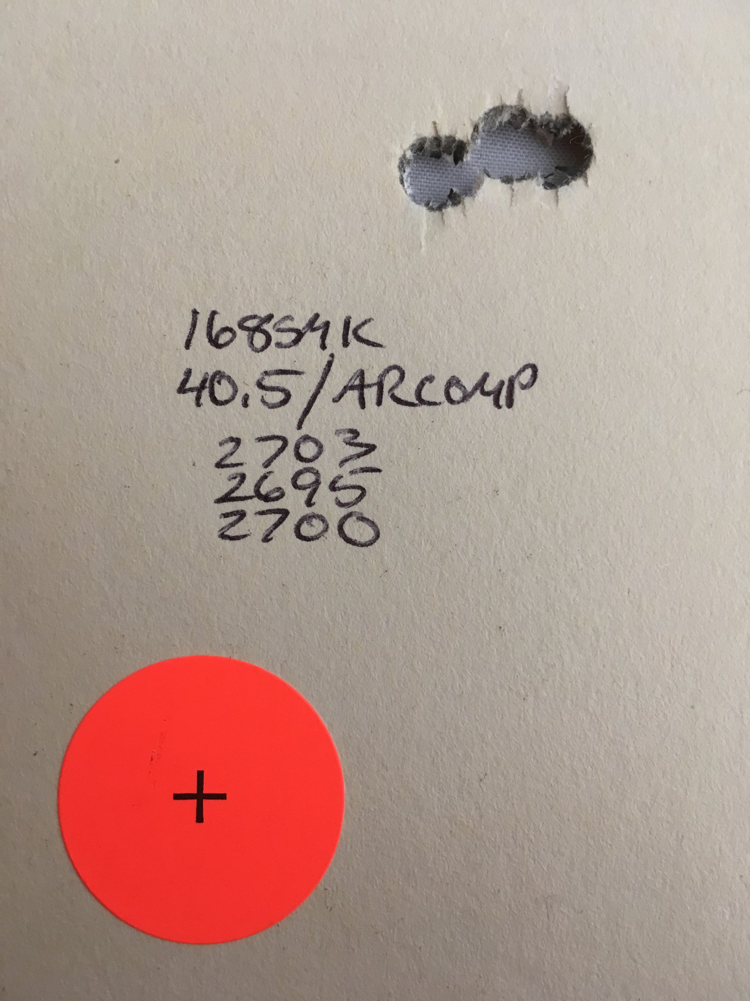

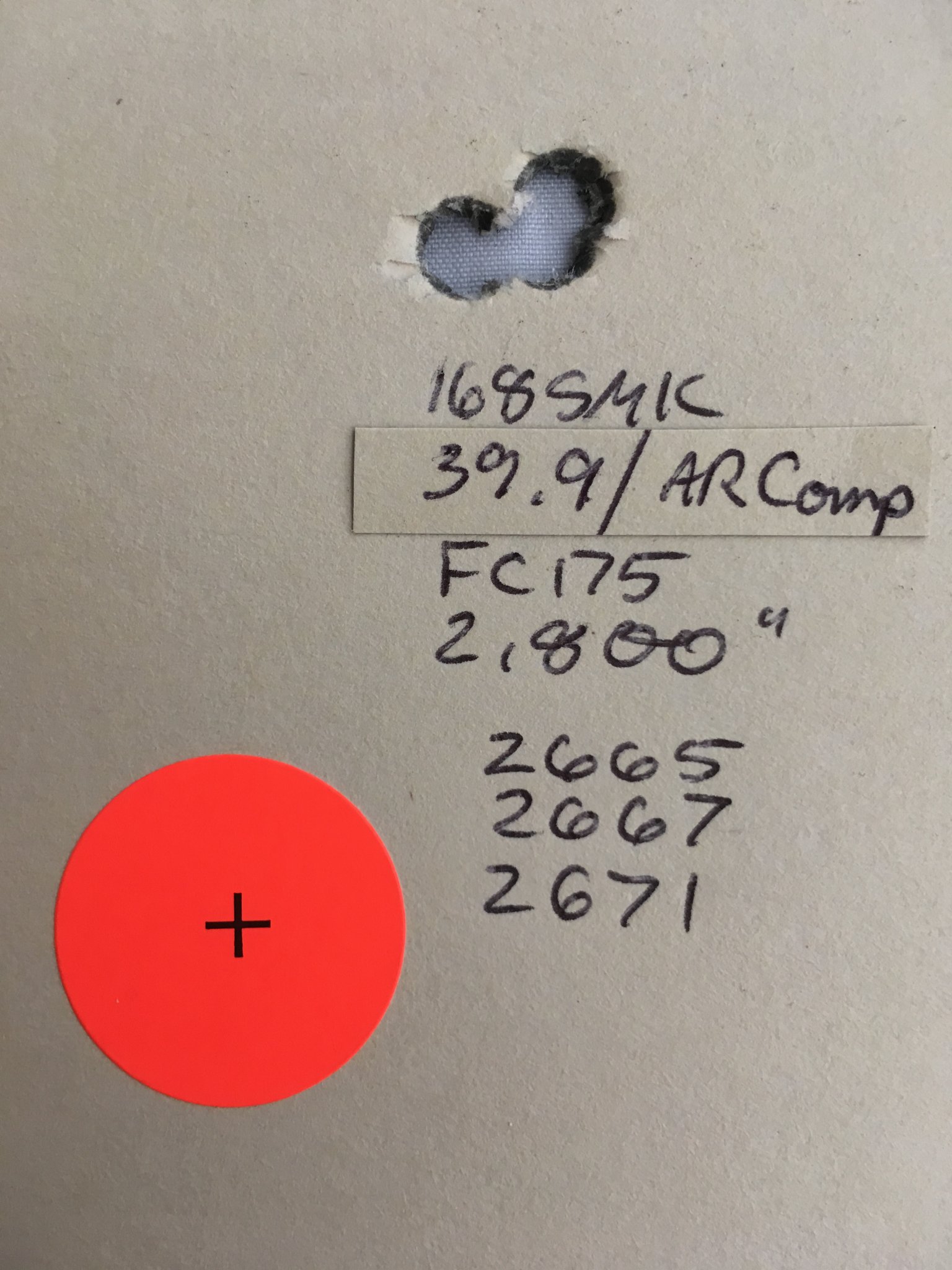

I shot AR Comp under 168’s today. And I fucked up an mislabeled my rounds so I will have to do a doover:
The other day I mislabeled the 4166 and AR Comp rounds. I thunk hard and decided to do a doover because there is no way you can have a 200 FPS spread within 1 grain of powder in the 308.
Therefore:
So it’s definitely not 4166 based on the physical appearance of the powder and the velocity.
But it could be AR Comp. Looks the same and the velocity is similar.
Sorry for the confusion.
