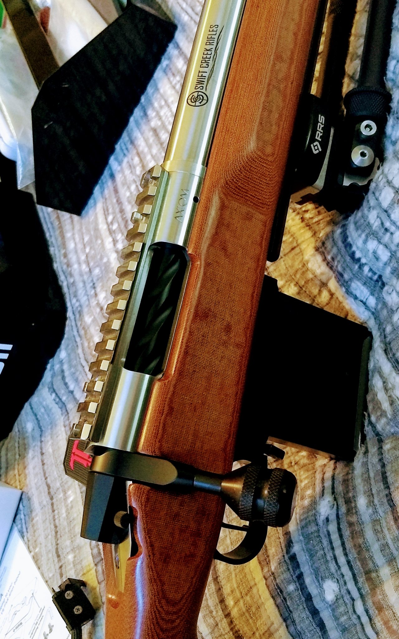

I think you're well-intentioned friend may be confusing you a bit. I have a couple Axiom and they are fantastic actions. With any action I've ever used after I fire form the brass it grows a few thou from its virgin state. With that said that virgin firing is extremely accurate if you've done load development.
There is no reason in the world you should have to fire form brass before taking a class at k&m. Or shooting a match for that matter. I highly recommend Curtis Axiom, just put together another rifle the other day.
Look into a Bugnut from Southern Precision Rifles. You can order a prefit barrel from them. They carry CC actions, so doing a prefit for the Bugnut shouldn't be a problem. I had my smith fit my 6BR to my Axiom using a Bgnut.
