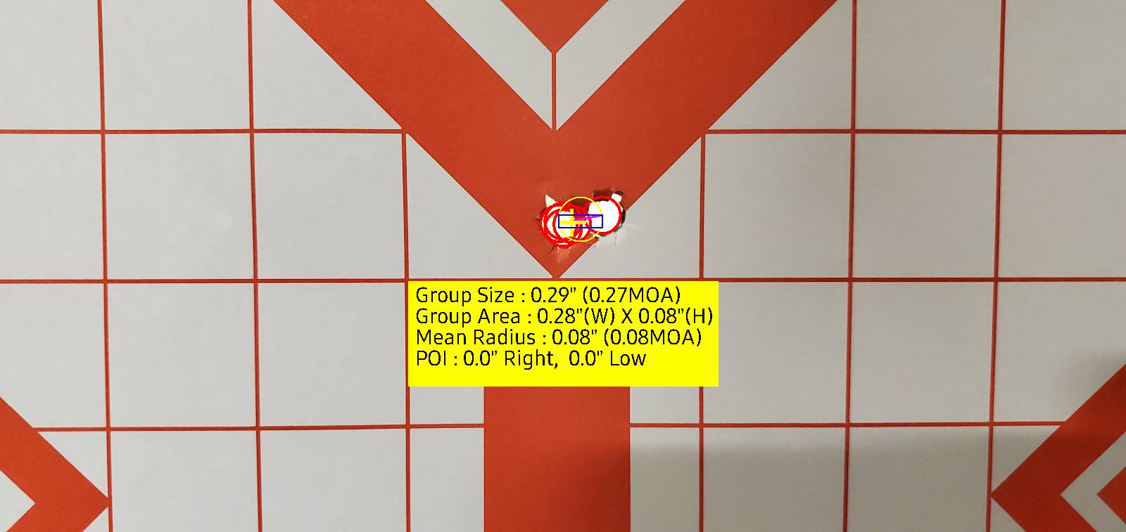

Got my Viper Barrel Vice today. Tightened the action to 90 ft/lbs and problem fixed. The no go gauge just barely stops bolt from closing. So thanks to those who said don’t worry and that the tolerance would tighten up.
Only negative I have now is the Masterpeice Arms Barrel... First off bad communication and they doubled their original outside lead time. Secondly, they installed a big (almost 1” x 4”) “MPA barrel“ sticker on the barrel that I just spent 1/2 hour removing. Put a dang sticker in the box...I’d put it with all my other stickers on my cooler. Third, I ordered a Sendero profile barrel contour, it doesn’t fit in my McMillen Stock cut for (and my rem 700 was just removed) a Sendero profile. The last thing was kind of neat but poor execution.They installed a stick-on thermometer on the barrel, which is a neat idea. However, they installed it exactly where the barrel vice had to clamp down and it crushed the thermometer, which I then had to clean off the barrel.
