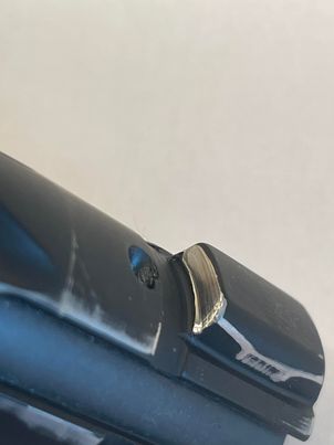

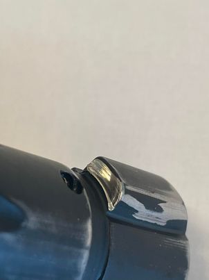

Anybody experiencing that their bolt-lugs on Curtis Custom Valor galls during cycling?
Eager to know what people have done to sort this out and to fix it?
My story below:
In 2021 I figured that I'd give the Valor a chance. Setting aside 2000+ USD to purchase the action, spare bolts and parts. The exitement was high upon arrival. Rushing of to the gunsmith with the a fresh barrel and the brand new action. I had seen som slight wear of the bolt surfaces and lugs prior to this, but somehow convinced myself that it it was supposed to be like that. (never had nitrided actions before)
Got the gun back from my gunsmith amd headed to the range for the initial test runs. During load development I'd see all kinds of weird pressure signs, even though I was on the lower end wrt charge weights.
During this process I inspected the bolt lugs to be heavily galled. Compared with my inital headspace to current one had increased by 0.005 in.
Back to the gunsmith to redo the headspace. Same story, headspace constantly increasing due to the bolt lugs galling severly.
In total I've been back and fort to the gunsmith
three times in just a little over 600 rounds.
Headspace have increased a total 0.011.
Attaching a few photos of how my bolt look like today. Also note that it startet galling prior to having fired any rounds. (de-greased)
I know of a few others that faced the same kind of issues.
Just speculation from my side now, but I do suspect that the action and the bolt material hardnesses are way of eachother, whereas the bolt is simply to soft. Lapping will not fix it.
Could also very well be a machining-issue as parts of the receiver body to have very sharp edges, particulary the receiver bearing surfaces.
I'd have to give Credit to Curtis wanting to fix this. I am however very concerned about the long-term quality for PRS-Use.
Eager to know your thougts.

You can gall the bolt of any MFG, lack of lube, dirt and not enough case clearance can cause galling.
Yes any action can gall with the right conditions for sure. I'd be well into a very deep dive with Curtis and be figuring this out waaaay before I'd be changing the head space on multiple barrels , if I am getting this right. This seems pretty odd honestly but it needs to be figured out, not just taking off some on the barrel

Started of seiing strange wear on the main one bolt lugs prior to even firing it. Somehow convinced myself that it had to be normal wear. Put it into use and got pressure signs that shouldnt be expected (min load approx). After 200 rounds (approx) of load dev and barrel break-in i started seeing major wear of the lugs. Measured headspace at that time and it had increased by 0.005. Sent the gun over to my gunsmith to do a rechamber. Got it back and the headspace was within spec of Dasher +0015. Fired additional 400 and headspace had increased again, by 0.005.
The two other bolts I have are facing the exact same initial wear of the lugs. I do not have exact measurements of theese, and probably never will as I wont spent money and components on this anymore without knowing what is wrong and what can be done to resolve it.

Curious about this, not a machinist or a metals professional, only looking to increase my knowledge. Are you sure this is galling or lug set back on the bolt? I understood galling to be metal transfer between 2 surfaces, for various reasons? Either way, sorry to hear about this. Hope you can recoup something in the end.
Galling in its conventional way is probably the wrong term yes. Either way, material is being removed from the lugs by the action.
