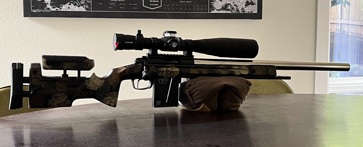

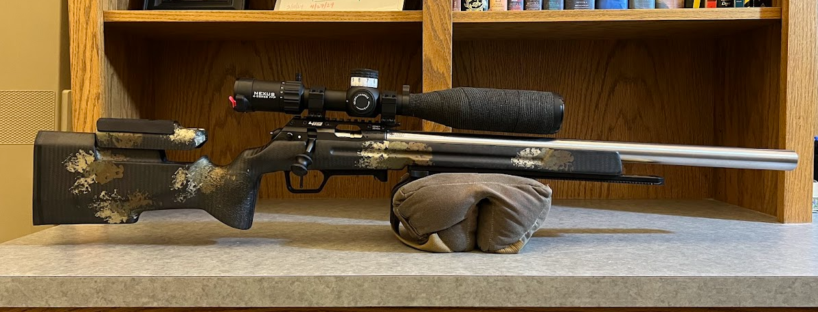

I totally respect that and did the same thing when I went for a Vudoo. However, if you don't "want" to spend quite as much on another setup, you can have very similar if not the same performance results from a less expensive rig. That being said, it really depends on the feel and features you want out of your rimfire setup. I wanted something I could have a near 1 for 1 replica of a centerfire rig to keep things consistent.
I have recently built a CZ 457 with my brother though that (at this point) feels damn near as good and cost half as much. I still prefer my Vudoo, but it is worth noting if that's something you care about at all.
CZ
Vudoo

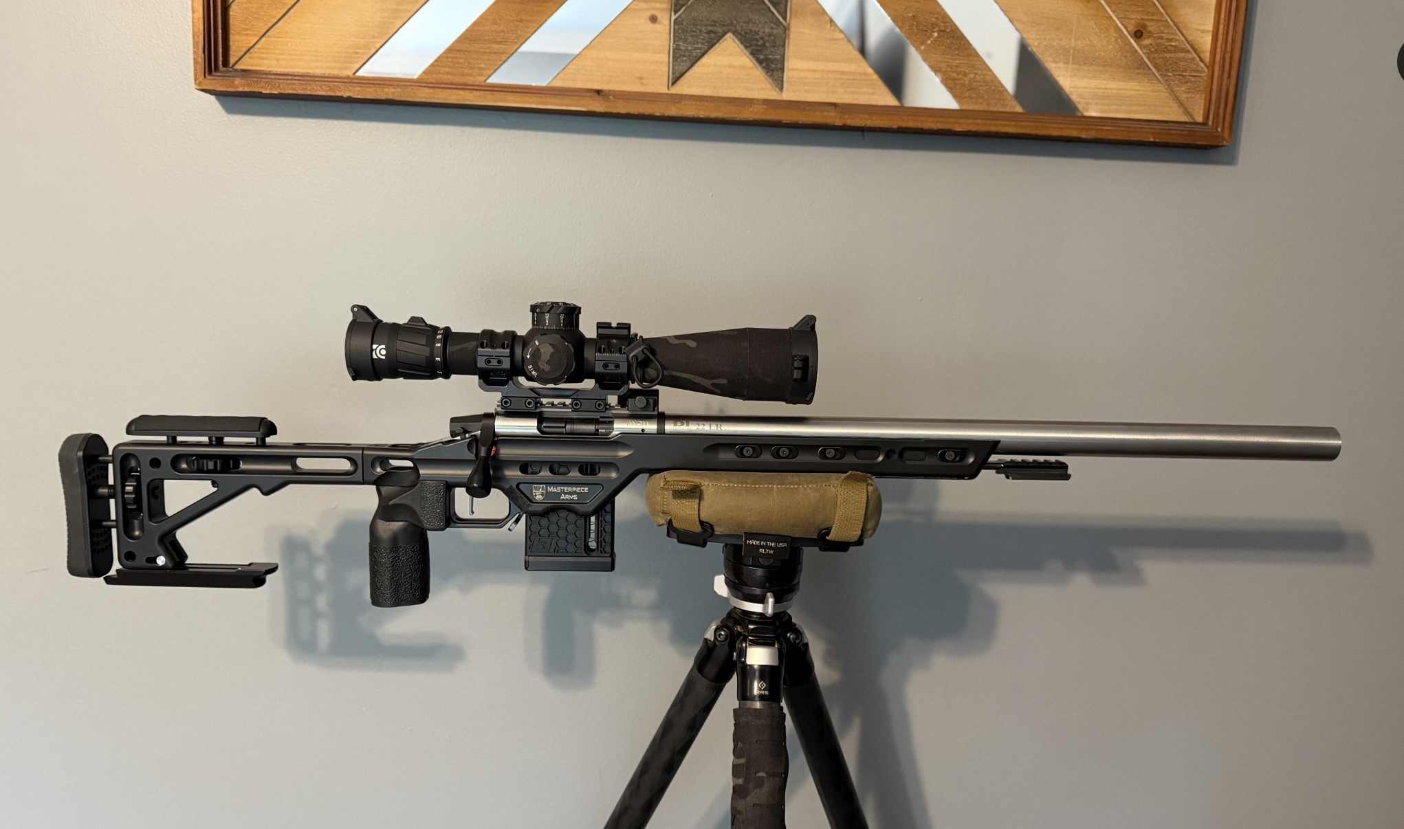

Good to know. I ended up not listening to most people in here and got an axiom on their Black Friday sale 😬. I did get a couple of the l3i adjustable mags also, and snagged a manners TCS from the classifieds to drop it in. It’s currently with @David Lott getting that premium barrel but I can’t wait to shoot it
