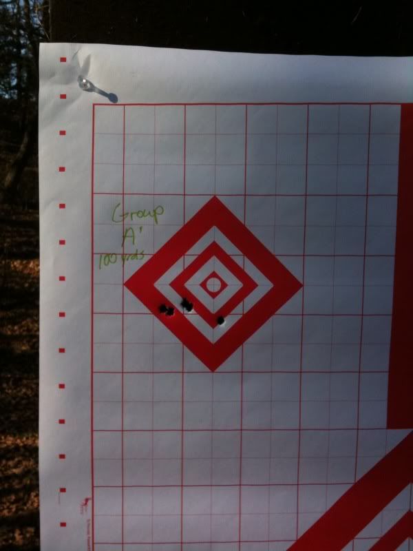

Chad at Custom Realoads of Dallas made me a load for my .260 and this is the group i shot with it .236 inch.he is by far the guy to custom make you some ammo!!!!!

If bullet diam. is .264", and the space between the 2 shot and the flyer 3rd, How do you get a .236" group? 2 shots barely touching would be .264? Please correct me if wrong.
