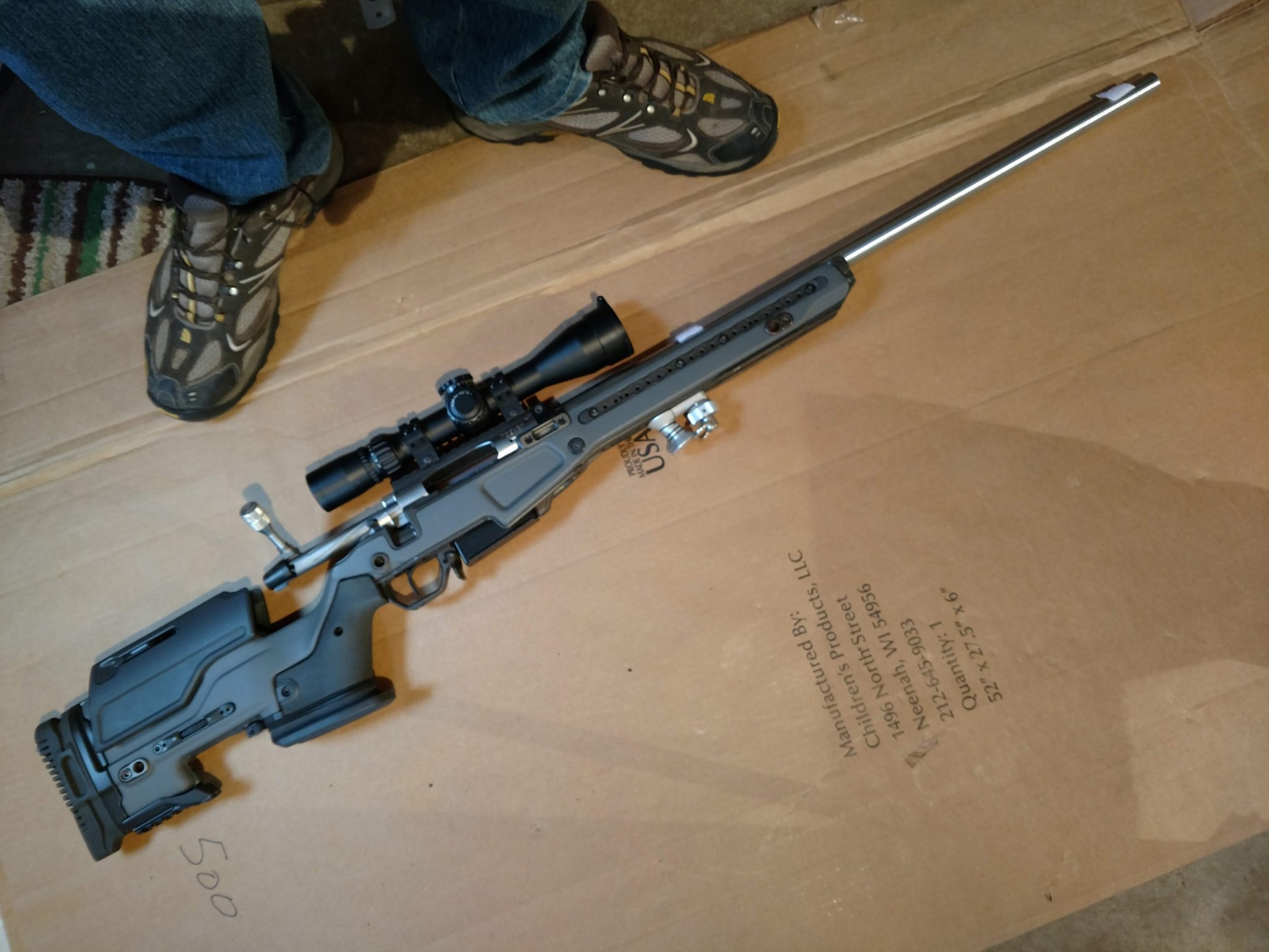

I did a similar build as what you're looking for...
Bighorn TL3
JAE-700 stock
American Rifle Company Barloc ( NON-shouldered type)
Savage Pre-fit barrels - each with it's own Barloc nut
Go/No-Go gauges for each caliber (some folks use fired brass - I like to check with actual gauge)
.223 and .308 bolt heads
<<<< edited to add: I'm presently using a Timney Calvin Elite two stage trigger - it fits with no issue and it's a great trigger >>>>
The scope rail on the Bighorn required some modification to accommodate the ARC BarLoc. The nice thing about the BarLoc is that all I needed to swap barrels was a small torque stick. In order to be able to leave the Barloc nut on the barrel I removed a couple thousandths from the JAE-700 just in front of the barrel nut - not much more than removing the anodization.
I have three barrels that I use the most:
- .308 Win - savage factory barrel purchased used on this forum - typical groups are under 0.5moa with known loads - no specific load development for this barrel.
- .223 Rem - savage factory barrel, 1-9 twist, 26in, shoots around 0.5moa with known loads for my AR-15 service rifle (80gr Noslers loaded long) - no specific load development for this barrel.
- 6mm Competition Match - 28in Medium Palma Krieger with 1-7 twist. set up as a savage pre-fit by gunsmith Dave Bruno.
When I swap barrels I hand tighten the barrel down onto the GO-Gauge, then tighten the Barloc nut, then torque the BarLoc to the required value. Double check using the NO-GO gauge and get ready to shoot. Once I became confident in the barrels and the process I decided to keep the Barloc nuts in place, so I repeated the above process, but I added blue loc-tite to the threads under the barloc. When everything was tightened/torqued/checked the nut, now lightly glued to the barrel essentially created a shouldered barrel - but with two benefits.
1. I could still use just hand tools and change barrels at the range, without a barrel vise/action wrench/large torque wrench.
2. I could use cheap/used savage take off barrels for practice time and keep my 6mm Comp Match barrel for matches.
Please keep in mind that with this setup I can do barrel swaps with the scope on, still in the stock, with just a small light hand tool a gauge that easily fits in my range bag. Check out the For Sale area, there are always a lot of Savage Pre-fits for sale.
Feel Free to PM me if you have more questions.
Regards,
Ross

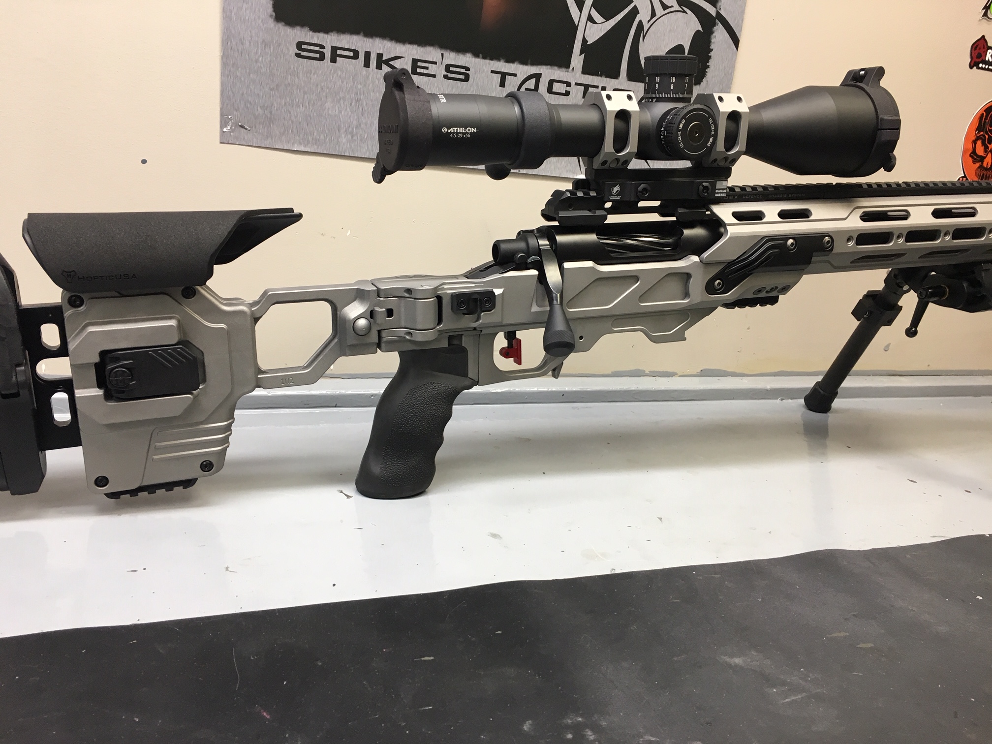

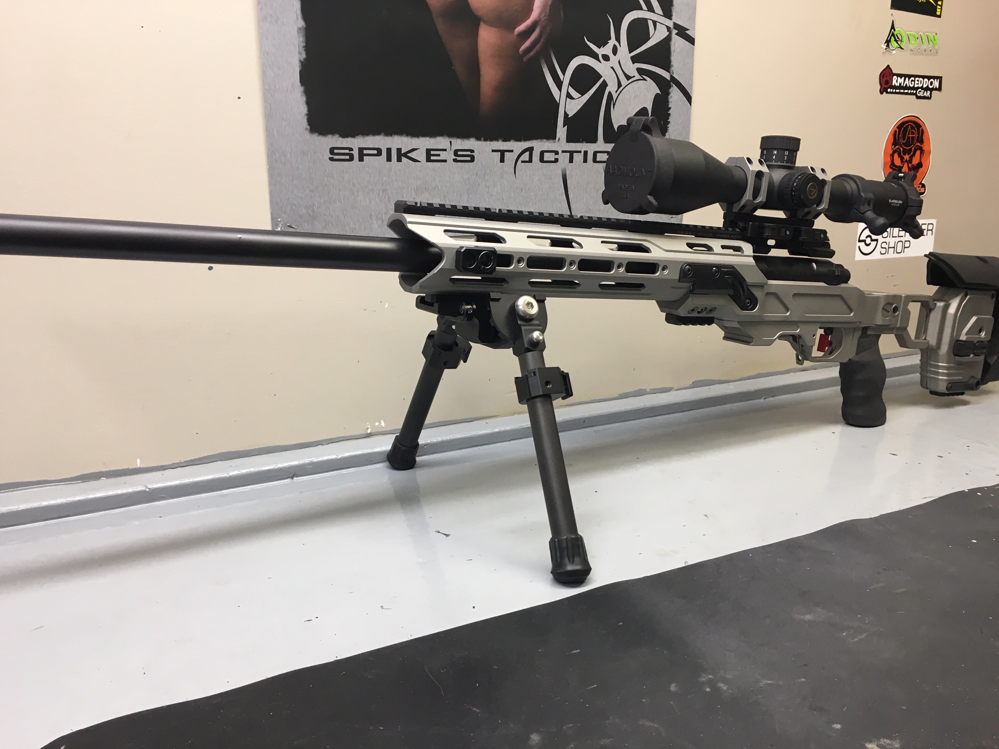

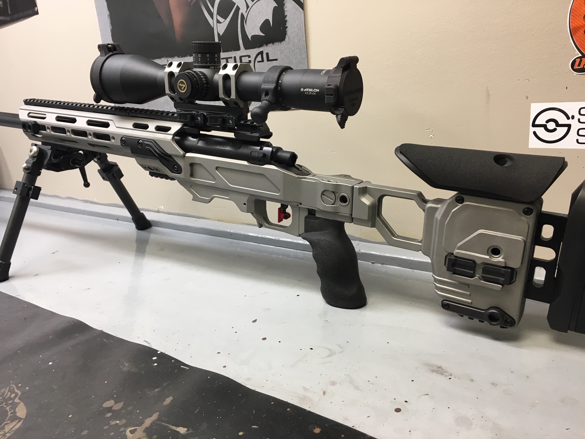

I build a lot of Remages on nice actions like Stiller TAC 30's. There are some really nice Remage prefits out there like Criterion, McGowen and Shilen that are sub MOA shooters. A nice PTG barrel nut and a go gauge and your good to go with whatever caliber you choose. If for some reason you can't stand the barrel nut then by all means buy the more expensive shouldered barrels but they won't shoot any better. I mostly build chassis rifles so the barrel nut is buried anyway. Here is my newest Remage in a Cadex Dual Strike.
Reactions: Maxim0
