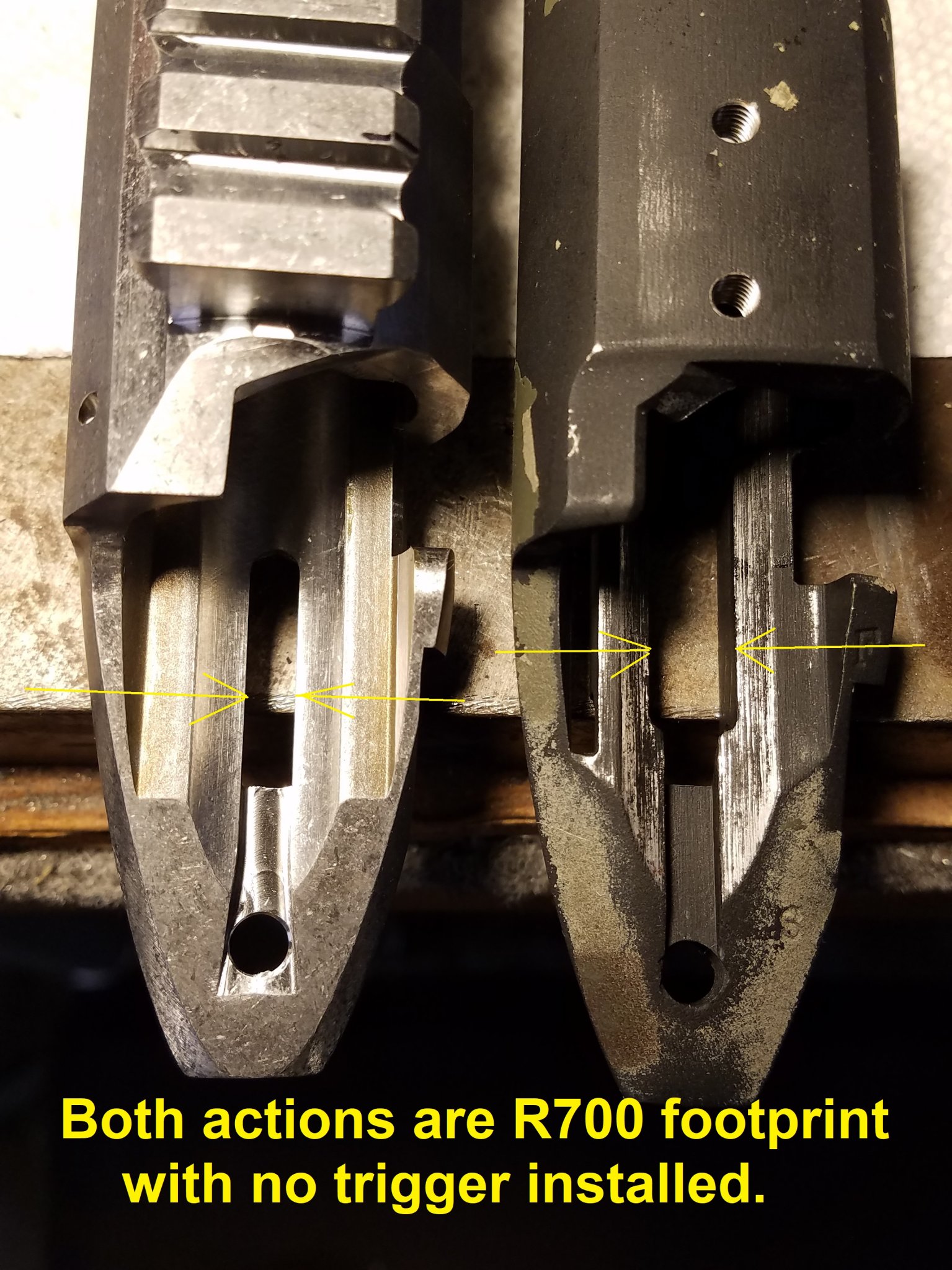

    Presence of a trigger can have a large bearing on bolt lift on some actions.
    The bottom of the cocking piece is usually controlled on the long axis by the trigger housing.
    Bottom lug of the cocking piece extends downward into the trigger housing slightly so the trigger limits the rotation of the firing pin assembly so the cocking cam can do its job when the bolt is lifted to "cock" the striker into the rearward position.
    Without a trigger in place, the bottom flats of the bolt shroud contacting the flats on the bottom/rear of the bolt raceways are the only thing keeping the rear of the bolt from rotating while the rest of the bolt rotates and that is very sloppy compared to the proper rotational control that the trigger housing provides on an assembled rifle.
    So some actions have a trigger sear access cut that is the same width as the inside of the trigger housing. These typically mimic the same bolt lift with and without a trigger installed.
    Other actions have a trigger sear access cut that is considerably wider than the inside of the trigger housing. These will bind the fuck out of the cocking piece when it starts to cam back with no trigger support and exhibit a very stiff bolt lift.
    edit-pretty much what Terry said ^^^^^

    Edit: NVM. There is this thing called oil and lube. Does wonders. Also TY to @Terry Cross for your pictures and explanation above about how the cocking works in the action. Removed the trigger--still had problem. Apparently my bolt was raw dawgging it. That's why its my "experimental" gun--if I screw it up, I wont beat myself up.
