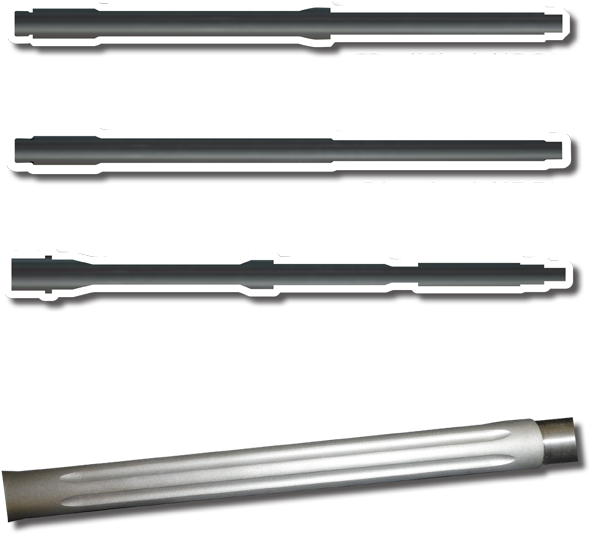

That said here are the specs I want. Please try to poke holes in my theoretical barrel layout because after all it is a 2.5 month long wait and this is my first custom barrel.
The whole purpose and intent behind this rifle build is purely for target shooting and some of it (or a lot of it) at longer ranges. My longest spot available at the moment is 1,400 yards but I can't rule out finding more real estate in the future. Rarely will hunting be involved. Also I want the option to shoot heavier for caliber bullets like the 115 DTAC or even some 109 and 110 grain bullets or whatever else might come to market in the future. Berger and Sierra both recommend a 1:7 twist for their heavier bullets (so that explains that choice).
I will shoot suppressed almost 100% of the time.
  • 416R
  • Either 22" or 24". I am leaning towards a 22" but 24" is not off the table. Now that it's a realistic option I am wondering the downsides to either/or.
  • Modified Hbar profile. He said in 22-24" lengths the 'modified' vs the traditional Hbar is about 1/2 pound lighter and in this caliber it won't make that big of a difference profile wise because it's not some bigger magnum type caliber with excessive recoil.
  • Either a rifle or rifle +1 gas system. I will use an adjustable gas block. He said the +1 would make the gun have a little less recoil but I am not sure 'how much less' that really means. Maybe someone here can quantify it for me.
  • .750 gas block. This is because I do not want any clearance issues fitting it under my handguard (which I already have).
  • 11 degree crown with 5/8x24 threads
  • Matte finish
  • 6 straight flutes. This isn't mandatory but I am thinking it could bring the weight down even a little bit more without giving up too much stiffness. Again if I was shooting a huge magnum caliber I would probably pick a different profile. I am however not so sure about the flutes on the given profile I am talking about. Flutes are not mandatory but I am definitely open to it if it will play nice with the profile.
  • 1:7 twist as mentioned above.
Please add thoughts, ideas, comments, questions, or anything else you would like. I am curious to try and run this through the feedback machine.
Edit: the lower I have and will be using for this has a H1 buffer in it. I am not sure if that will make any difference. I prefer not to switch it out but if I do need to I will.

I have more questions. This time in a general sense.
If I go with the modified HBAR (the very top one) vs the regular HBAR (2nd one) in a 24" length would this have any noticeable difference in the real world? I am specifically talking about rifle length gas then stepping down to .750 for the gas block and forward.
I cross referenced and X Caliber offers something similar in a 24" barrel as one of their standard options so I know it will work, but I am wondering what the real world could show as far as results go.
If I was shooting a 300 RUM or something else with huge recoil I can see bigger being better but I am just walking through my options before putting my cash up. (First time buyer so I am naturally over thinking it)
The whole contour thing makes sense when you go rediculously small (IE pencil barrel etc) but on the bigger barrels I am not certain what to make of them all.
Shouldn't be any measurable performance difference. MAYBE if you like to do mag dumps right before you shoot groups. Other than that it's just extra weight.
Reactions: alamo5000
Those are the profiles available from mcgowan. I'm still over thinking what's already out there. I would go crazy if I tried to spec out every bit of it.
Based on your response I think the modified is fine. I don't plan on any mag dumps at all. This is purely for leisurely shooting at far targets.
I tried a friend's heavy barrel upper once and I can recall hating that thing. It was a beast so I want to get enough weight but not something nuts. Trying to find that sweet spot.
On other rifle builds in the future I might do something completely different but for this I don't want an insanely heavy barrel. Enough to get the job done and that's it. I might shoot a couple hundred rounds in an afternoon maybe but that would be on the high side of things.
It's more of a plinker than a blaster.

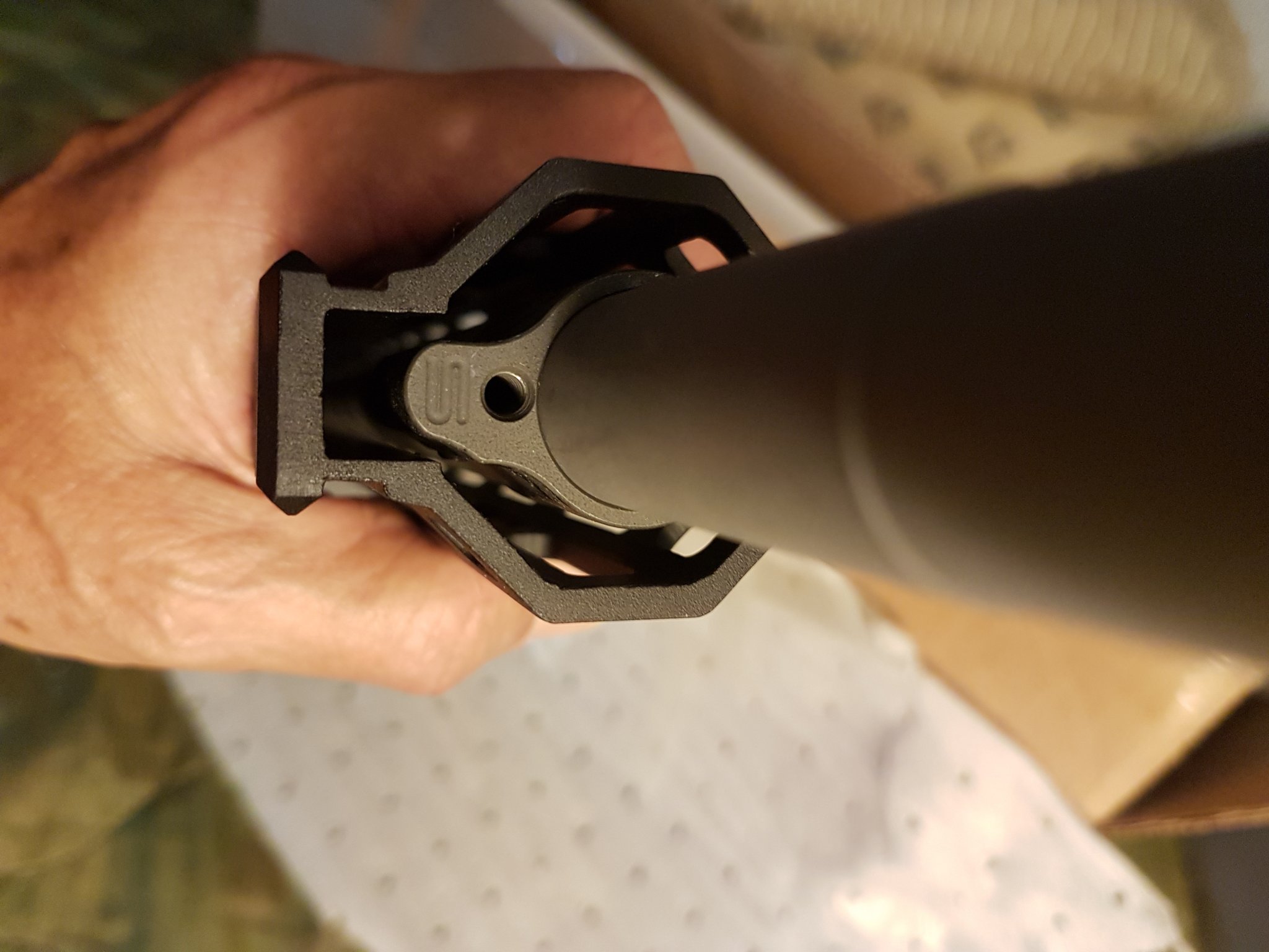

I ordered an SLR adjustable gas block and gas tube as well.

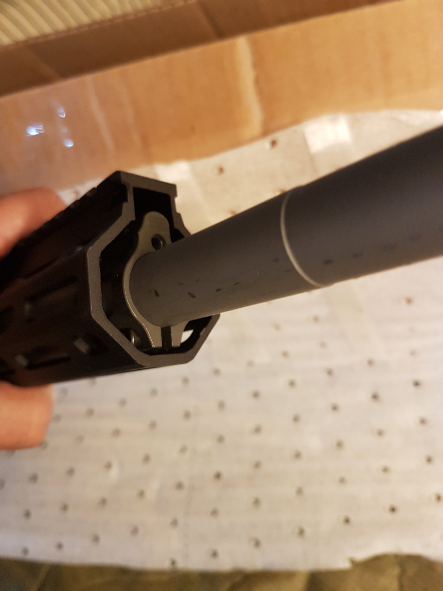

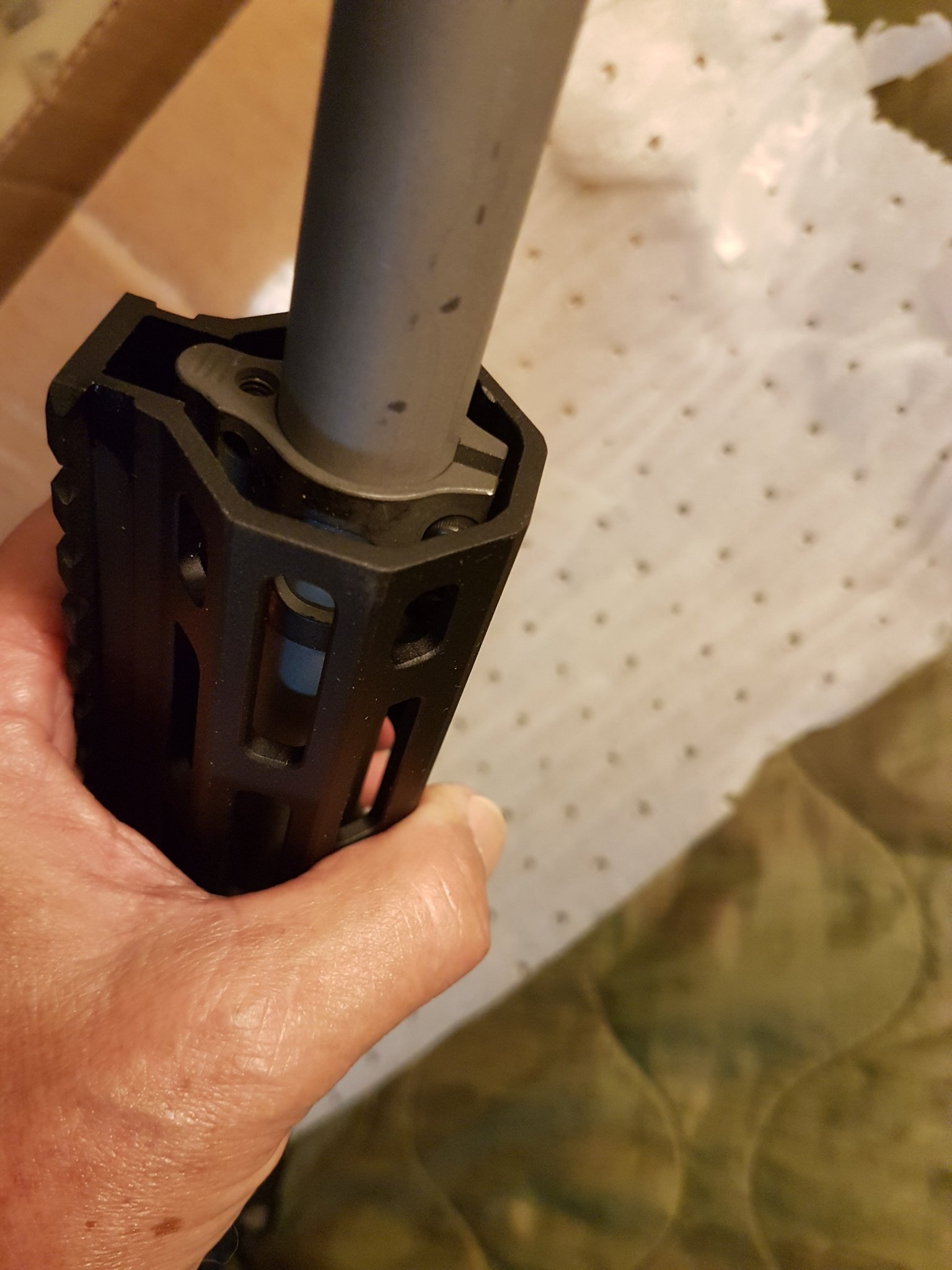

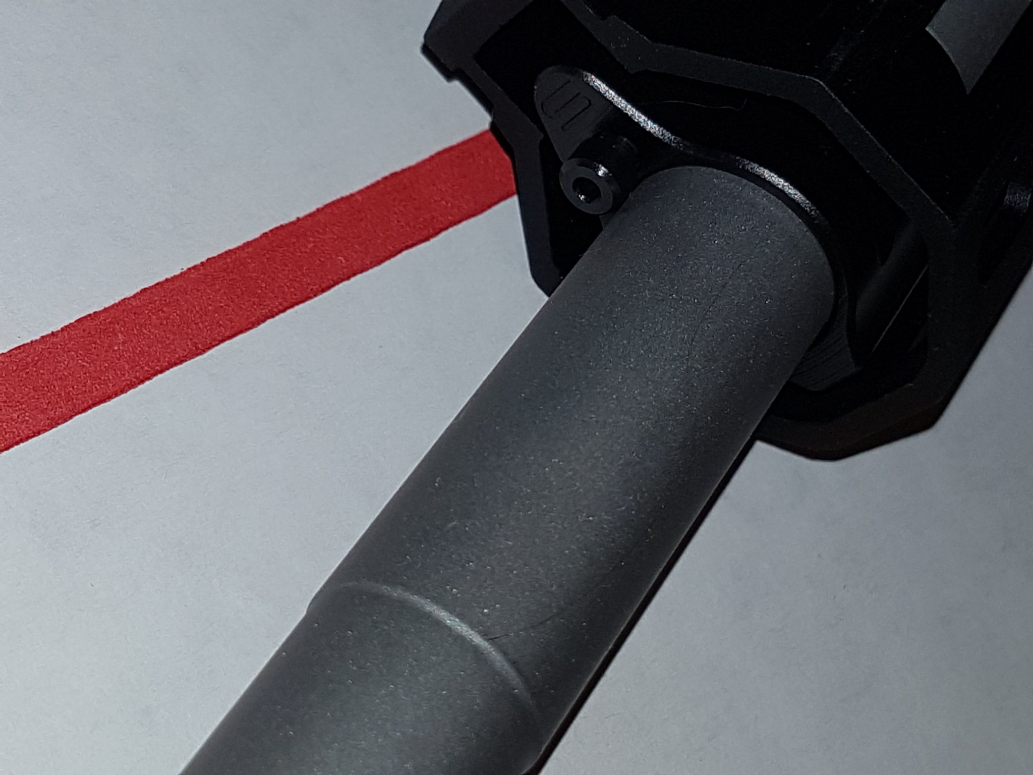

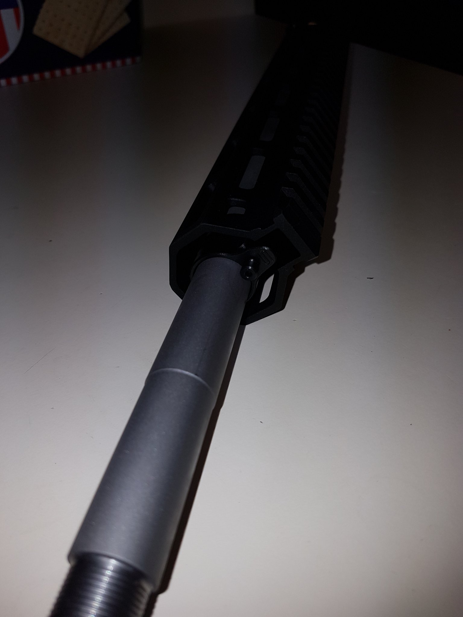

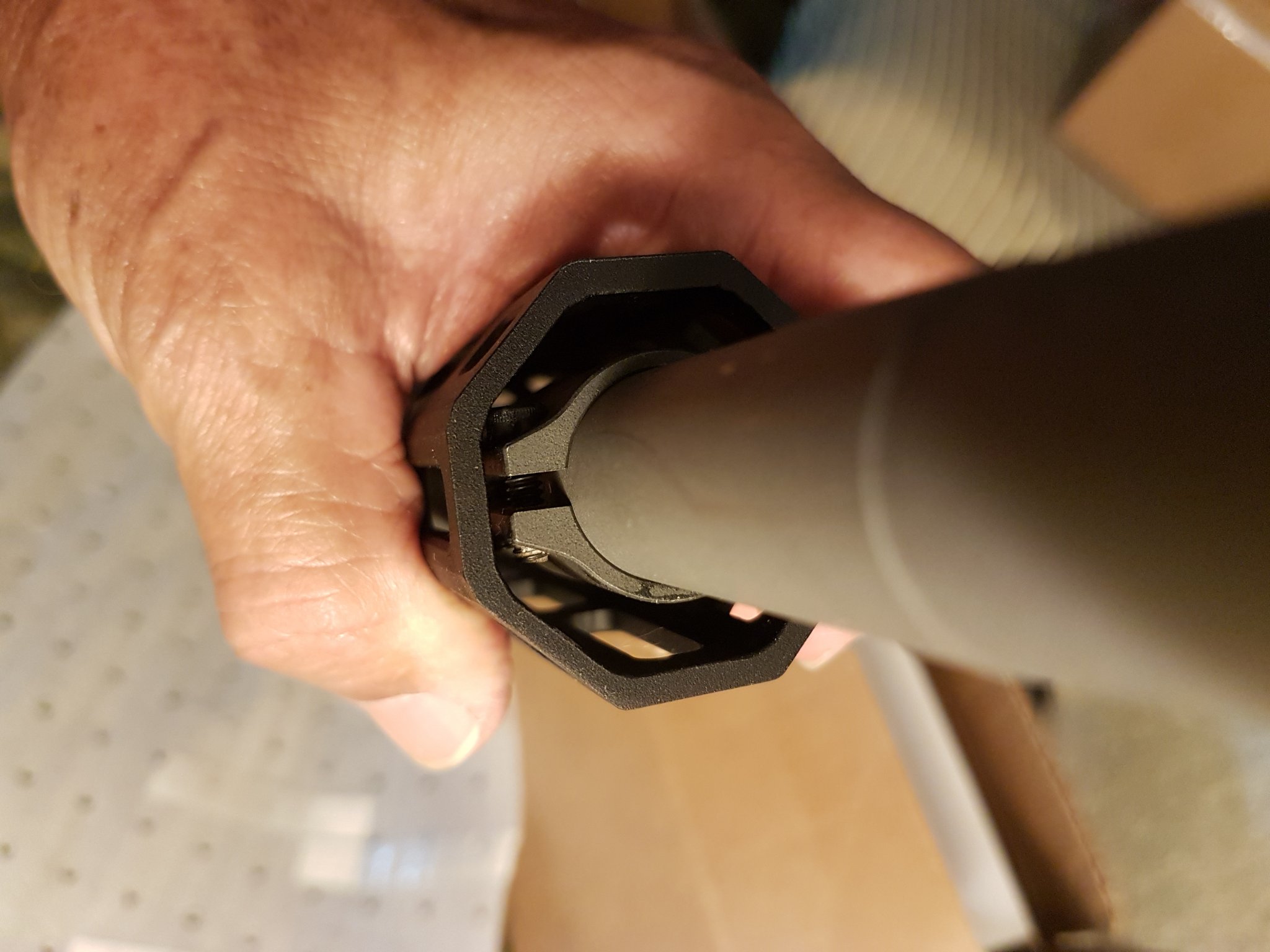

...here's some pics I have of the SLR Sentry 7 series gas blocks on a BA 18" barrel (rifle gas) using the 13.7" CMT UPHR Mod2 handguard. The clamp on version is the previous gen model and the set screw one is the current gen model. YMMV

I'm a fan of SLR. I have three rifles all cross machine tool and SLR hybrid with some CMC sprinkled on top. So far everything has SLR blocks under SLR rails.
The CMT rail definitely has enough space under there for the .750 block. The .875 would cut it close but still might fit.
