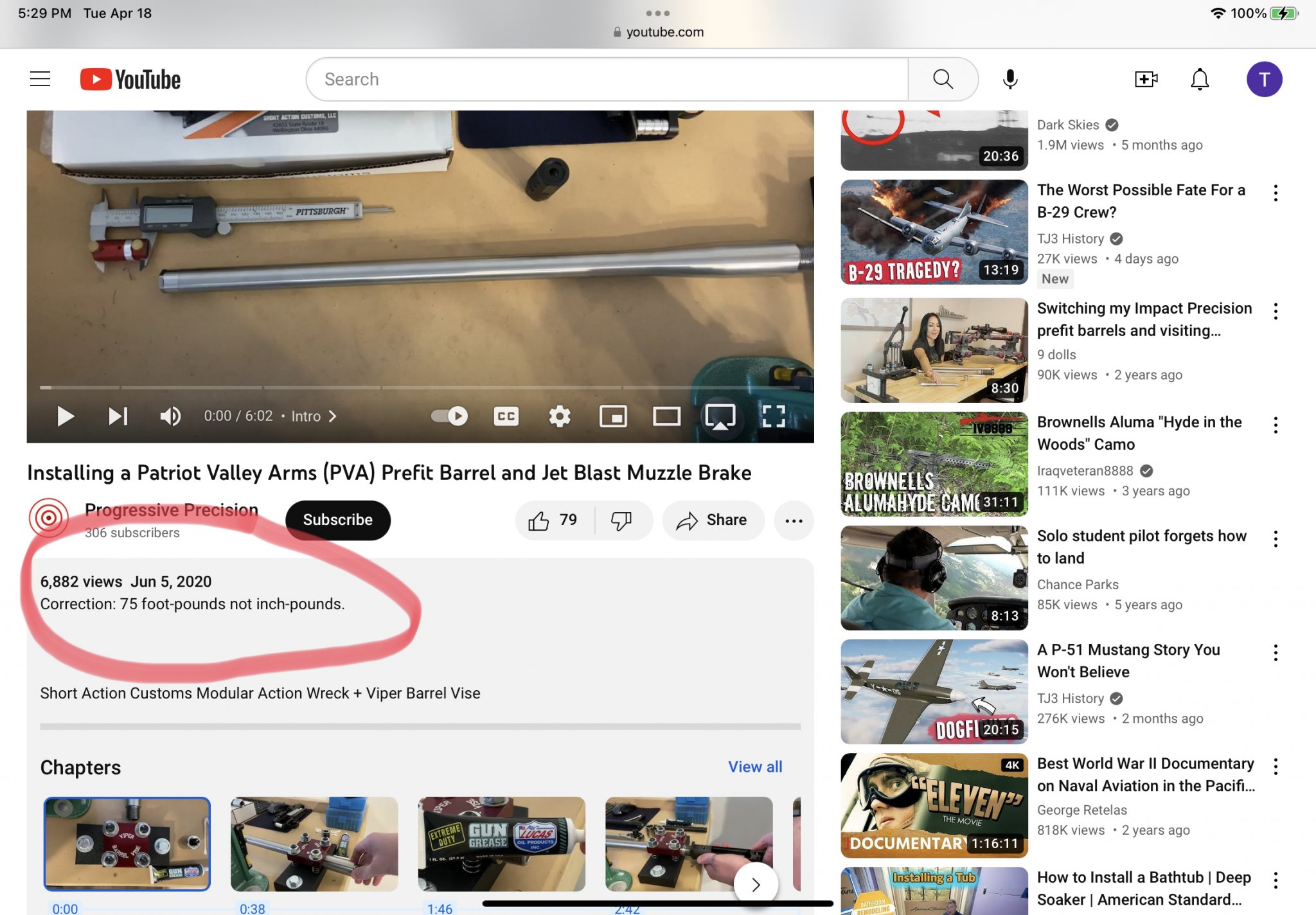

I think he said 75 inch pounds. Should be foot pounds but a good video giving the OP an idea of how easy it is to do. I would recommend an Origin also as it's an excellent action for $900 and you can easily change the bolt face for multiple calibers. I would however recommend a PVA Osprey barrel as they are very accurate, clean up easy, you can get some different calibers and freebores and different contours. Josh @bohem is on the site and can answer questions.
Yes, he did make that mistake. It’s foot pounds. If you watch it on YouTube, he made a correction in the comments. Good catch!
